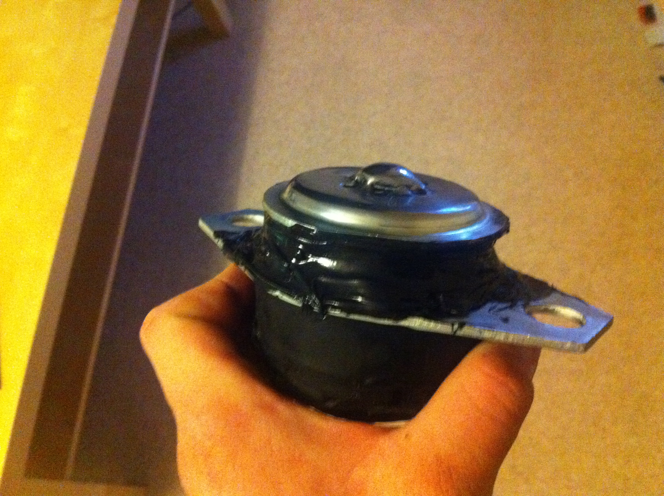

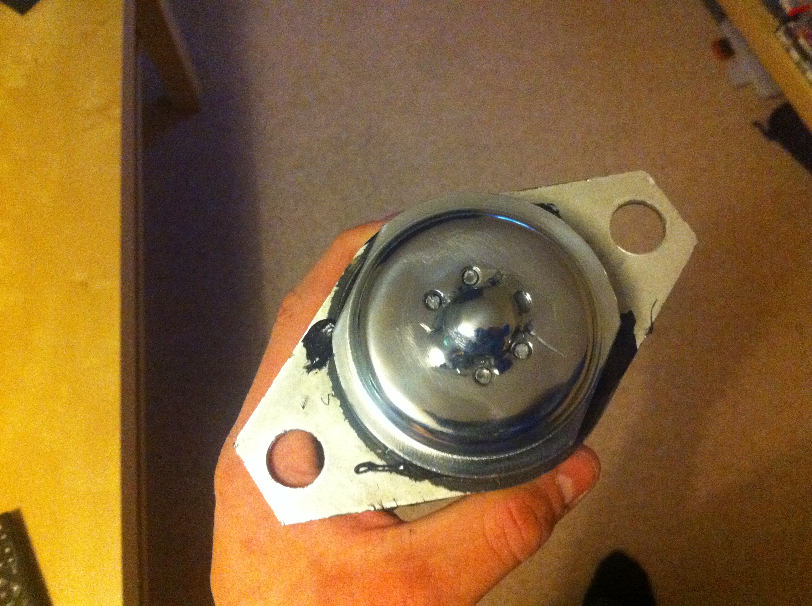

Started to finish off my custom mounts for the XE...
The rear one as all of you have seen before, a standard sie mount, which has been modified...
It started off as a new donated one from Todger (cheers big ears)... And had the usual loose top thats broke away from the alloy...

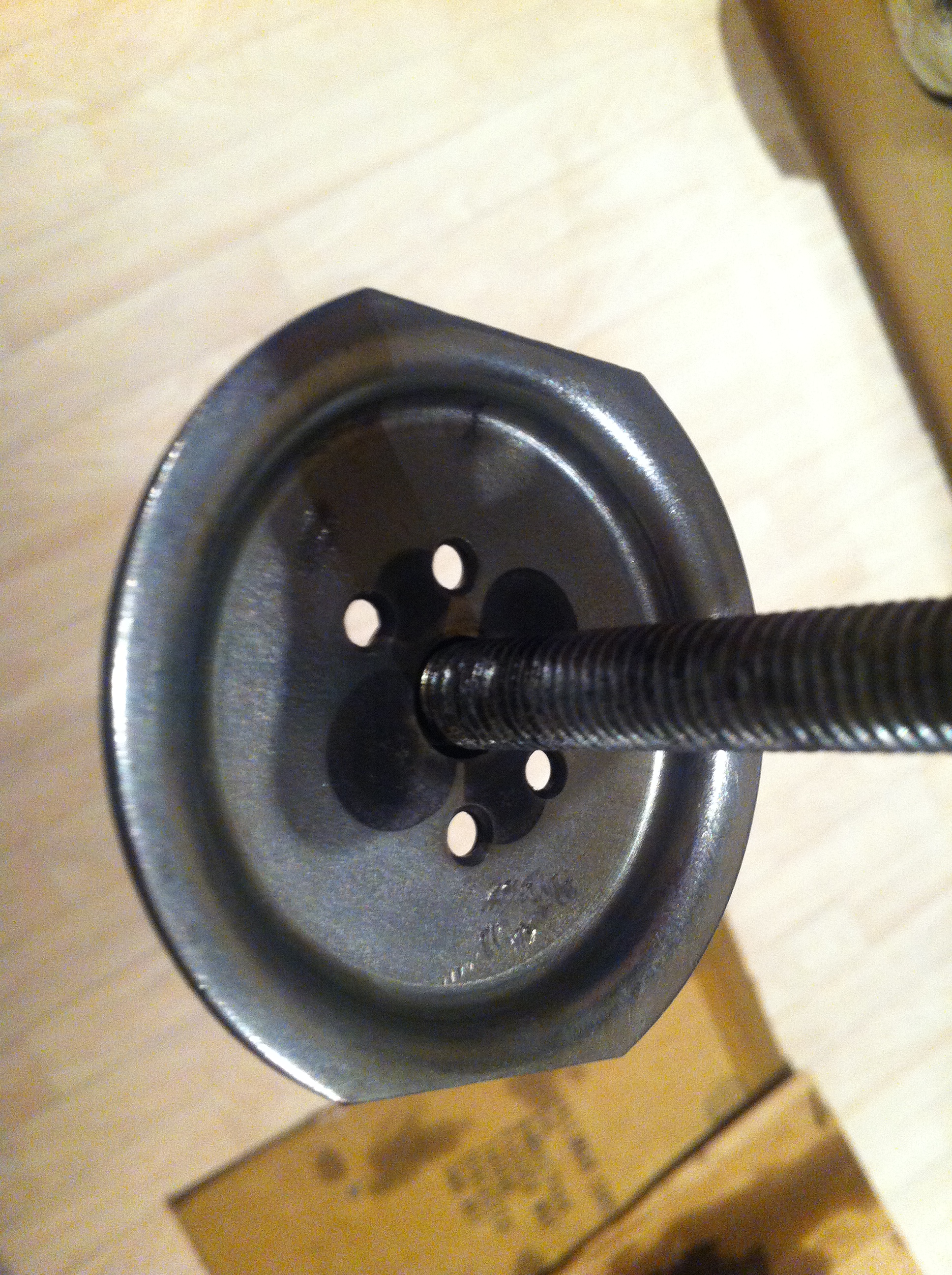

With my last seicento i had issues with this cr*p design, so mashed a bolt on the top with a bit of weld and then screwed a nut on the bottom.. This meant when swinging off the bottom bolt, it woulnt pull the top of the mount apart and spin it around and around...
This time i asked my mate to weld it, just really so i could see his welding... As it was his last day at work, he welded it up, and even polished it... just to waste some time there...
The weld is bob on, as you can see by the heating on the rear of the plate. So hopefully the car will be done to the same standard.. If not hes getting a slap lol :p
Ive then attacked it with more PU to stiffen it all up... should be rather solid when cured :D
Obv the thread will be chopped down to suit when its on the car...
