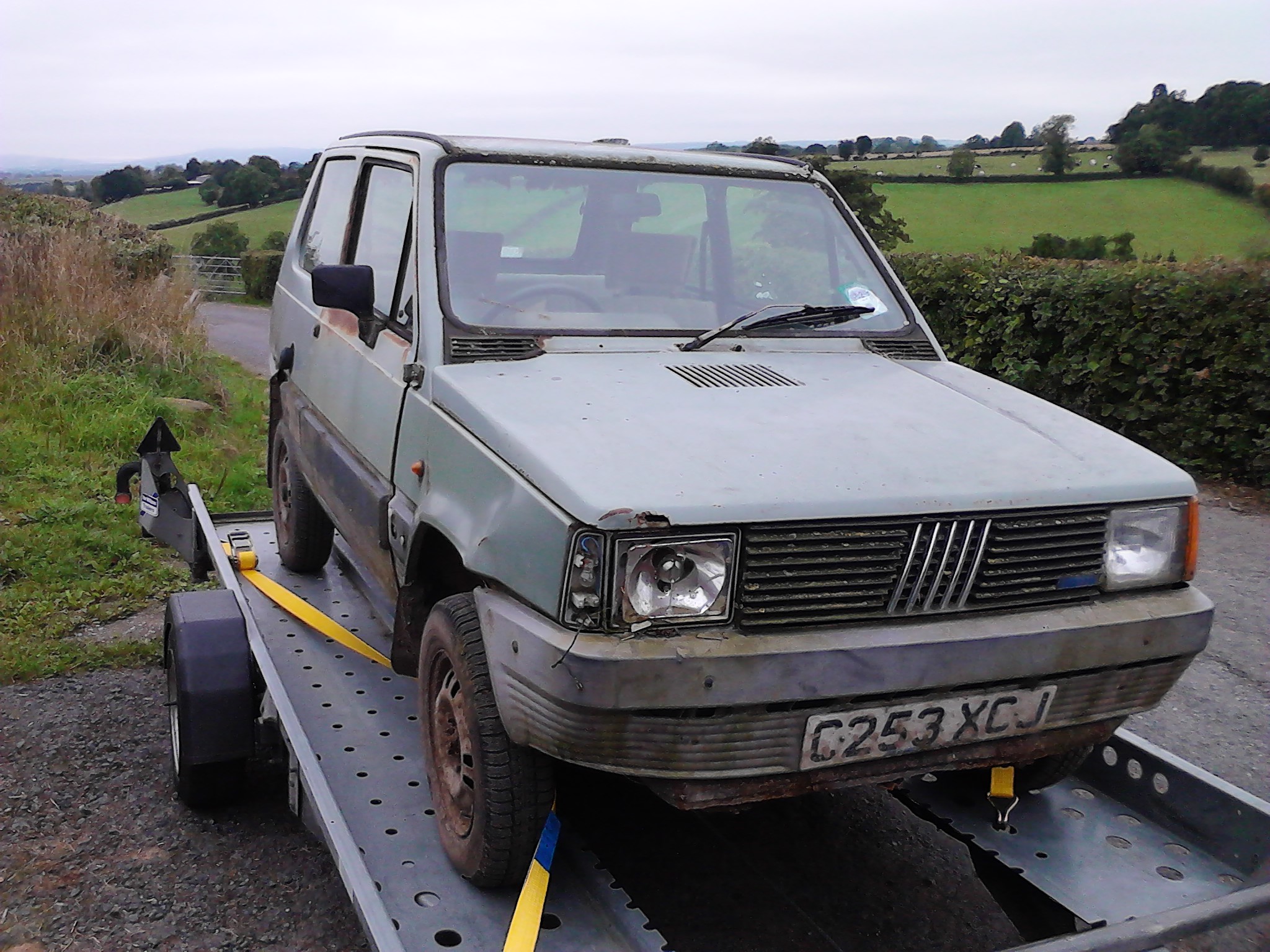

So here's the car when I picked it up:
(same model/colour as Sam (@goodgirl156)'s, but that's currently where the similarities end!)

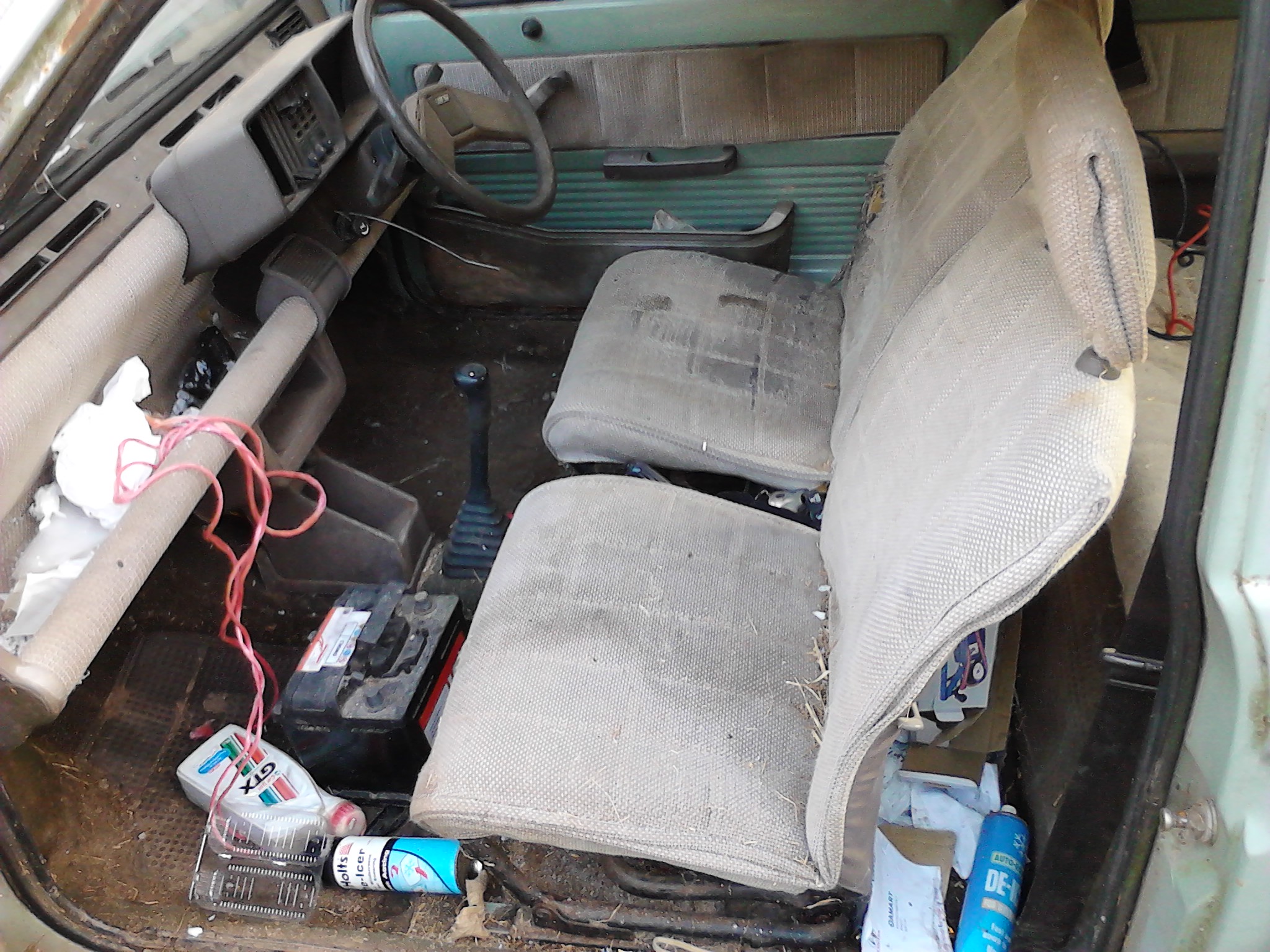

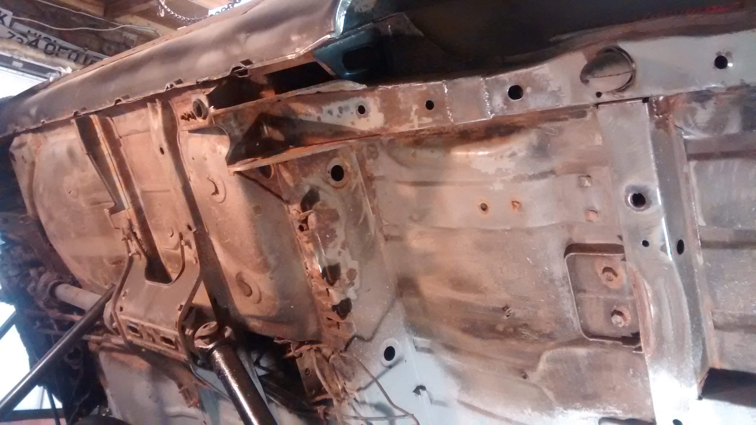

Had half an hour free this afternoon so started to have a look over, and clear out the minging interior. Plan is to strip out the interior to keep it safe from my inevitable welding fires, and to try and get rid of the smell! Always find it interesting cleaning out cars I've bought - highlight in this one is an invoice for animal feed (no surprise given the amount of hay in it). Lowlight is the evidence of mice..

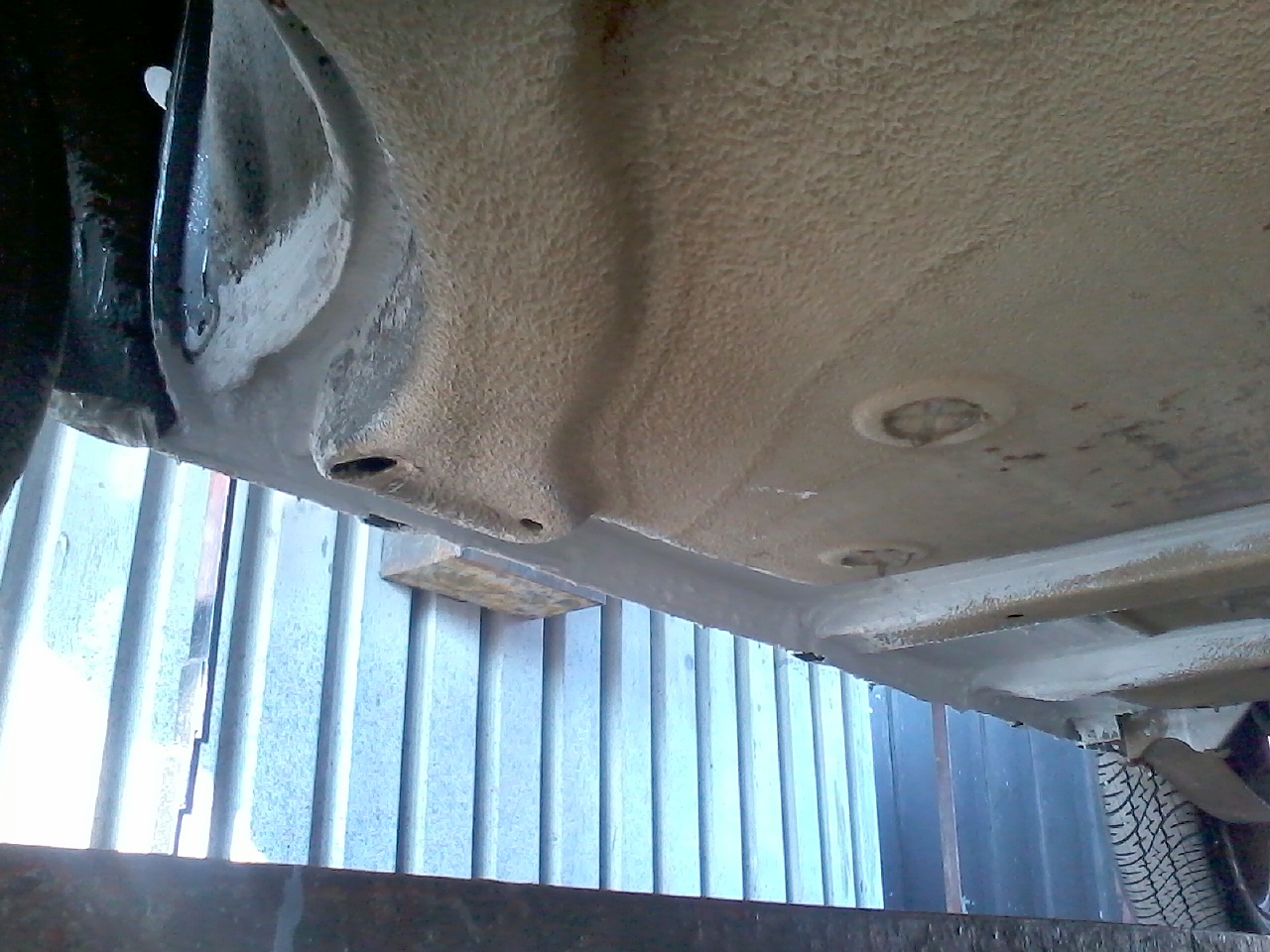

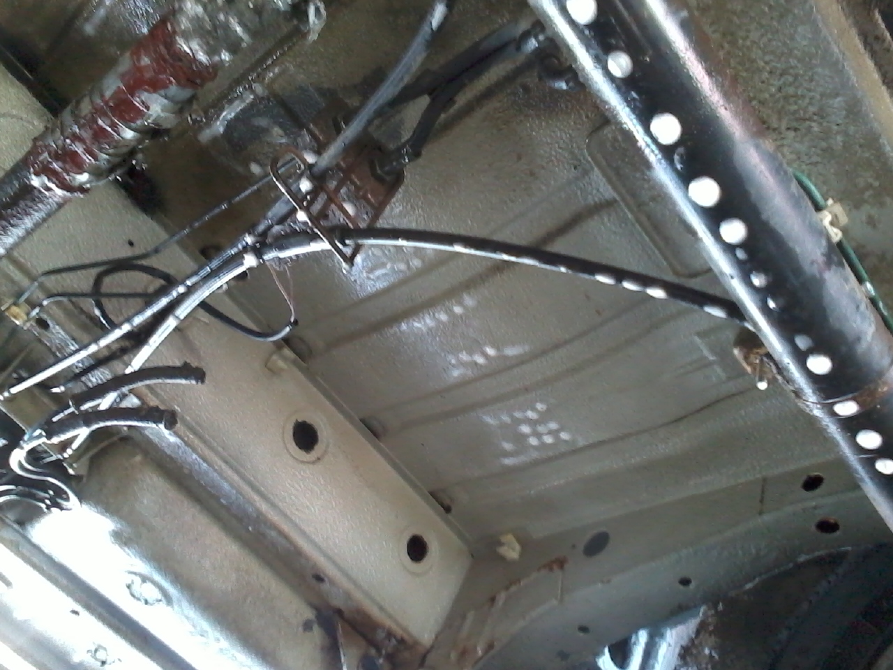

Question aimed at the Mk1 4x4 peeps so @goodgirl156 @pandamonius_maximus @Palio and VmanC (as omniscient): what colour is your car painted underneath? Can't work out if mine was body colour (verde alpi) or the colour used for the sills/lower panels (a darker grey). Any ideas? Conscious it doesn't really matter but I have both paints and am not a fan of underseal so might as well pick the right one!
Thanks
David
I am not sure about panda mk1, but my other fiats had just a beige factory "rubber "underseal, it was on my 128 coupe from 73, on ritmo 125tc from 82, also on my regata from 87 and on seat marbella 91.In wheelarches it was partially "dusted" in body colour but under the car out of reach of painting robots it was just "beige".
I don't recall the underneath being body coloured, but my mk1's are tucked away & I can't check. Vern might remember from when he was underneath Jasper & Casper, and has his own 4x4 mk1 now (somewhere).
Quite honestly if you prefer coloured & can give it enough protection, go with it. (y)
Hi David,
I can say they weren't colour coded underneath but not sure if they were the same grey colour as the lower sill panels. They were coated in a sort of dark grey rubbery gunk though. And under that a light grey which I think was just the primer.
Hope that helps!
Cheers,
Si

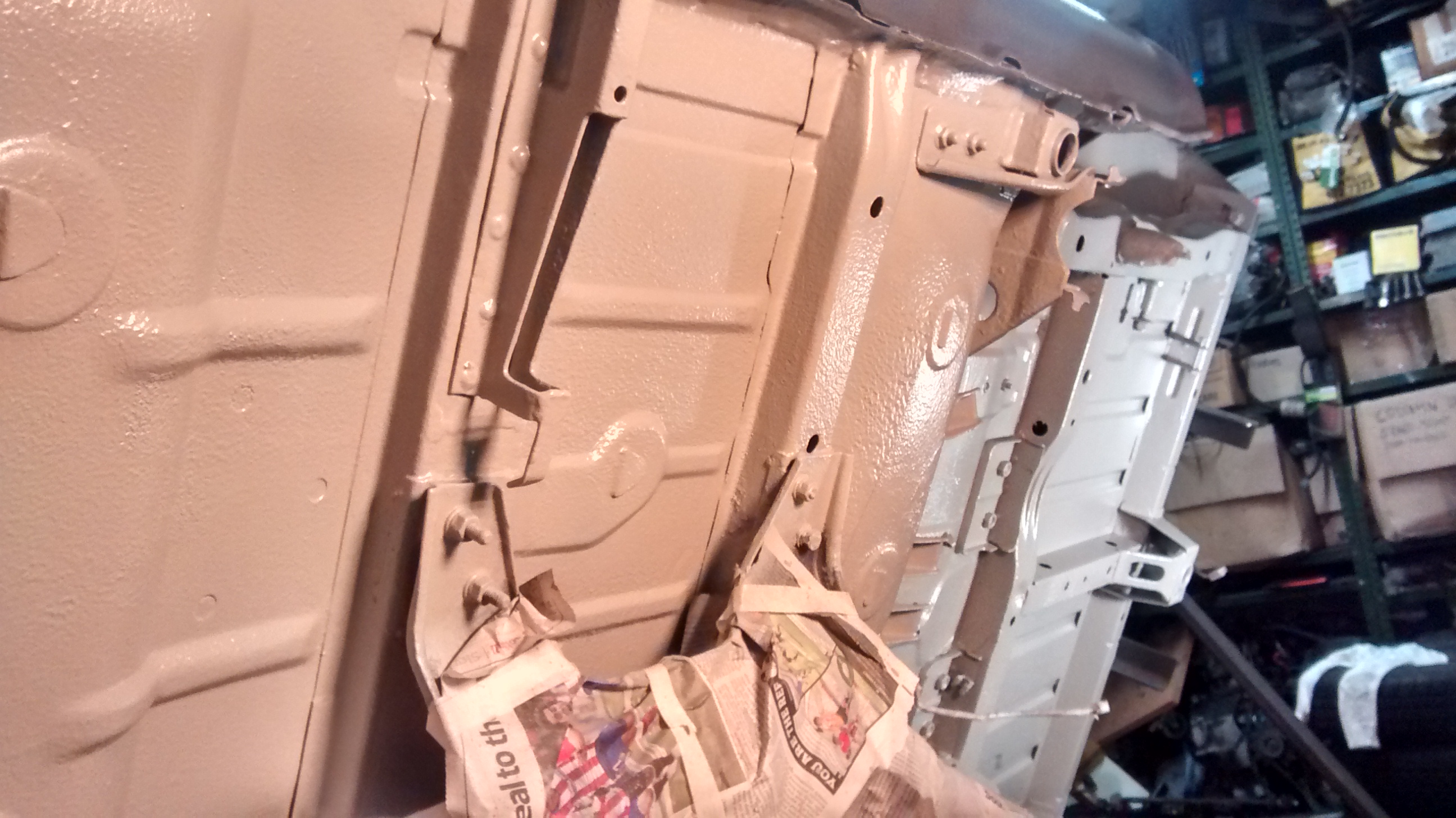

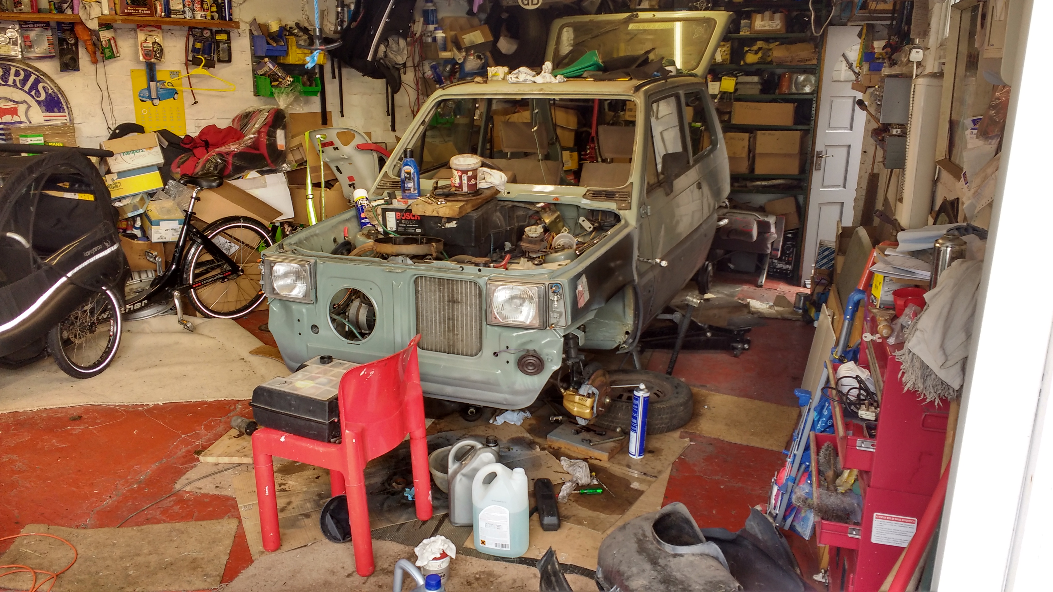

Thanks all. In the end went for a beige/grey as that was the colour of the resin paint I was using and it looked good enough to not bother with a further topcoat. Has a couple of coats for protection.
Re-assembly sometime soon, starting with the fuel tank and back axle.

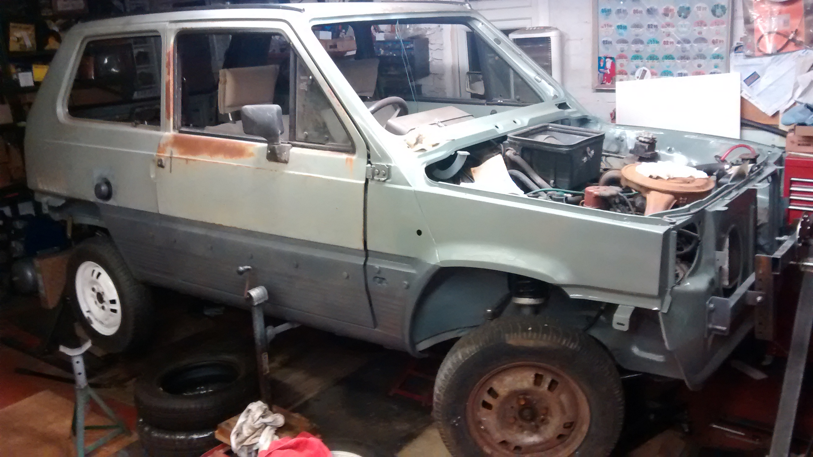

Wonder if I have been over-ambitious in booking an MOT for next Saturday...

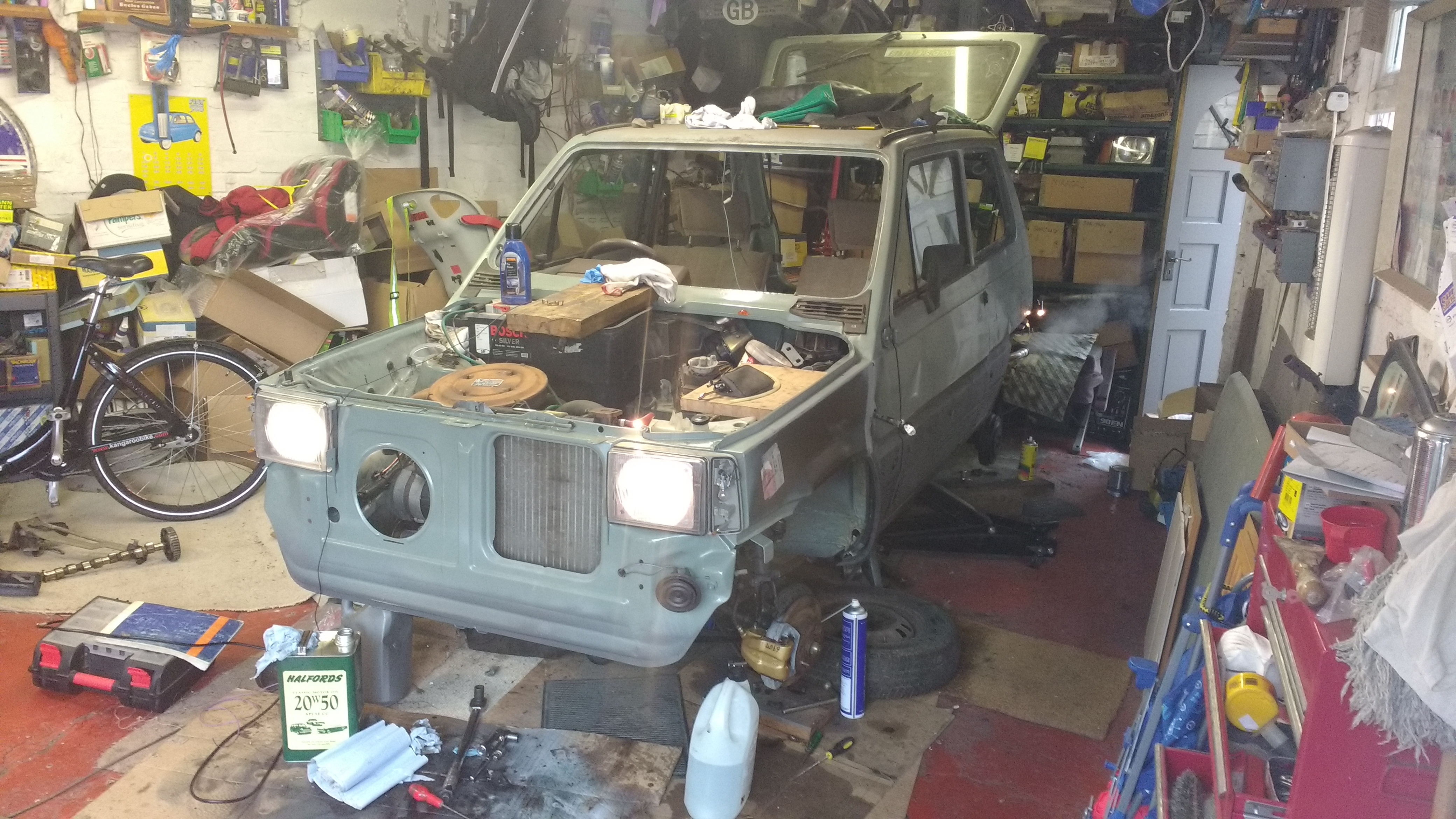

Brakes replaced and bled, engine starting well but running rich, lots of bits still to bolt on. However (inevitably huh) most time currently (geddit) being spent on the electrics. Latest status in tail chasing:
Rear lights and stop lights work
Right hand indicators work
Left hand rear indicator and side repeater flash in time with left sidelight. There's also an earth problem on this circuit.
Neither headlamp works, but main beam warning light is permanently on with ignition. Presume earth problem again (shorting through earth?)
Coil seems to get warm even when ignition not on (again shorting issue??).
Any guidance from the electrical experts much appreciated! Prayers welcome from everyone else.
David

Cheers guys.
Found a broken earth wire and generally fiddled around in an unstructured way. Got to a point where everything worked (though hazards every once in a while work on one side of the car only). So took a video and escaped while the going was good. Heading back to garage now to see if things still work..
Waiting for a few parts through the post but next it's bumpers, windows, wheels, and gaffa tape for the rough edges...
