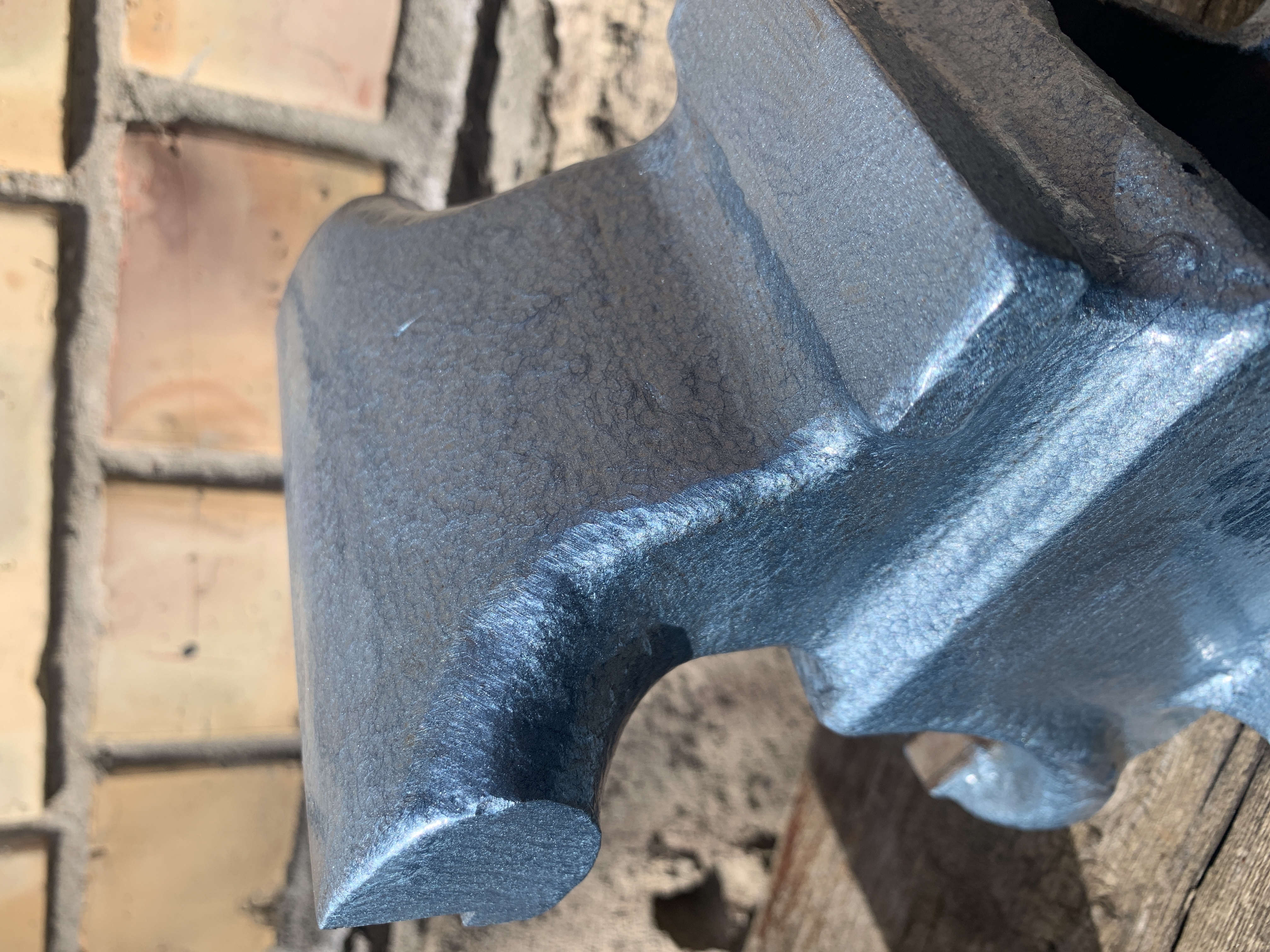

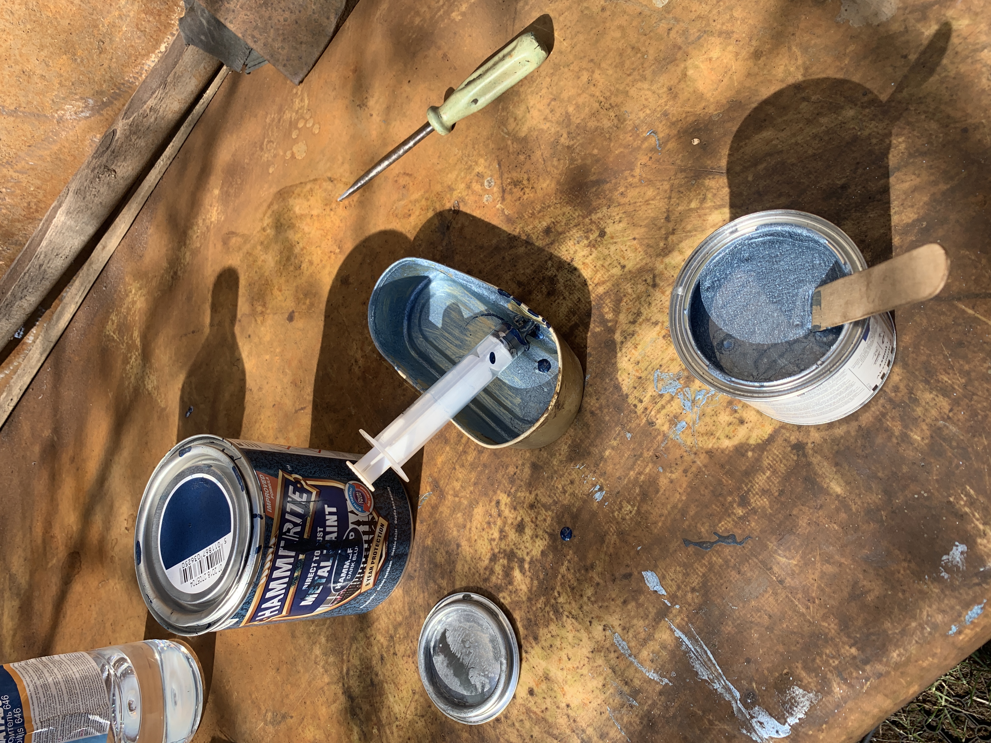

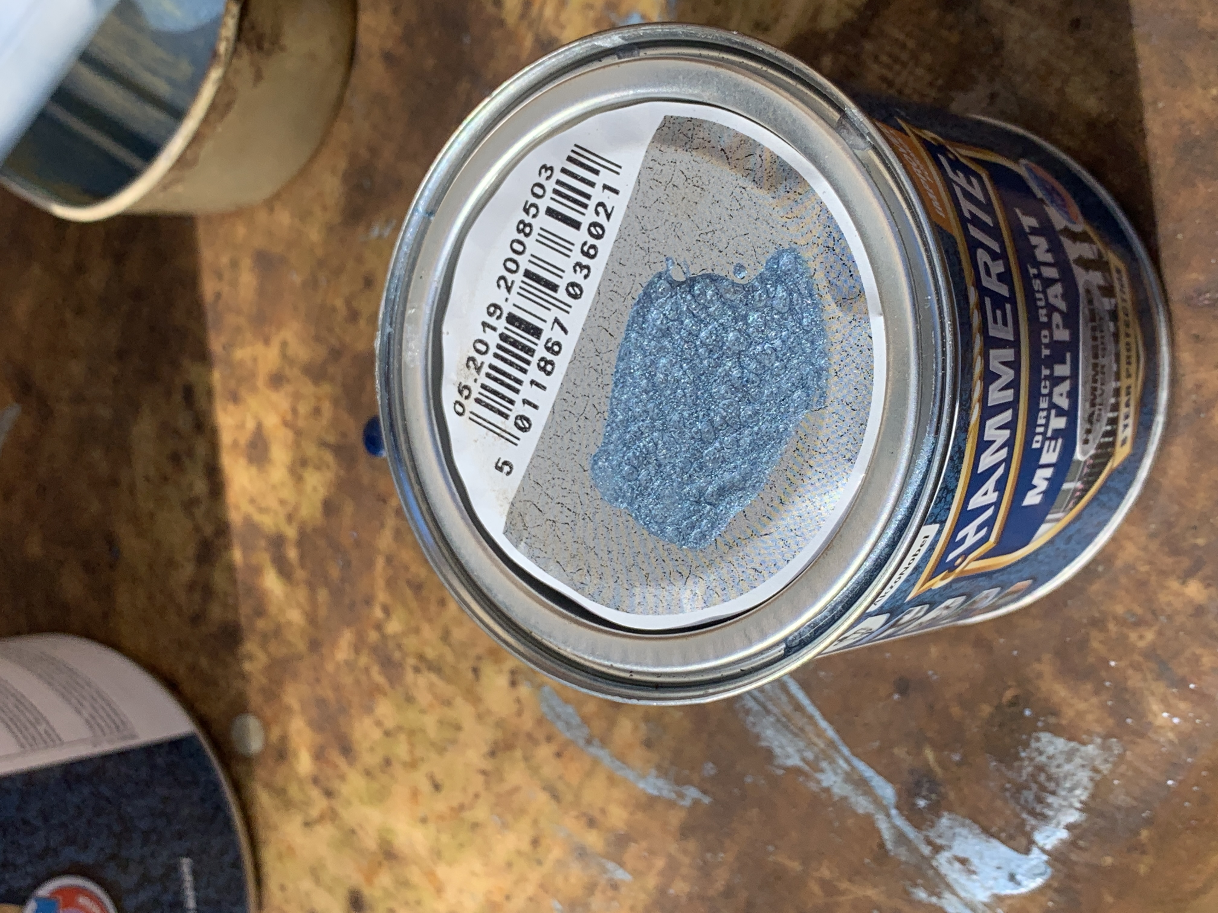

Hello lads. I was wondering about mixing hammered finish, because blue is way too dark to my taste. So searching the internet I have found your discussion here. I decided to try myself. So I mixed 20 parts of silver hammered to 7 parts of hammered dark blue. In my opinion result is brilliant! Quality of the finish is perfect. Paint set up as normal and is hard. Hope my experience will help someone!
