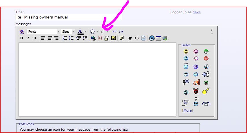

you can attach documents and pictures to a post with attachment button
