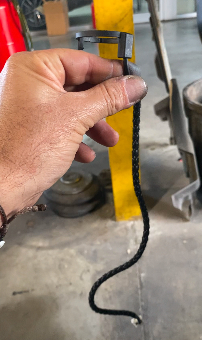

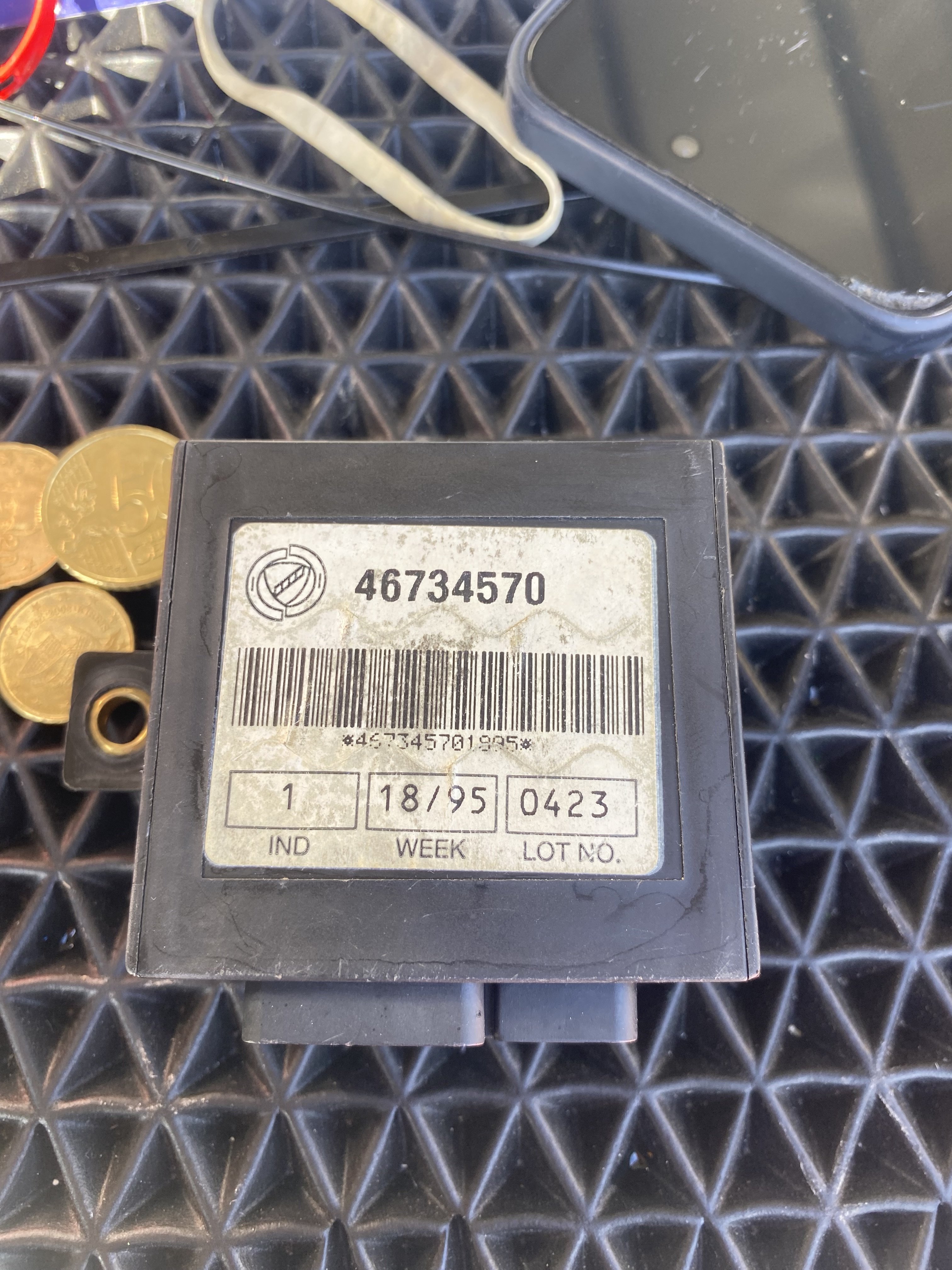

Hiya , An old thread to revive, but Ive just managed to create an issue.
after refit , rebuild of engine , relocation of battery to rear.
my ignition key code light came on at the dash and the B wouldn't start.
After good advice , using the spare red key , this managed to reset the key light and the B started. Happy Days !!
NOW ! all was well for a couple days until i began to pull fuses and relays to check for a lighting issue i have.
seems i have no power for any lights , dash, side, head, fog and even the rear. only hazzards work.
and NOW !
The key light is on again and B doesn't start. even with the red key the yellow key light remains lit .
could i have dislodged a fuse or relay and if anyone knows where exactly they are located for this.
any help , advice would be greatly appreciated and if the imobilisor can be removed out of the system if needed .
I have tried moving the cables of the imobilisor and the antenna to no avail
