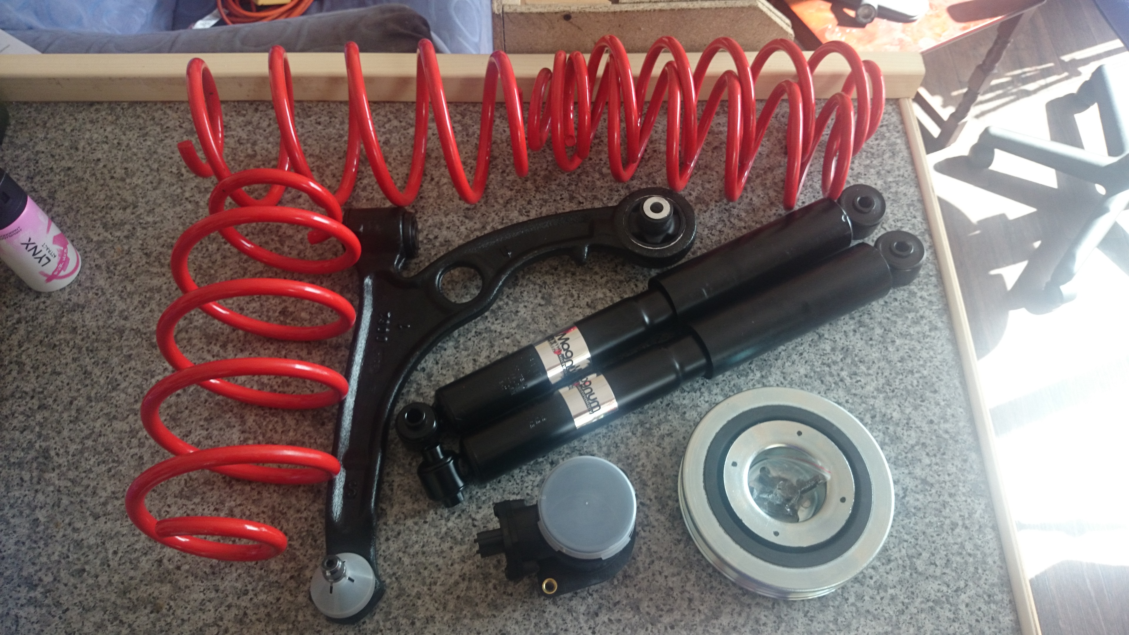

Well, today my parts turned up at 3pm today, so me being me I couldn't wait so set about and started to fit all my shiney bits, so I managed to fit,
front lowering springs
Front wishbone

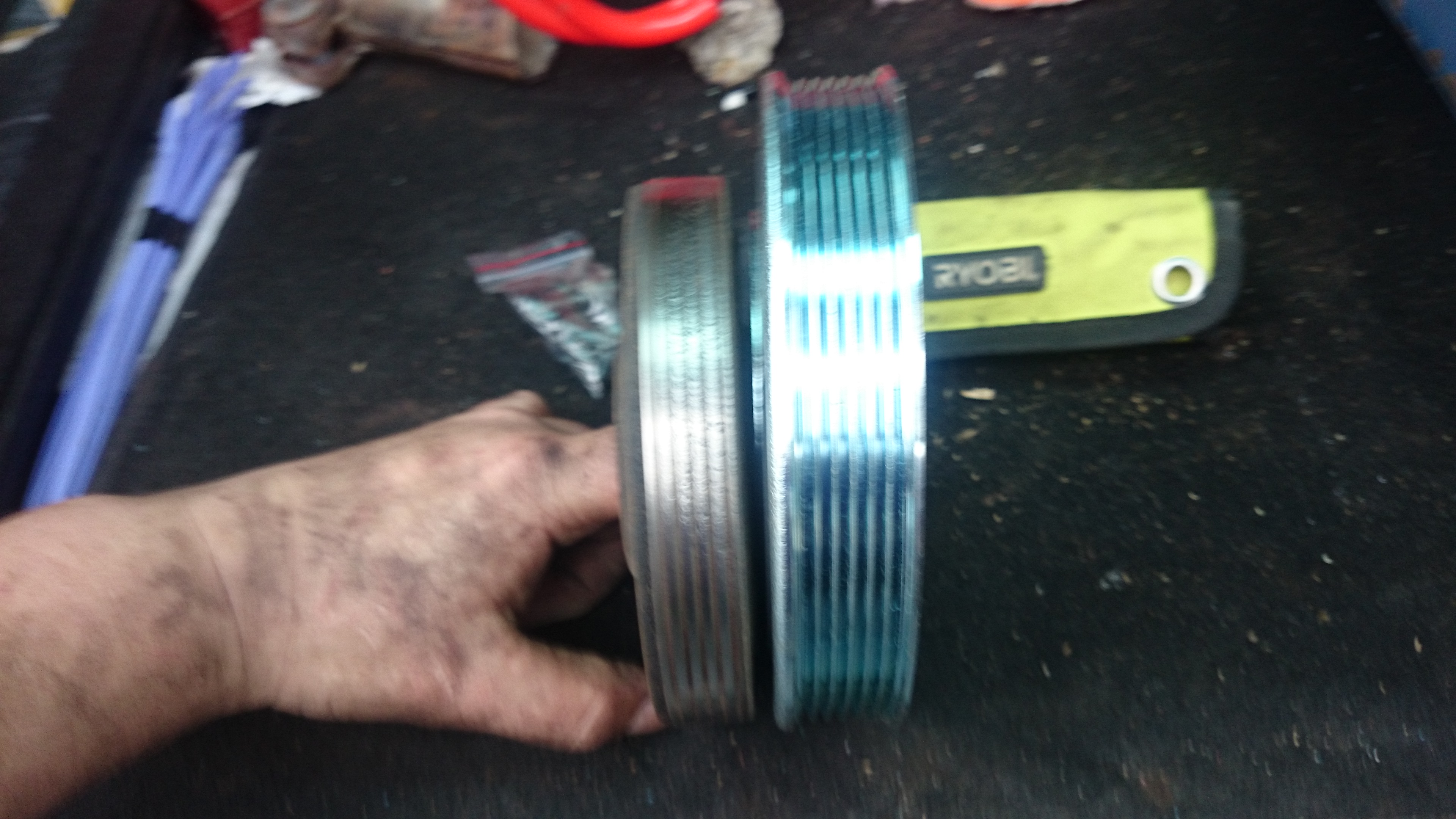

New crank pulley.
The old pulley was beyond dead and the garage hadn't picked up on how bad it was and just bodged on the new belt, no wonder it kept coming off, moral of the story, if you want it done right, do it yourself.
So tomorrow I will be under the rear fitting the rear lowering springs and new rear shocks. Can't wait.
Oh I also fitted my new MAF so time will tell if that's sorted my limp mode issue. Now for Piccies.
Pics 1-3 are the old pulley against new
pic 4 is pile of bits

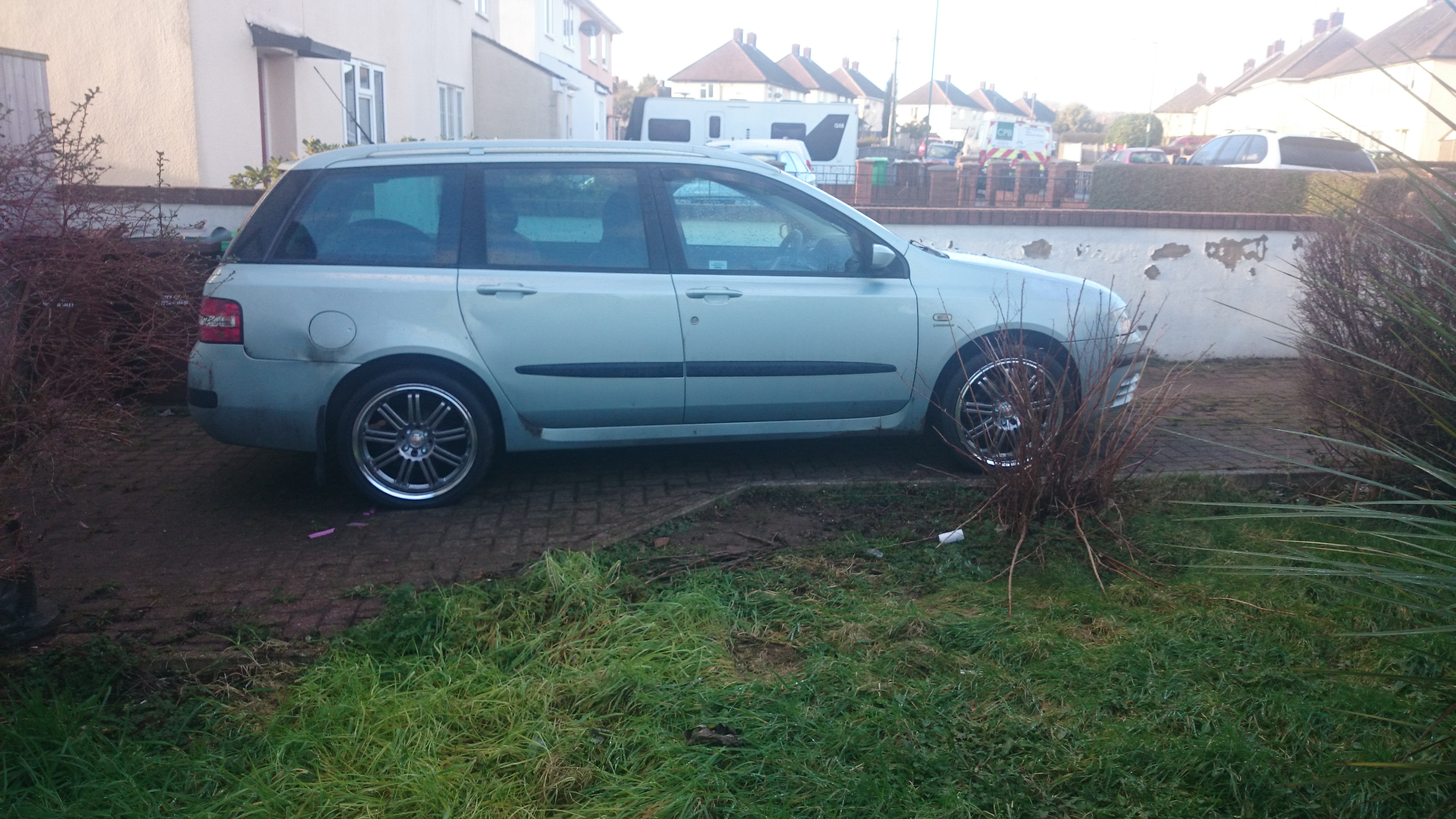

pic 5 before
pic 6 after

that crank pulley seems a little bit larger than your old one , wider even in the pic is it like for like or an updated part ?
from fitting my belt to mine I doubt there is enough play on the tensioner to allow that much larger pulley without a longer belt?
The new pulley is right and it's fitted and working fine, the old pulley was dead and actually and a bit missing off it making it smaller and removing the v belt groove things, really annoyed the garage never picked this up.

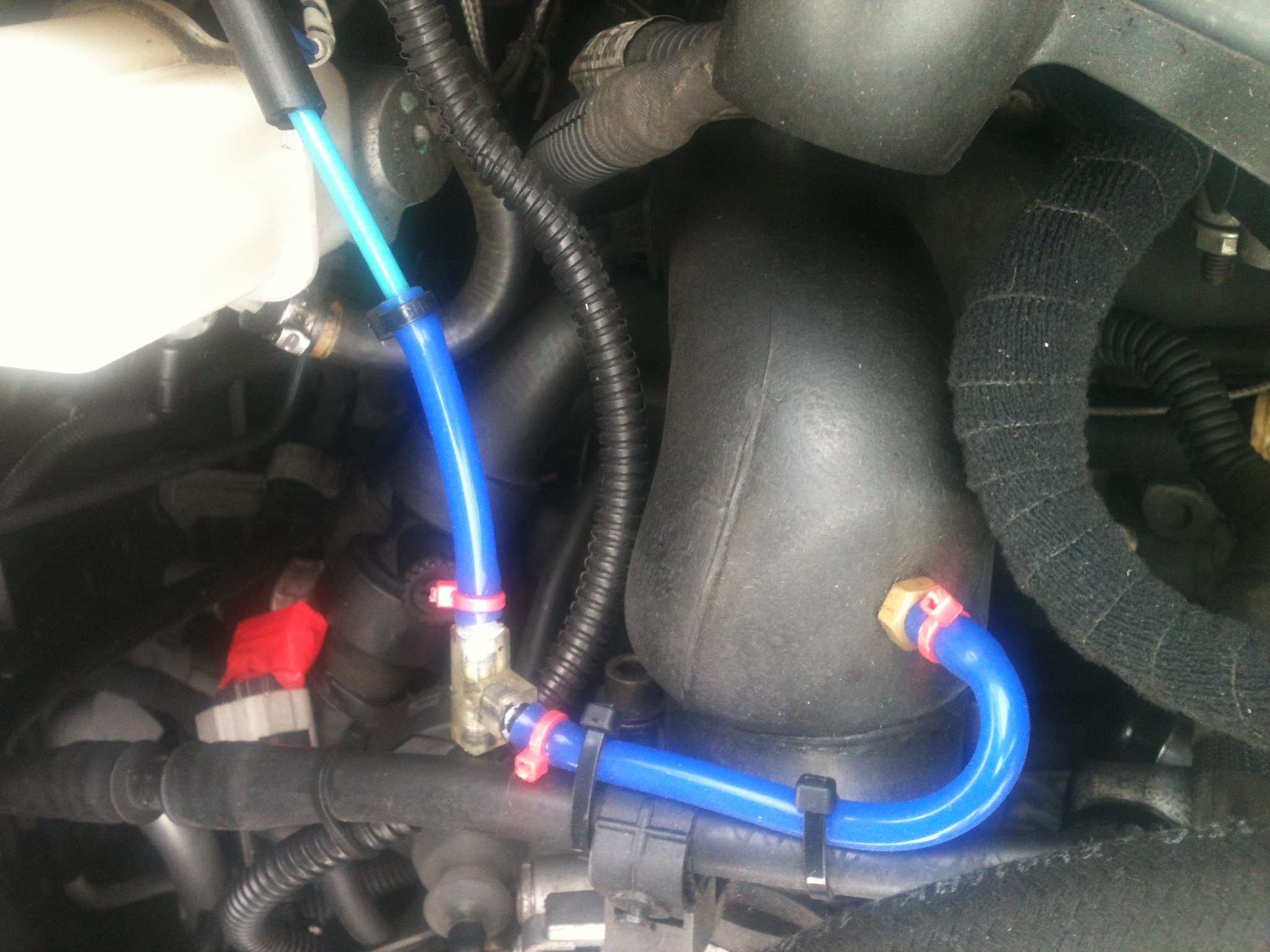

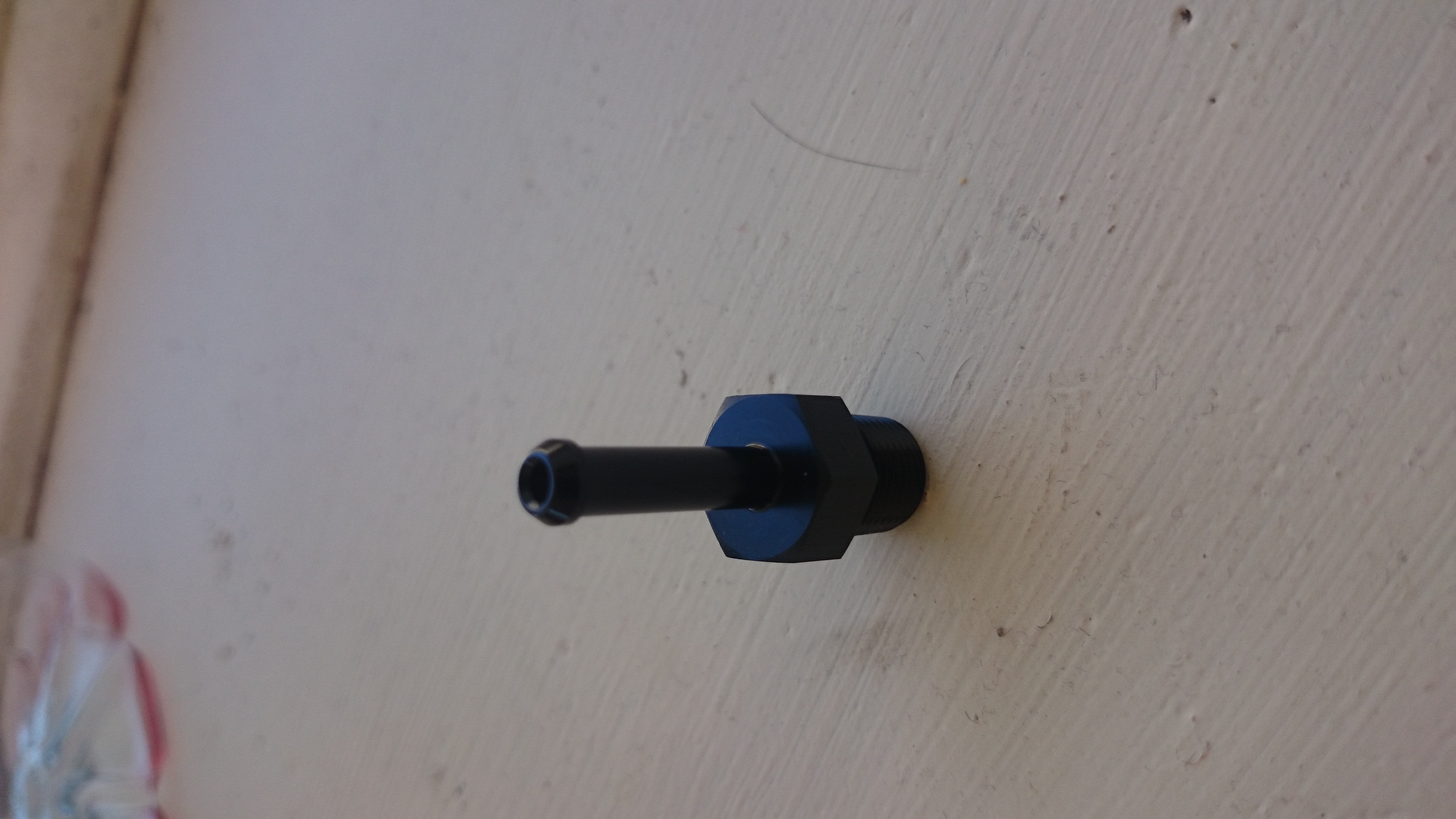

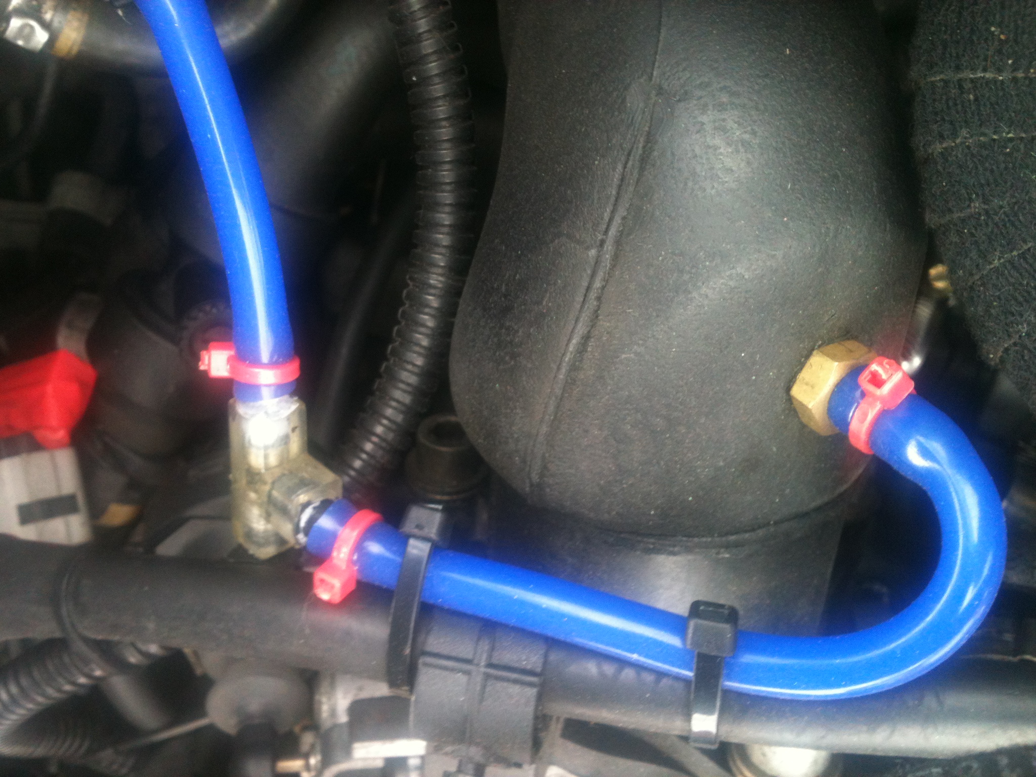

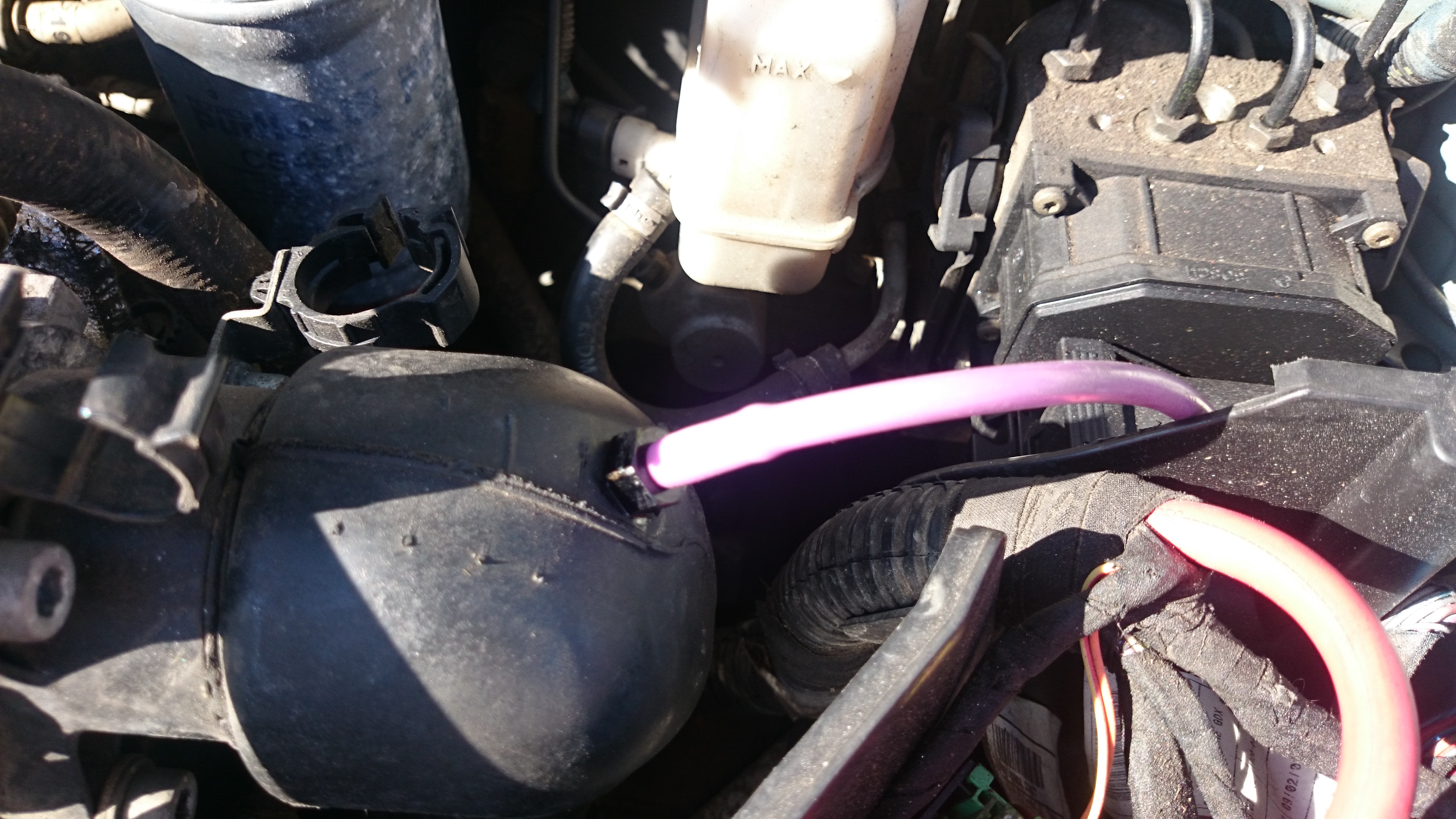

Actually Sussexa, where do I get a boost pressure takr off for me boost gauge???
I drilled and tapped the plastic inlet pipe just before inlet manifold butterfly flap.(easy to remove if you want to shove a rag in to save bits going into engine)
fitted a barbed fitting , taper thread just carefully nipped it in and its been ok for a few years now.
you then run your hose /wires into the cabin somehow , I used the bung under the brake servo (removing glovebox)
I can take a pic if you like , I had some but so long ago I think theyre gone.
also you want a restrictor to save buzz if mechanical gauge(aquarium valve, adjusted almost closed ,tested ok for response then glued tight)
I recently swapped to the blue silicone pipe whilst tidying up stuff, it swaps to 4mm od pneumatic pipe to pass from engine bay to back of gauge as a bit stiffer less likely to kink and I only wanted to do it once.

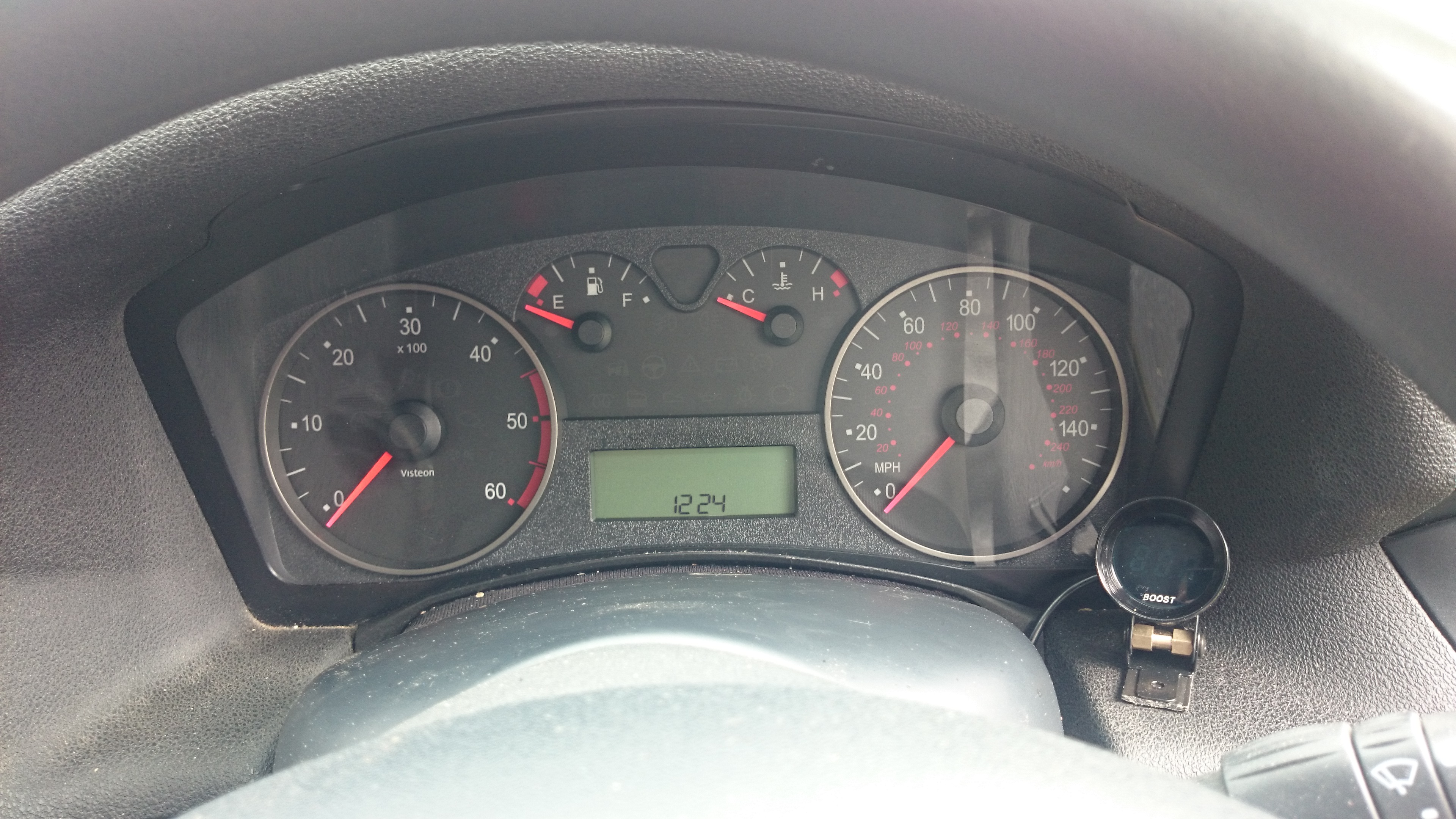

I have gone for a digital gauge so only needed to get a wire though to the cabin, got it all wired up, I just need to buy a barbed fitting and I think I will do it into the same place as you, cheers. Will get one over the next few days.
This is where I fitted the gauge, went for this type because it's nice and small.

Plan it many times drill it once
I dont have my eng cover on , check everything clears.
I also drilled it there as it was nice and easy to drill and tap square.
You dont want to end up with an oversize hole better too small as long as thread starts.
Best would be direct to ally manifold or egr housing etc but cant be sure bits wont drop inside , i didnt want to risk it.
I think there may be another gromet on that side of the car below pillar, i think someone put a gauge in a pillar pod and fed supply from drivers side somewhere, again i never looked for entry that side so not sure.

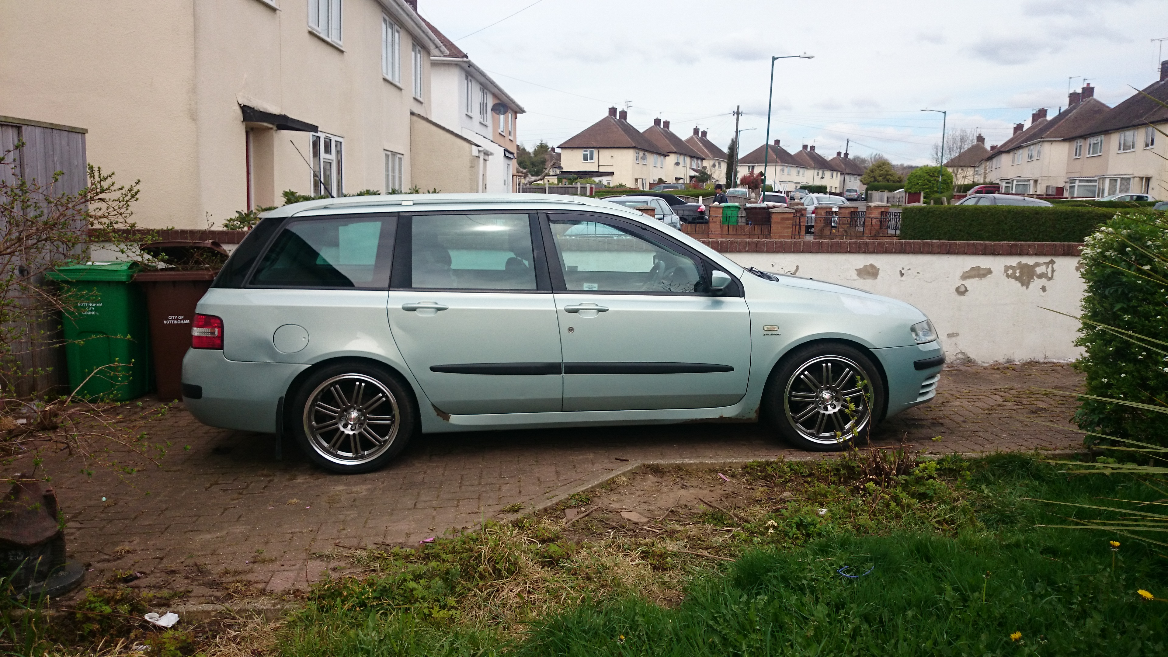

Well, get the rear lowered today, very happy, rides well and sits perfect. Highly recommend Eibach Lowering springs mated to Magnum Technology shocks.
Before and after pics for the rear.
I have had fun this week, and finished it off with connecting my boost gauge up. Did it your way Sussexa, it was just easier lol. It's sealed in so shouldn't leak.
