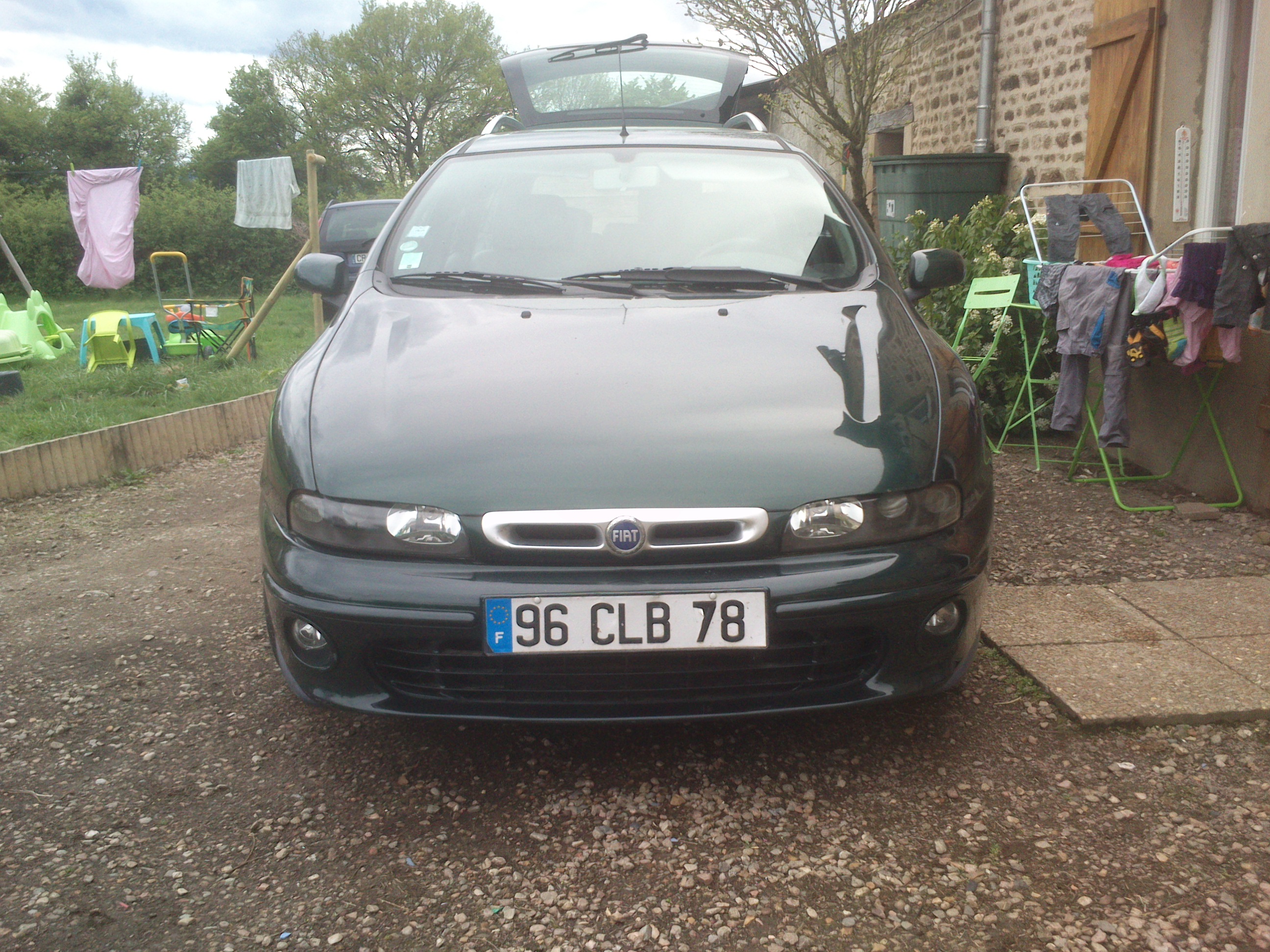

Marea Marea Weekend Saint Moritz JTD 110
After having been watching this car for over 4 months, i finally called the garage and made a deal, then the very next day my previous Marea threw a tantrum during a climb up a local hill at full pelt. she's not worth repairing and is now parked in the garden waiting to be stripped for useful parts.
The new car is lovely, very tidy and has leather seats, but as with any car over 10 years old, she has quite a few things to do, but i have no money for this to be a project car, in terms of upgrades, she will remain vanilla as far as possible for the foreseeable future.
im amazed as to how much more open the JTD 110 engine bay is compared to the TD100, i have ABS and a whole load more other gubbins in there, but i have LOADS more room around the back of the engine, they did a great job of tidying it all up between 1999 and 2002. getting rid of the front air intake above the radiator was a good idea too
currently at 107,000km (66,000 miles) dash shows 87,000km due to a dashboard change at 19,000km

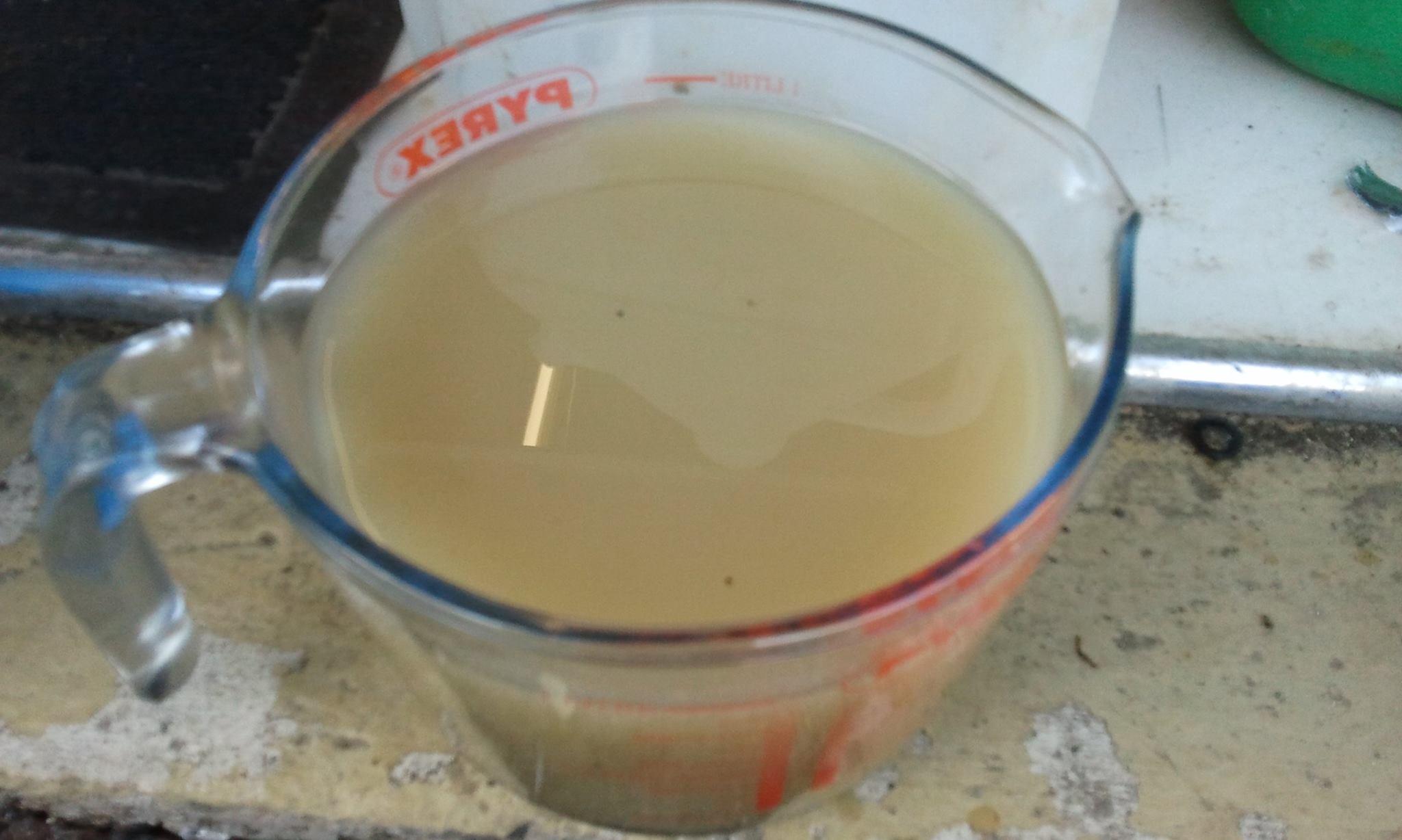

Oh yes, and a really good radiator flush with some additive will probably be worthwhile... I generally do 2 flushes with 1/2 a tin of stuff in each flushing mix. The stuff that comes out... :yuck:
totally agree that flush is worth it.. I don't always use it when i change coolant but i did my bravo the other day and considering what was in it before i stuck flush in looked quite clean and i know its not really been in there longer than a few months - once the engine had been run with some flush in for a while what came out was not nice clean coolant - it looked more like milky tea.
But i shalt be doing that next time, I change coolant every year but would only use actual flushing liquid every few years - normally just drain and fill with water and run upto temp and then drain and repeat until I only get nice clean water out, then fill with 50/50 coolant and water.

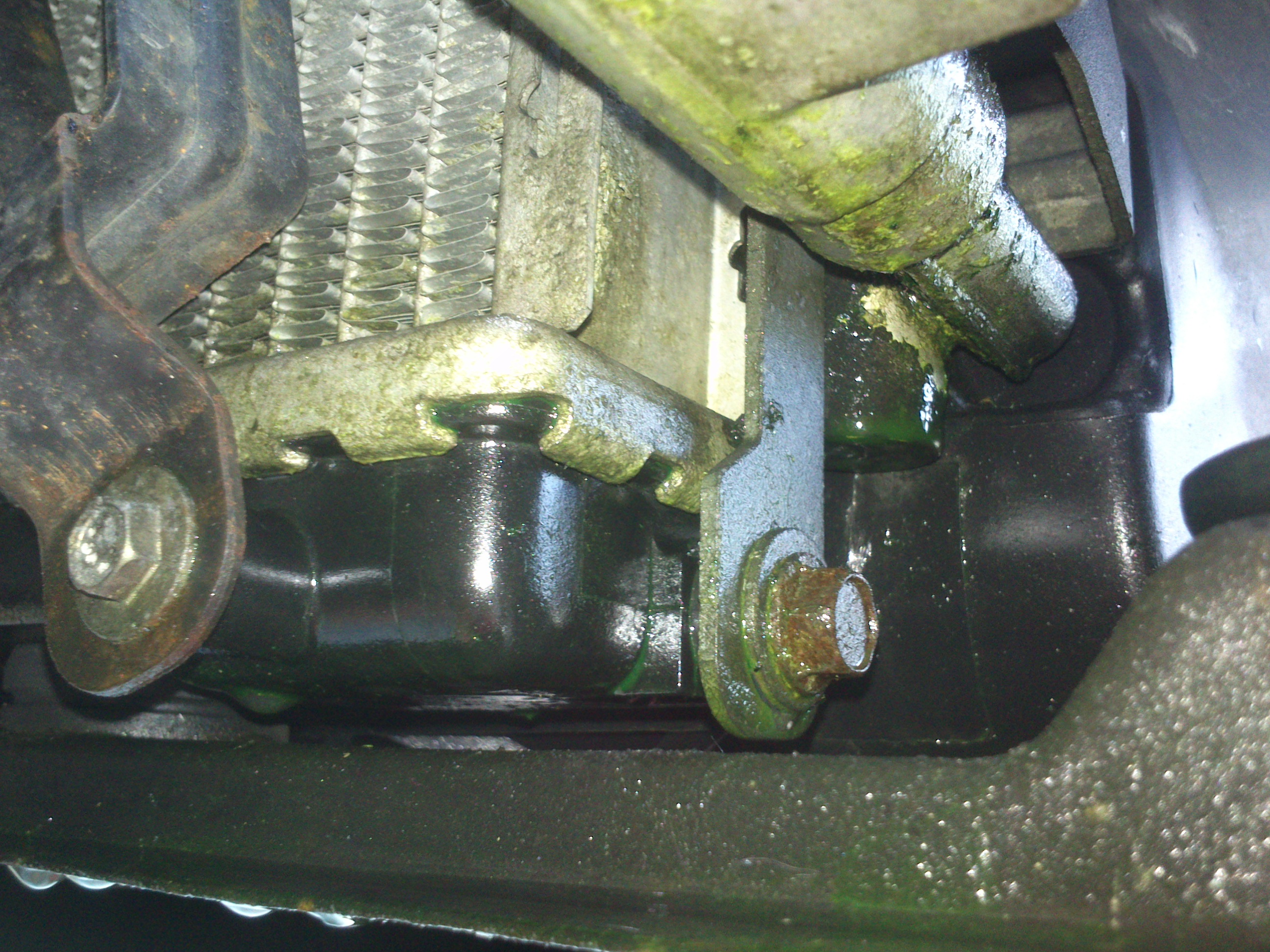

When i bought the car then aircon was empty, i had it filled but within a short period, I noticed that there was a green fluid next to the inlet for the radiator (photos 1,2,5&7), i had vague hopes that it was just condensed coolant which had stuck around since the timing belt change as it rinced off with water very easily, but as the aircon got weaker and weaker, and the liquid came back, i knew what was going on.
so a quick check online for a cheap radiator came in at 100euros, trying to save a few quid, as im off on holiday this month, i checked on Eper, and saw that the condenser is the same for pre and post facelift models. To remove the condenser, i found it's possible to remove, without having to drain and remove the coolant radiator, just pull out the lights and remove the bonnet catch cross memeber (photos 3&4). after that, off came the piece from the old Marea, but hesitation as it had oily traces and caked on dirt (photo 6). I fitted the piece anyway and took it to the French Halfords (Norauto) for the cheapest refil in town, and after making sure that they only refill after a leak test, they did the refill, so far so good, at worst i've wasted 50euros on a refill, and delayed shelling out 100 on a new condenser, but such is the way of things when the budget is tight.

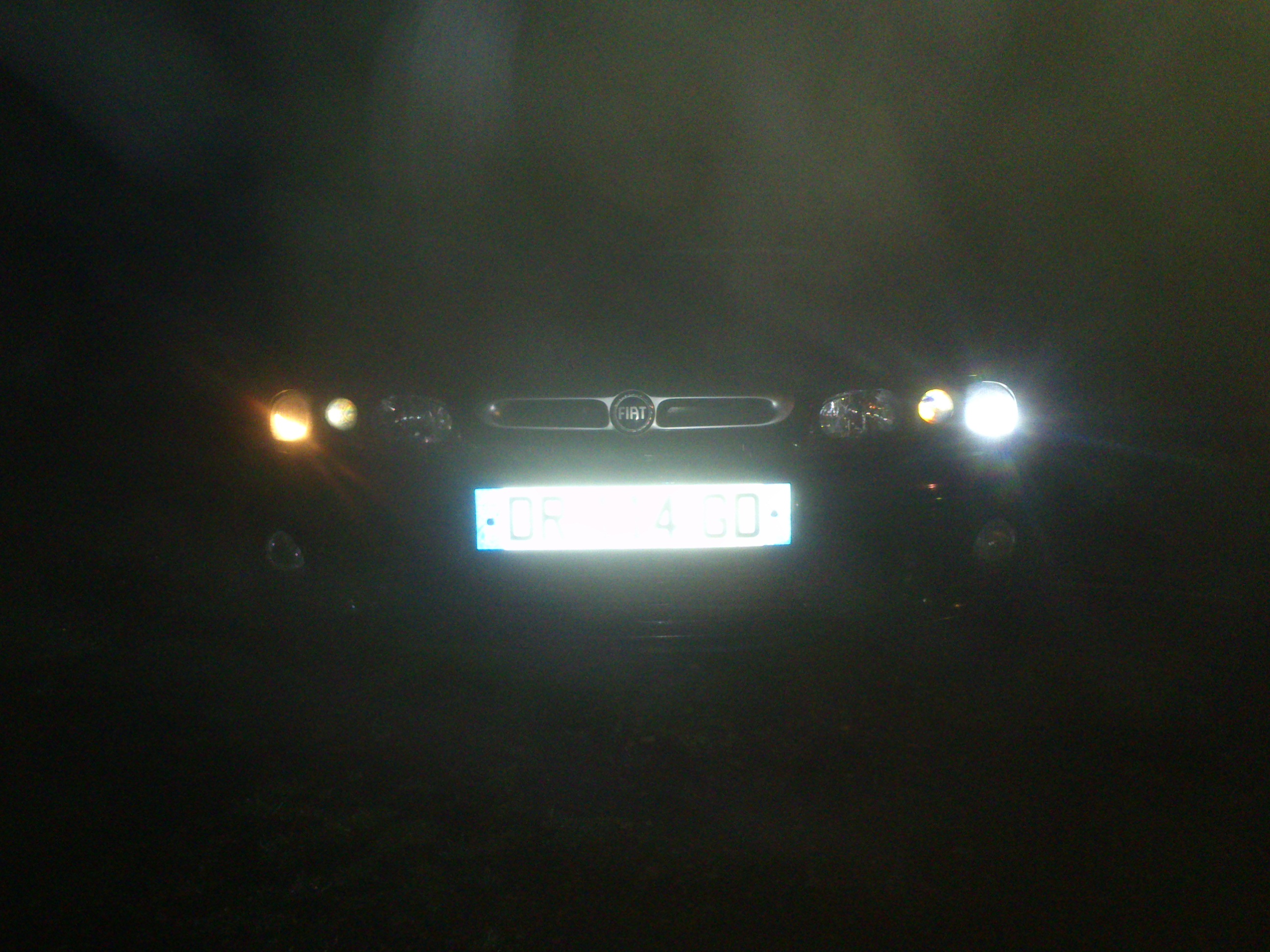

Not much been going on, had to get new tyres for the front, BF goodrich, nothing too fancy, and have just ben plodding to and from work. last week though i started having a slight problem with what i am sure is an EGR issue, hesitation after being at idle or decelerating, this is a problem when setting off from lights, and especially hill starts, i have stalled it more than a few times. The times it doesn't stall, or i'm going round a corner and have some momentum, i press the go pedal, but nearly nothing happens, a few seconds later, a shudder and it kicks back into life and i'm off again. during the last week it's been getting more and more frequent so today i too apart the whole EGR assembly and gave it a good clean. Plenty of carbon build-up everywhere, but that's to be expected, the problem seems to be in the solenoid, the spring loaded inlet valve moves freely and easily, but when testing the actuator in MES, it only works properly half the time, it sticks and wont budge, sometimes open, sometimes closed, so i hope that is the culprit. i put the whole thing back together again but left off the solenoid, effectively blanking the EGR system, i would prefer to have the car in full working order, and so will try and clean the solenoid assembly as best i can, but it is a sealed unit with no way to disassemble. Something else i found slightly concerning, was the oil on the underside of the air inlet pipe. I assume it's normal for the turbo to send *some* oil back into the intake, but enough to leak out and drip down the intake pipe? i'm not sure that's normal.
on a side not, i have started on a mission to change all my lights, as many as legally possible to LEDs, i started with my sidelights, and liked them, so i went and bought some more. for the poly ellipticals i have some 35watt HID xenons on the way, the main beams i have already put in some osram nightbreakers, first i tried in the diupped beams, but honestly i saw NO difference what-so-ever, then i tried in the full beams, and the difference is not great, certainly not 130% more light. but they are slightly whiter. compared to the bulbs i got in the supermarket for 5euros, i don't feel that the 15euro price is worth the money. still im not too fussed, i rarely use the full beams so it's no big deal.
I have an order on the way for 8 LED P21Ws for the whole of the rear end, and orange ones for the front indicators, i hope that they are as much of an improvement as the sidelights were.
photos are
1: sidelights: left filament bulb, right LED
2: dipped beams with supermarket halogens
3: dipped beams with OSRAM Nightbreakers
4: full beams with supermarket halogens
5: full beam with OSRAM Nightbreakers

with regards to the OSRAM nigtbreakers, i retract my previous assessment, i have done a bit more night driving, and my initial tests did not show the full capabilities of the bulbs, they are in fact much better than supermarket halogens, and i would recommend them as an upgrade compare to OEM bulbs.

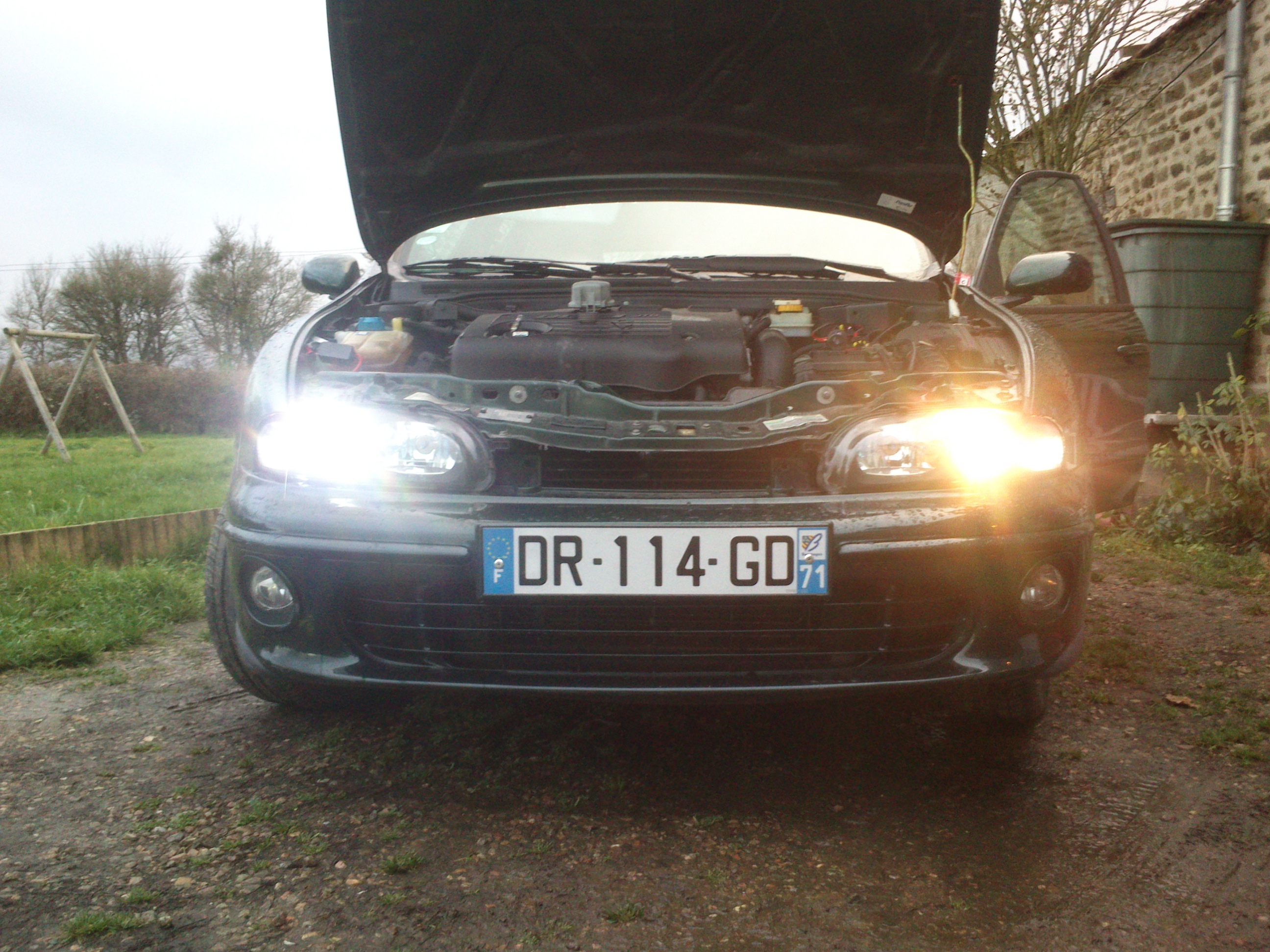

got my HIDs today, i had a spare half an hour to see what they looked like, but not enough time to install them properly with the ballasts securely attached, and a hole cut through the dust cap for the wires to pass through.
35watt 6000kevlin, me likey.
