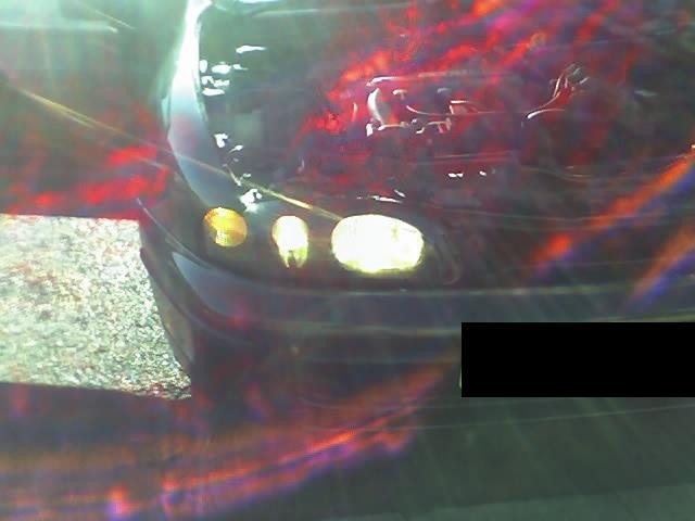

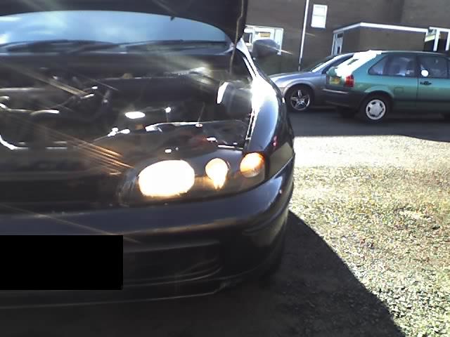

I got them working with out the use of the boxs so no need to get me any, Ive even trowing a bucket of water over them to make sure the silicon seal is holding the cables in a water tight hold on the back of it, Looks very neet and clean the two cables have been glued down the underside of the lights so they our hidden out of place, And just to make sure nowt gets in the cables ive used some elecey tape on them to make sure there sealed....

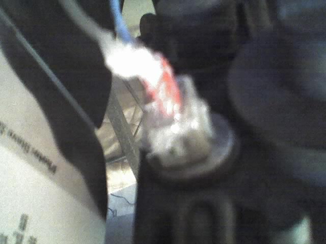

See what ive done with silicon
I placed it over the top of the wires where the originaly plug in to the bulbs, So that no water is able to get in side there, I left a rubber ring in side of where the bulb acutlay goes to help prevent any leaks in there. That part there where the wires our see able is the only part where open connections where see able to the eye or that might be effected by water so i used water right silicon to seal it.
Ive also converted the Merea head light from a 3 pin connecter to a 4 pin connecter so that it plugs direct in to the bravo plugs with out the use of having to bare wires or connected extra cables. All lights work as they should and all lights turn off as they should,
And i must admit yes jug as your posts say they look nice in the car very nice.
Also the two cables that you can see in the photo have both been fully covered in sil to to prevent any water getting in a nick or break in the cable ive also ran the wires along the base of the light and covered them in black tape so they can not be seen. I think i should be ok from water now.
