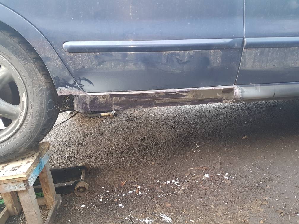

Rear sills have been needing doing for a couple of years now so we managed to get a pair of genuine fiat sills from Brasil for the Marea ....
Where only cutting out the rotten section as from the pillar foward it was treated a few months back with no rot what so ever
Also the inner wheel arch will be cut out and replaced at the same time.
Lower black plastic sections of the car will then likely be painted in body coulor whem everything is finished but that abit of a way off yet .....

Not updated this in a while ..... so the Marea has had its sills and most of the floor replaced now .....

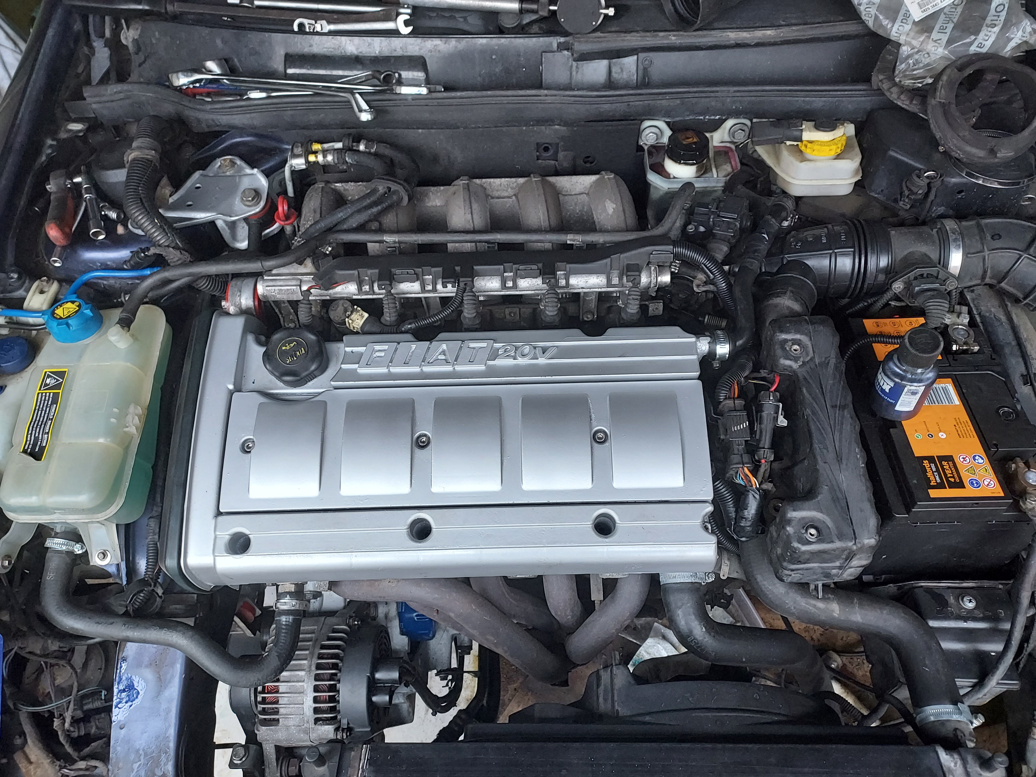

Also redid most of the engine with a top end rebuilt and all new mounts and bushes .....
