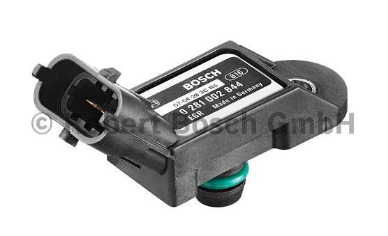

According to ePER and your VIN. Your Multipla was built on the 8th June 2005 and is a 1910 JTD 115bhp CF3 (Euro 3 emissions) with engine number 4523400. If this engine number is correct (i.e. the engine hasn't been replaced), the Fiat part number for the MAP sensor is 55206796, Fiat price £29.29 +VAT.
Cross referencing the Fiat part number from the Bosch catalogue gives Bosch part number 0 281 002 844.
Bosch part number 0 281 002 534 you posted in post #8 above is a high pressure fuel sensor, not a MAP sensor.

The confusion gets even worse. If you click to view the picture of 0 281 002 510 in the Bosch catalogue, it shows a MAP sensor with part number 0 261 230 052 printed on it. :confused:
Fiat currently list the part number for your MAP sensor as 55206796 (Bosch 0 281 002 844).
Fiat part number 55206796 is a modified version of 46811235 (0 281 002 510). The modification was listed by Fiat from August 2006 but also applicable to earlier models.
It would appear that Bosch are still supplying both the original and modified versions, however, I would be inclined to go for the later one as listed by Fiat.
Unless your MAP sensor has been replaced with a cheap copy, you could also check the Bosch or Fiat part number printed on it to compare. It's only one screw to get it out.
