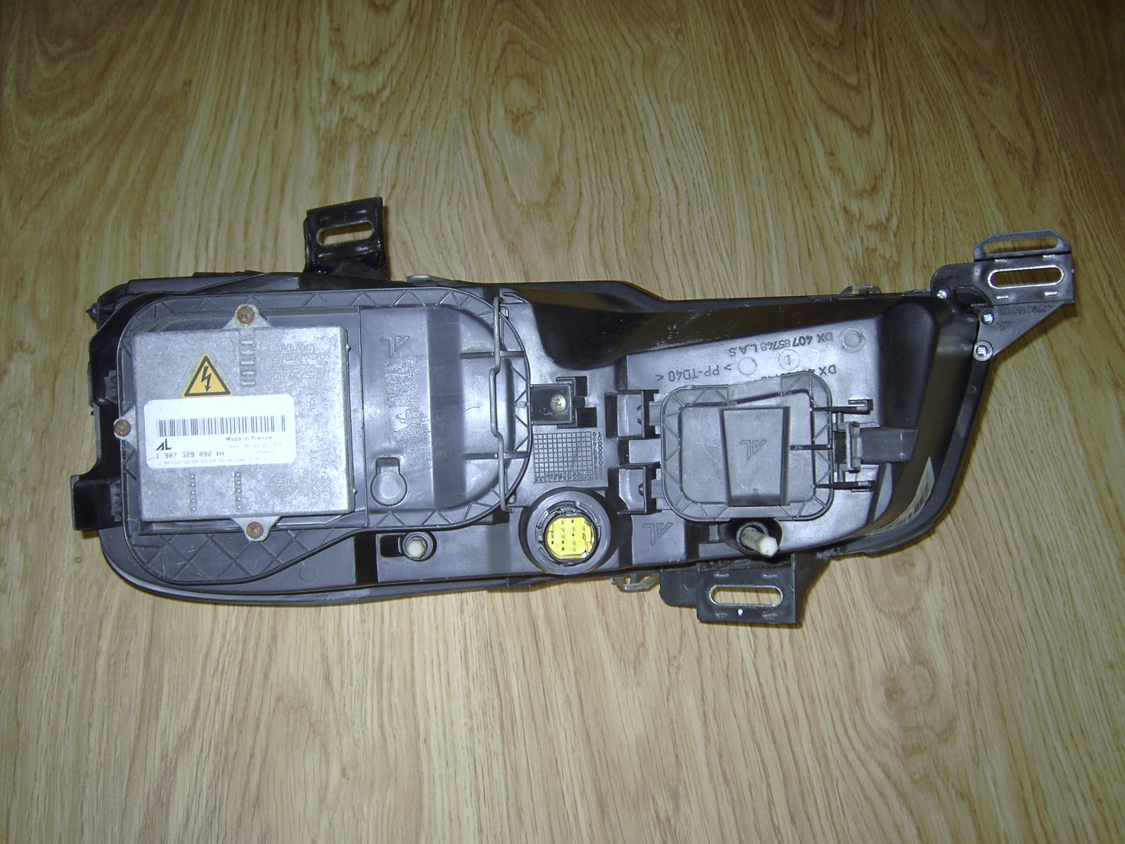

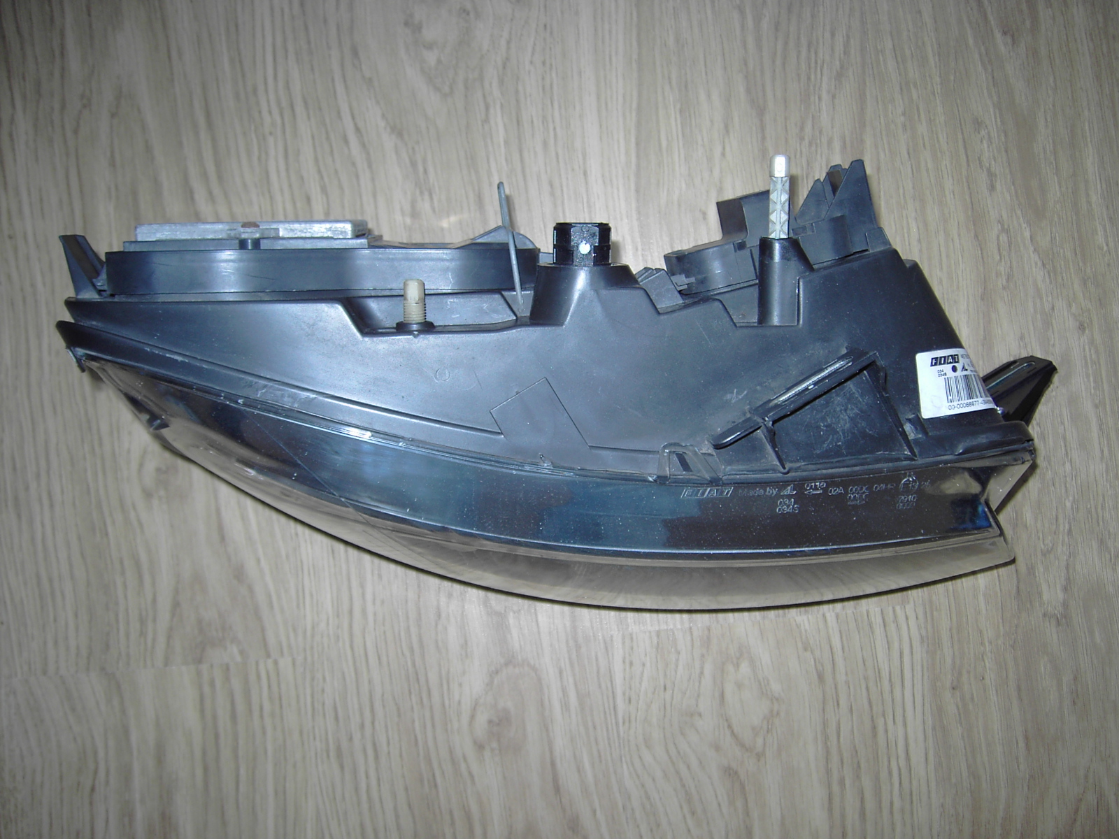

pictures please....please:bang::worship:
Have a look at the back of your light units. You can't miss them (y)
Not the best pic, but you can see the white adjuster on the back of the headlamp unit on the right.
Jon.
These may be easier to see.
The square aluminium ECU/Igniter will only be fitted if you have gas discharge headlamps.

Just be doing these and can confirm the diagram above is correct not the previous post, so it's the outside adjusters that do up & down. Need to remove the battery cover to get access to the left side though.
