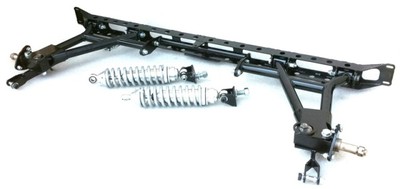

The old Mini had cast iron swing arms each running on two bronze bushes with rubber donut springs. The Panda has steel tube swing arms for less weight but all the stuff added to carry brakes etc is heavy. The basic one sided welding method is cheap but provides all sorts potential for stress cracks. Solution is simple - make it all thicker and heavier so the the weak areas are plenty strong enough.
Performance Minis had a solid tube beam axle with a pair of rose jointed arms each side and a pannard rod for lateral location. All very nice but in the process you lost the boot space and needed a different fuel tank as well. Not exactly practical.
Later people came up with better ideas. A cross beam with cast aluminium swing arms and coil over shocks. There is no ARB on this one and the inner wheel arch needed modifying to make space for the coil-over.
This is what it replaced (also no ARB).
