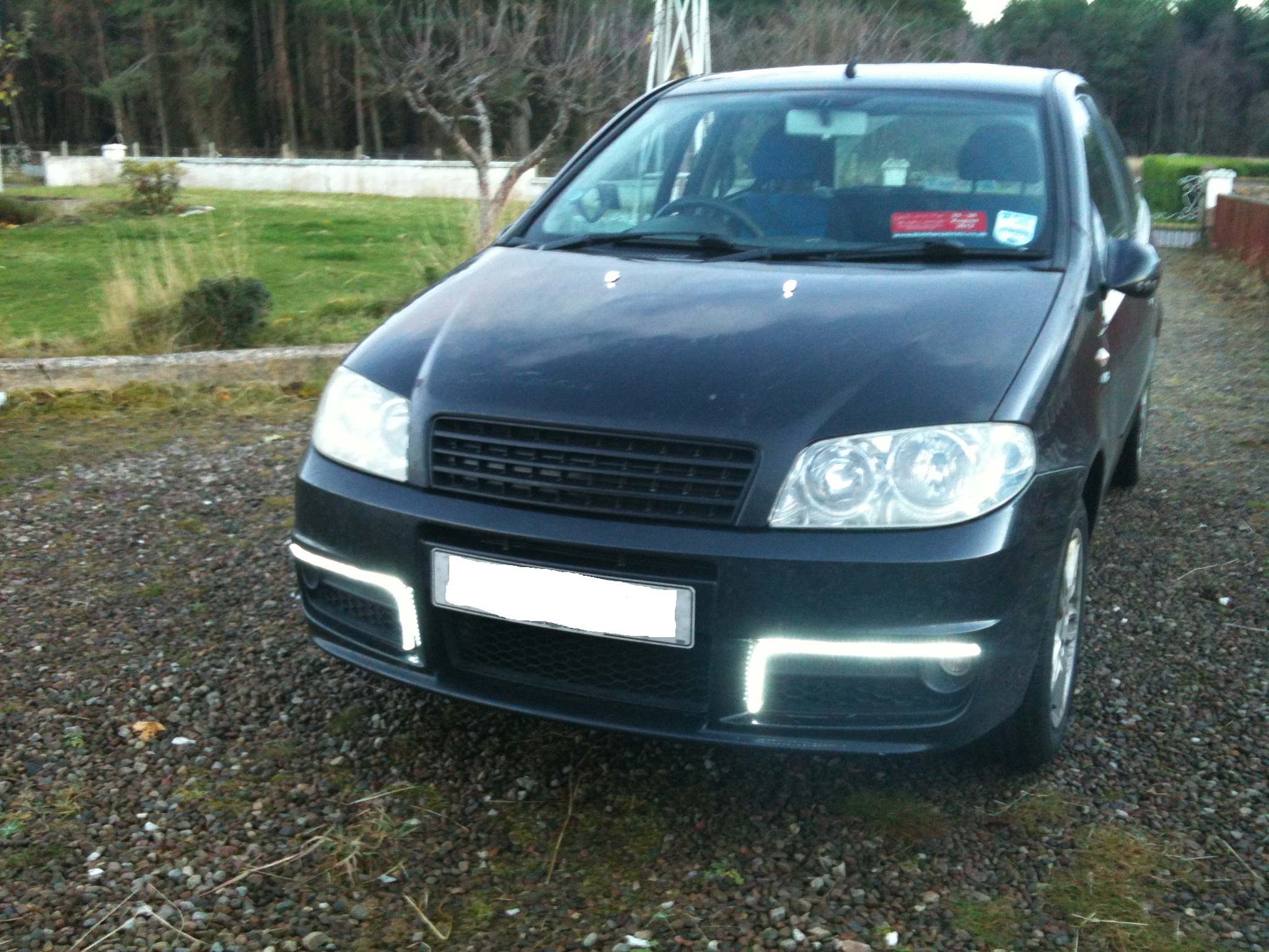

Hi there, I thought it was about time I joined here as I keep checking out the guides and checking out your cars for ideas :D I am 27 and my Punto is my first car, I know I'm a little late learning to drive and all, but I lived in Singapore where you can't drive till 21 and I'm now back in Scotland and I decided to wait till I was past 25 and the insurance started to drop ;)
So what I've done so far:
(I have little money so I will add prices for others wanting to DIY on the cheap ;))
- Ford Focus Induction Kit (£25) 60mins or so to fit
- Chromed the dash (£1 silver paint) 50mins. to take out mainly
- Replaced the Mirrors with black DMT ones (£15 from Bodykit.ltd) 6hrs+ horror to fit, Punto mounting plates provided didn't fit so had to cut/shape to fit
- Debadged Grill (£32 from eBay) 30mins to fit
- DRL strip of LEDs (£12 eBay) 4hrs to fit for wiring and the LED strip didn't stick well so used cable ties to make sure they can't come off.
- Chrome Window washer Jets with white LED (£5 eBay) 15mins as wiring already in place from DRL strip.
- Sport Tyres (H type) (£42 for front 2 on eBay) Got them fitted
- Mutant Bluetooth USB/Aux car stereo (£30 eBay) 6hrs+ to fit as I didn't have the right cables/adapter kit
- Front Speakers (Work in Progress)
- Fiat 100W Subwoofer (Work in Progress)
Plans:
- Rear Speakers
- Alloys
I've take a few pictures on my phone a few minutes ago, so quality isn't super, but more and better ones to follow.
As you can see in the picture of the Stereo there is a switch on the left, this is to switch off the Stereo as I didn't want to go through the trouble of wiring it all to ignition/cigarette lighter. So this is an easy way to stop the battery running dry ;)
There will also be a matching switch on the right over the next few days witch will allow the DRLs+washer jet LEDs to be switched on and off (I only put the DRLs in yesterday :D)

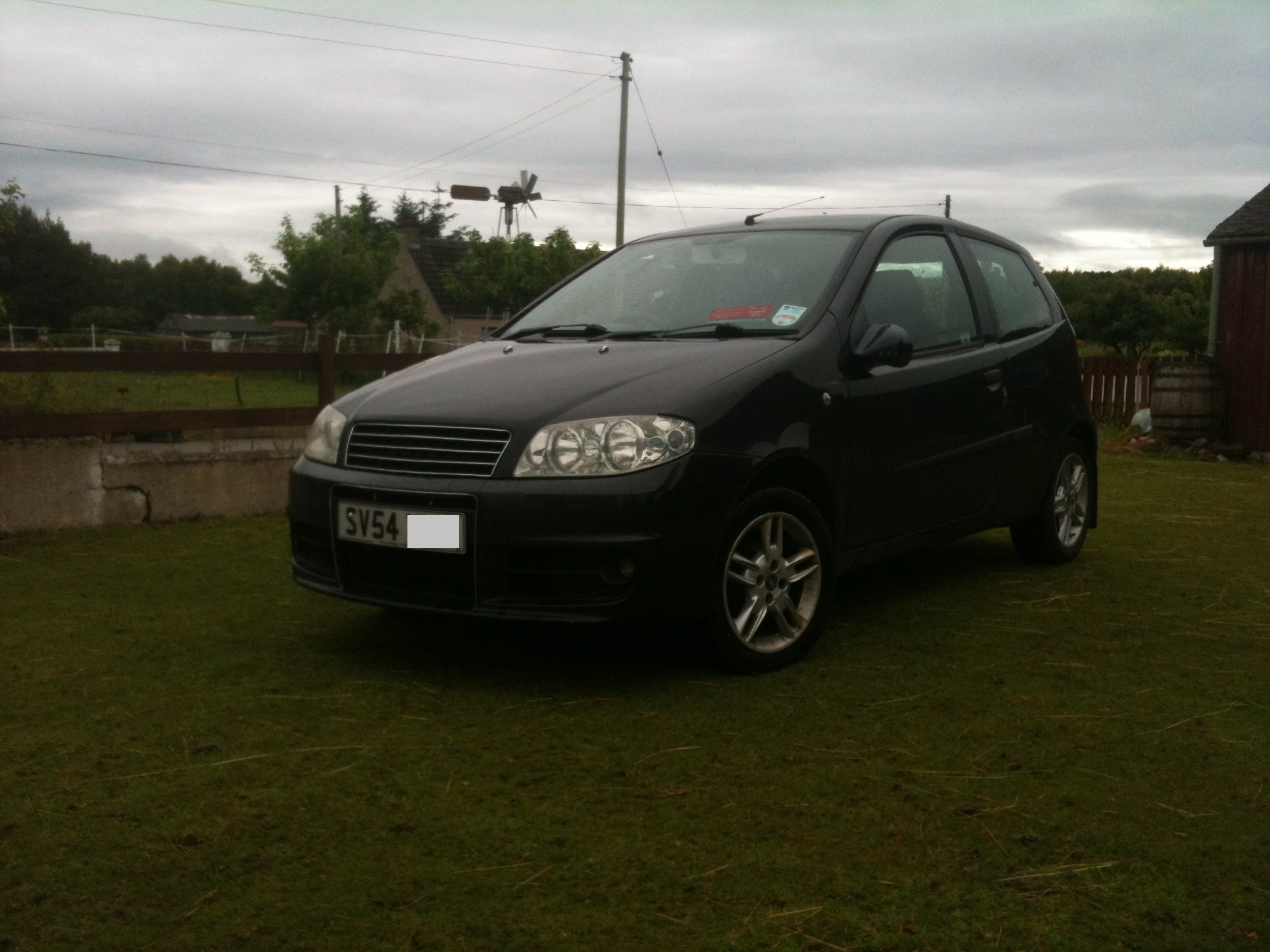

Not had a chance to be on here, very busy with work, so time for A big update:
One of the LDRs got water damaged in the winter months so I changed the layout to just a single one in the centre just below he hood. Looks nice I think.
I'm in the process of installing the 100w sub, I ordered a connection cable from a scrappy and finally figured out the wiring.
Ordered a 52mm Gauge and a double pod holder that attaches to the driver side pillar, the one I ordered was meant to be for a Punto but it didn't fit at all, so ended up completely reshaping them and broke one in the process, and then came up with a much better design and position I think for just a single pod.
I also chromed the front of the car looks very sweet, now going to chrome the rear and maybe redo the outline round the front in slightly wider chrome.
I debadged the sides (the Active Sport badges), I used a wallpaper steamer, which worked really well, a few minutes to heat up the steamer, stick the pipe on the badges for a few seconds and they peel of by hand!
I've changed the back to display Punto Sport (using the sport bit I cut of the Active-Sport badges that I debadged from the side repeaters :cool: )
I have added Fiat Mudflaps to the rear, looks very sporty! I have ones for the front but think I'll just leave them as it looks really nice as it is and front may overdo it. Think someone else somewhere in post on mudflaps said the same.
I did have a big problem as my exhaust is right behind the right rear wheel and so with the mudflap attached there is only a 20mm gap or so between the flap and the exhaust exit. RESULT: warping and nearly a hole burnt through the flap.
Anyone else faced this problem and have a solution? Obvious would be to move the exhaust, but I'll do that when I need a new exhaust which will be in a few months I think.
So for the moment I have screwed a Mild-Steel plate over the part burned/melted mudflap area to shield the mudflap from the hot exhaust air.
I've redone all my dodgy engine bay wiring, cause as someone commented it looks like a lot of green spaghetti everywhere and asking for trouble. I've rewired so there is a lot less wire, and now fed all my LED wires through the hole/rubber grommet where the bonnet release cable also enters the engine bay and into the fuse box on the drivers side and then to switches on my dash. Which also gives a great hookup for any future wiring.
