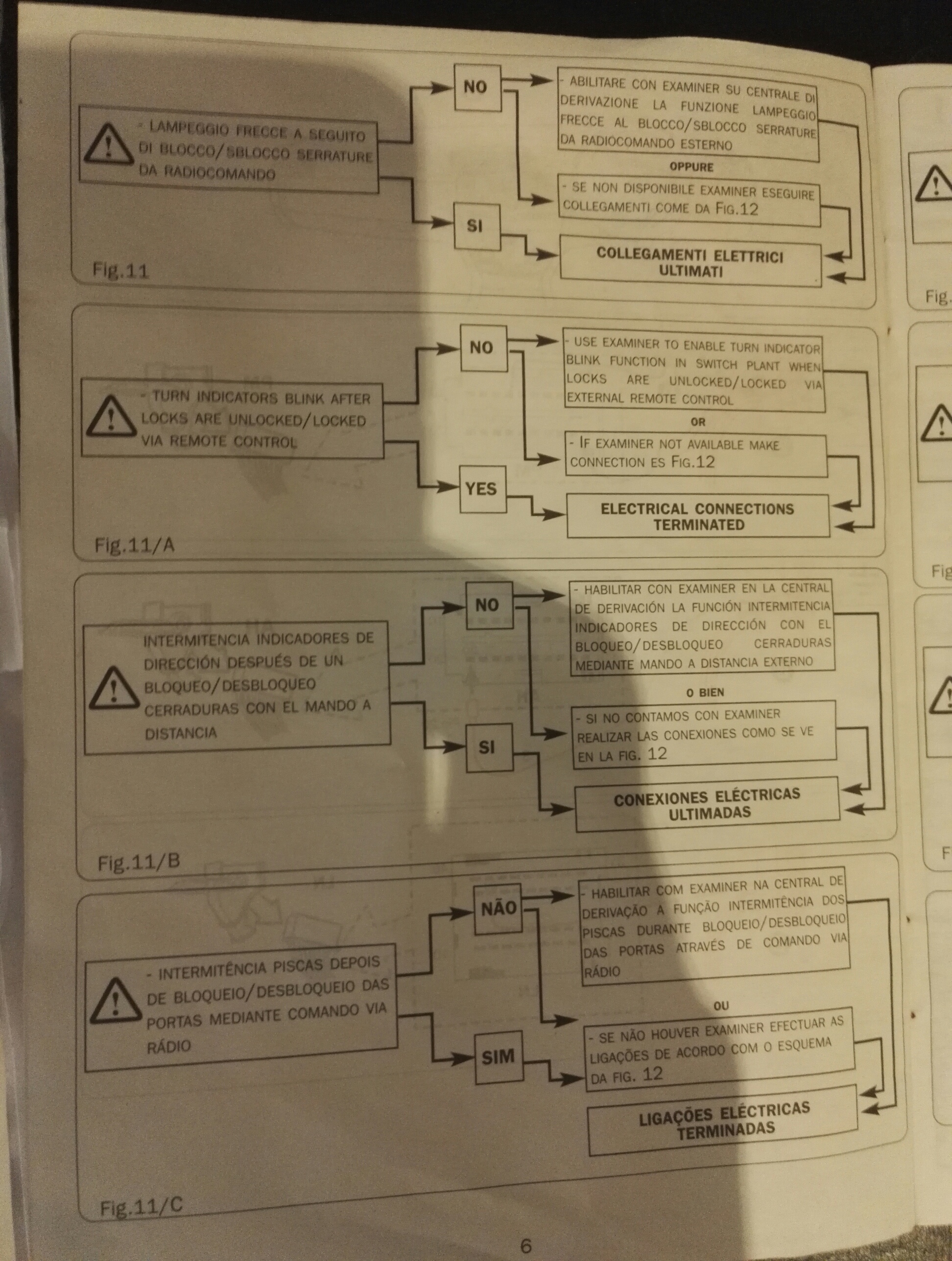

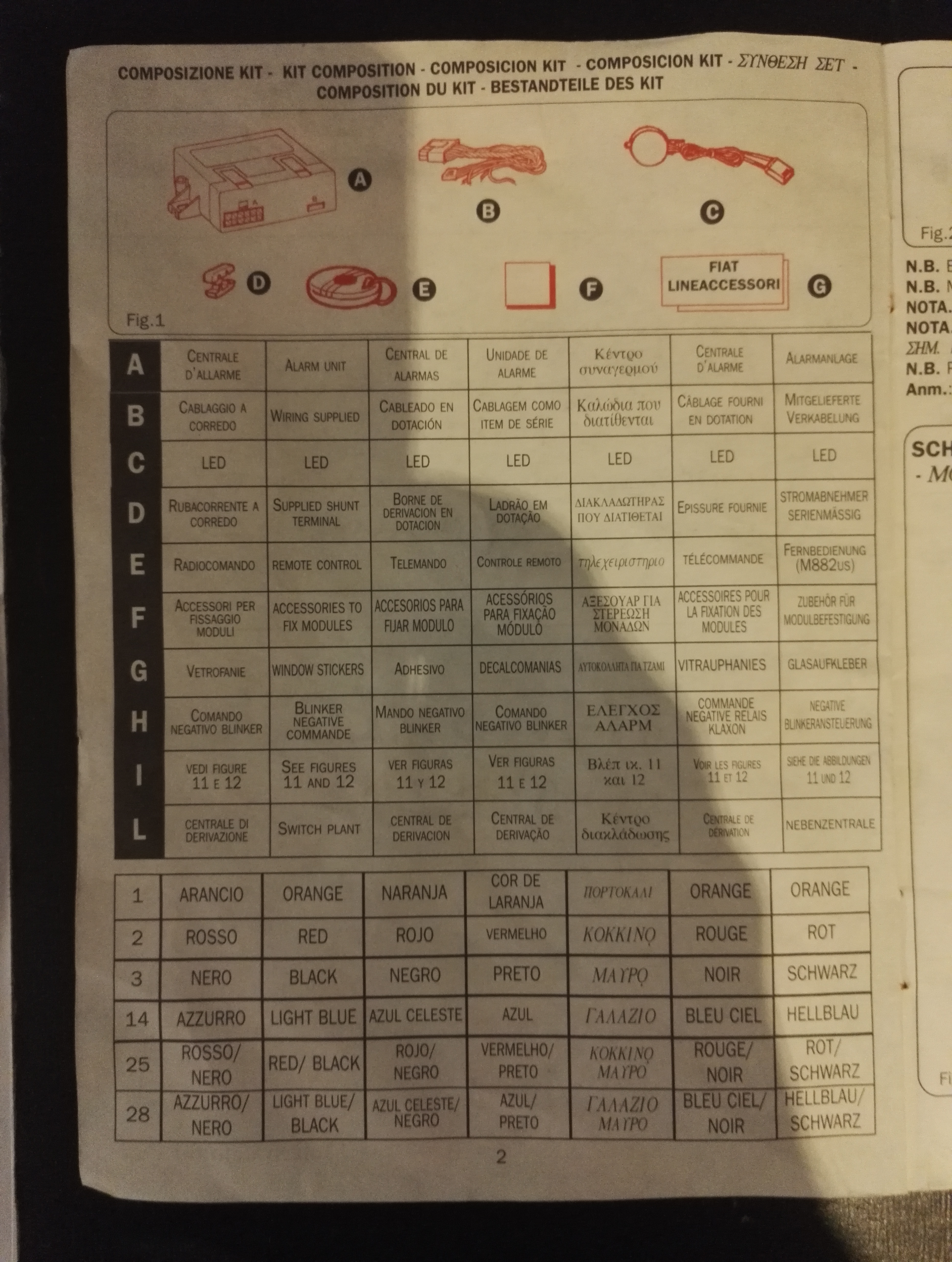

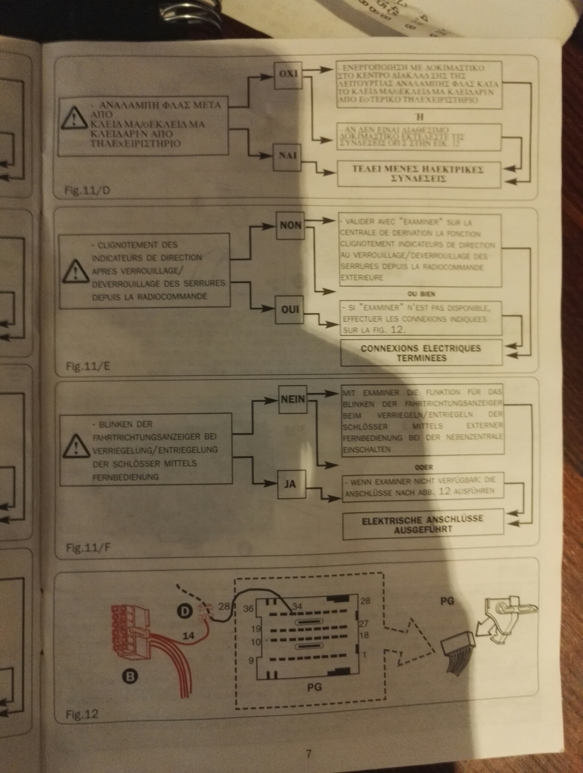

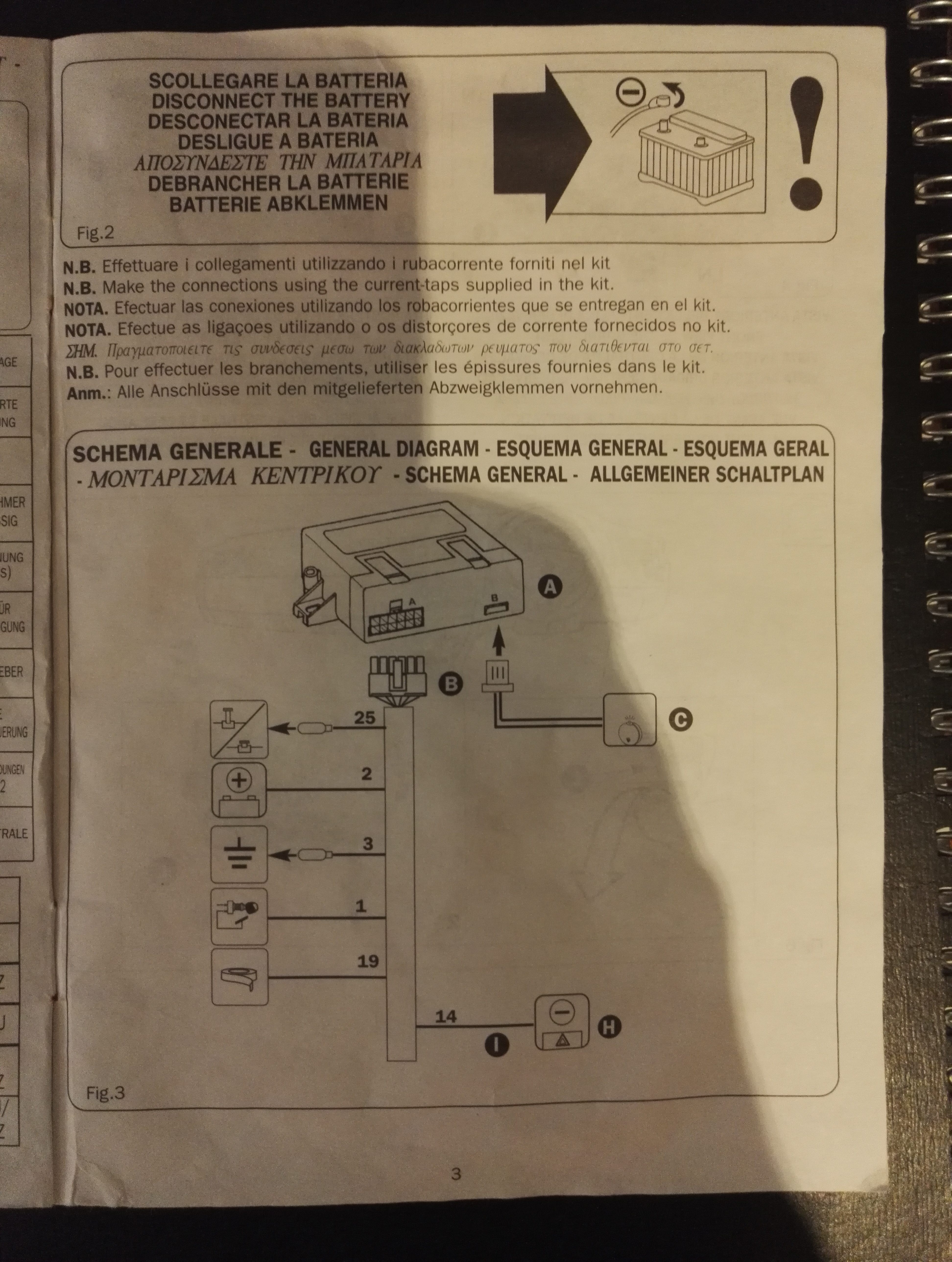

Thank you for the quick reply. I uploaded some pics from the instruction manual. Hope that helps. I think i need to check it with multiscan. I have it and the cables:)

Thank you for posting the manual pictures.
If I was in your place, I would try to scan the body computer using the multiecuscan and see whether it reports a new unit. This meta system should be recognized in can network. Please let us know your findings once you complete this.

I bought just the same one and I am kinda confused with the wiring diagram, especially I do not understand fig.8 (which wire is where) and I also think that there is a missing picture for fig.11; can anyone explain me those numbers per wire?!
