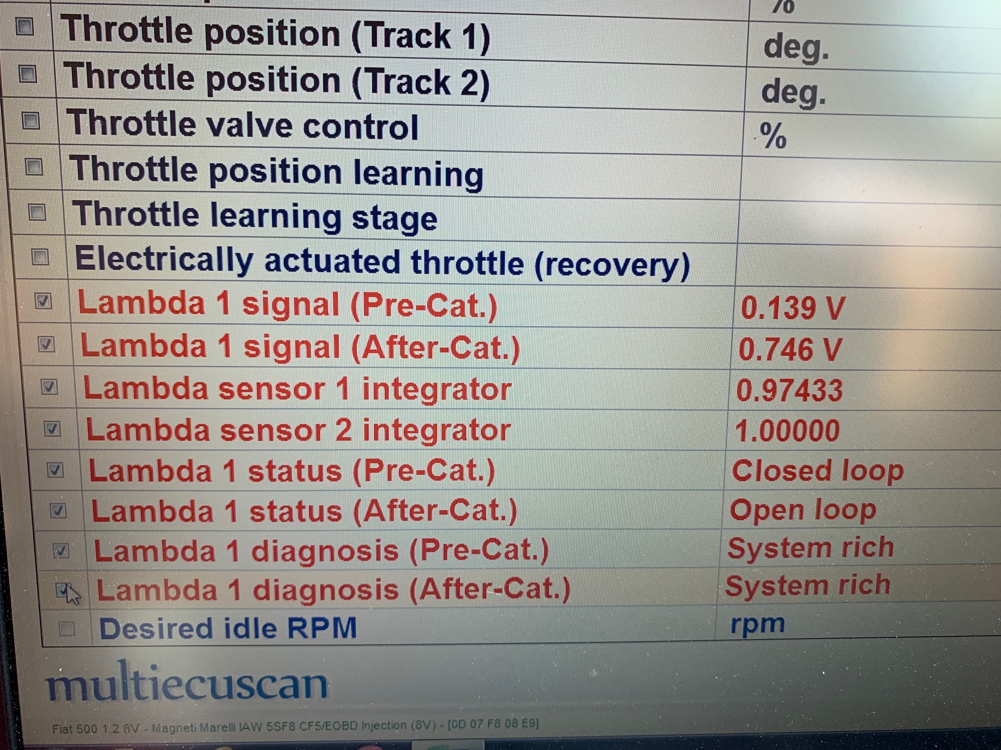

Readings on MES on the engine while it's running show that the pre-cat lambda has a closed loop and the post cat has an open loop. This has been like this at cold start and when normal running temperature.

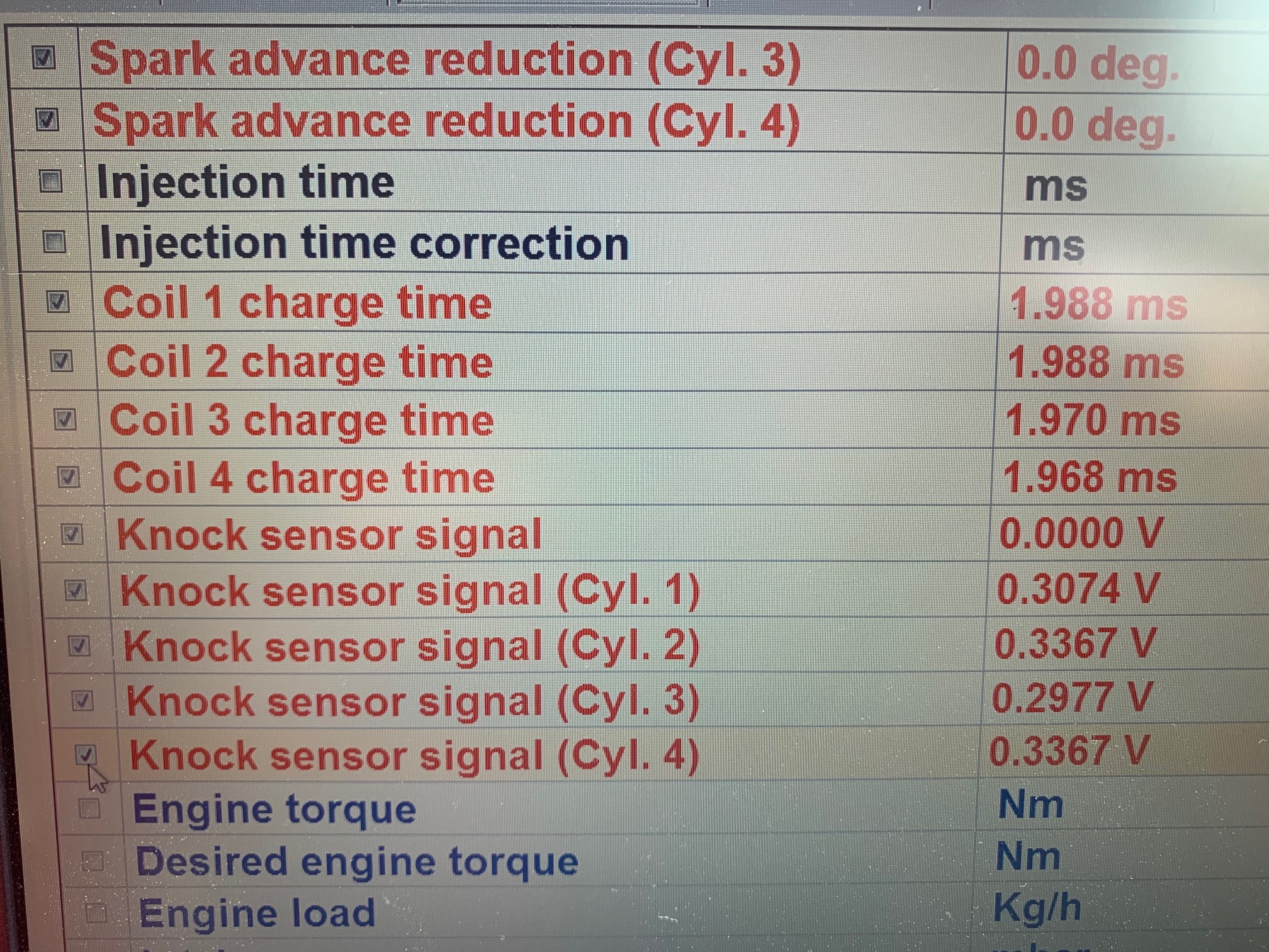

Knock sensor also shows 0.0V. Would this be right?
System is shown rich on both Lambda's in the attached picture but this was just after starting. Now it's at temperature, pre-cat is showing lean but post cat is showing rich. Am I right in thinking this isn't right?

Regarding your O2 sensor values. The values shown when on open loop are of no great interest in this case. Once she's warmed up (I like to go for about a 5 mile drive so not just water but oil and everything else is properly heat saturated) I would be graphing the sensor outputs. So, as you may know? to graph the Pre Cat sensor output, click to tick the box in the Pre Cat sensor value you are showing in your illustration and then go to the top menu and click "Graph". The sensor output will now be displayed in real time and it should be switching between about 0.1 volts to 0.9 volts cycling around one to two times per second. The absolute values may not be quite as I state so say 0.2 to 0.8 would certainly be acceptable. Now lift the revs to about 2,500 and you should see the frequency increase - ie, it should switch faster, more times per second. A poor sensor will give lower output values and/or is likely to be slower switching.
The post cat sensor value can be read in the same way but now you will expect to see a more or less constant output if the Cat is doing it's job properly. A high reading (rich if you like) is not unusual if you have a good Cat. This is because the O2 sensor is looking for oxygen. If the Cat is working well it will be using any free (unburnt) oxygen in the exhaust gasses to help converting residual gasses to Carbon Dioxide and water. So, because the sensor sees little oxygen it sends a high (rich) signal and the graphed line is straight because the Cat is removing mixture fluctuations which the pre cat sensor is subject to.

So, long story short, Pre Cat sensor output should oscillate between around 0.1 and 0.9 volts with a frequency at tickover of around once to twice per second, getting faster with increased engine revs. Post Cat sensor should be straight line - although you might just induce a bit of a "blip" if you give the throttle a vigorous "stab" and a high voltage (tending towards the 0.9 volts) might be expected if the Cat is fully up to temperature and in good working order.

When it's showing "rich" on closed loop on the Pre Cat O2 on diagnostics, it actually means the engine is running lean and it's adding fuel to trim it out.
The Post Cat readings are a bit stranger as it's output/readings change as the Cat heats and cools and as it's never likely to be tested at the same temp twice, you never get a reliable figure to compare.
