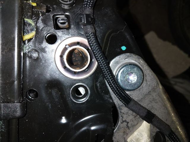

Next stage is to undo one of the Torx screws in the seat back; if you do the side away from the seat release cable it'll save you a lot of faffing. Be careful - the screw is held in with thread locker so will take some force and it's easy to damage the thread. You'll also need to use thread locker when you put it back in:
Once undone you should be able to free one side of the seat base from the back with a little wriggling. Make sure you keep the little white U shaped bits of plastic - they stop the seat back rattling. Remove the ties securing the cables to the passenger's seat base rails.

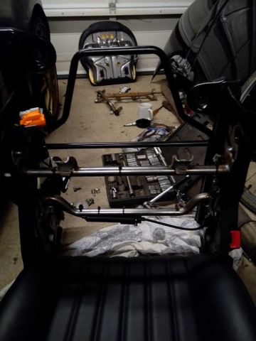

Unbolt the two rails from your passenger seat:
And split the seat base frame after disconnecting any cables. Fit the two rails from the donor driver's seat, and refit the clips to the rear part using a hammer and large socket.

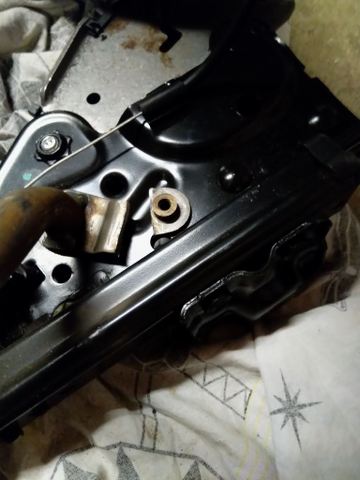

Reassemble the frame, and then there's only one other step (might be wise to do this before fitting the replacement rails) - cutting off a lug which fouls the seat adjuster cable.

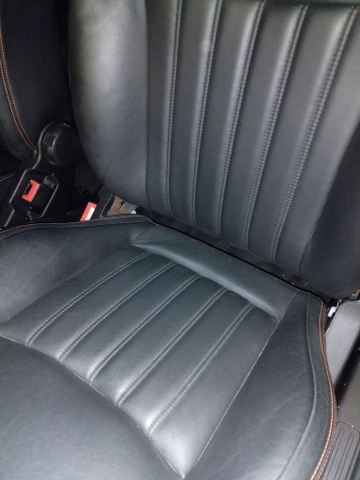

The finished article, gives 4-5cm extra headroom.
