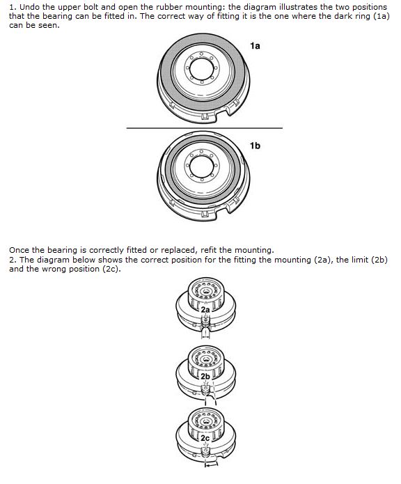

Correct way to do it, is to assemble the shock absorber, spring and 3 parts of the top mounting with the flanged nut tightened to torque. Then fit the assembly to the car and lower the car so it's resting on the wheels. The 2 rubber parts of the top mounting and the shock absorber must be lined up as in the diagram below.

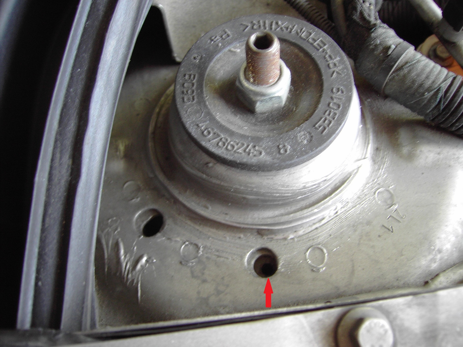

Once fitted to the car, the top nut (nylock nut) should be tightened to torque (4daNm). A 4mm rod (screwdriver?) should be able to freely pass through both parts of the top mounting and the hole in the suspension turret when both wheels are straigh ahead, as in the picture below.
