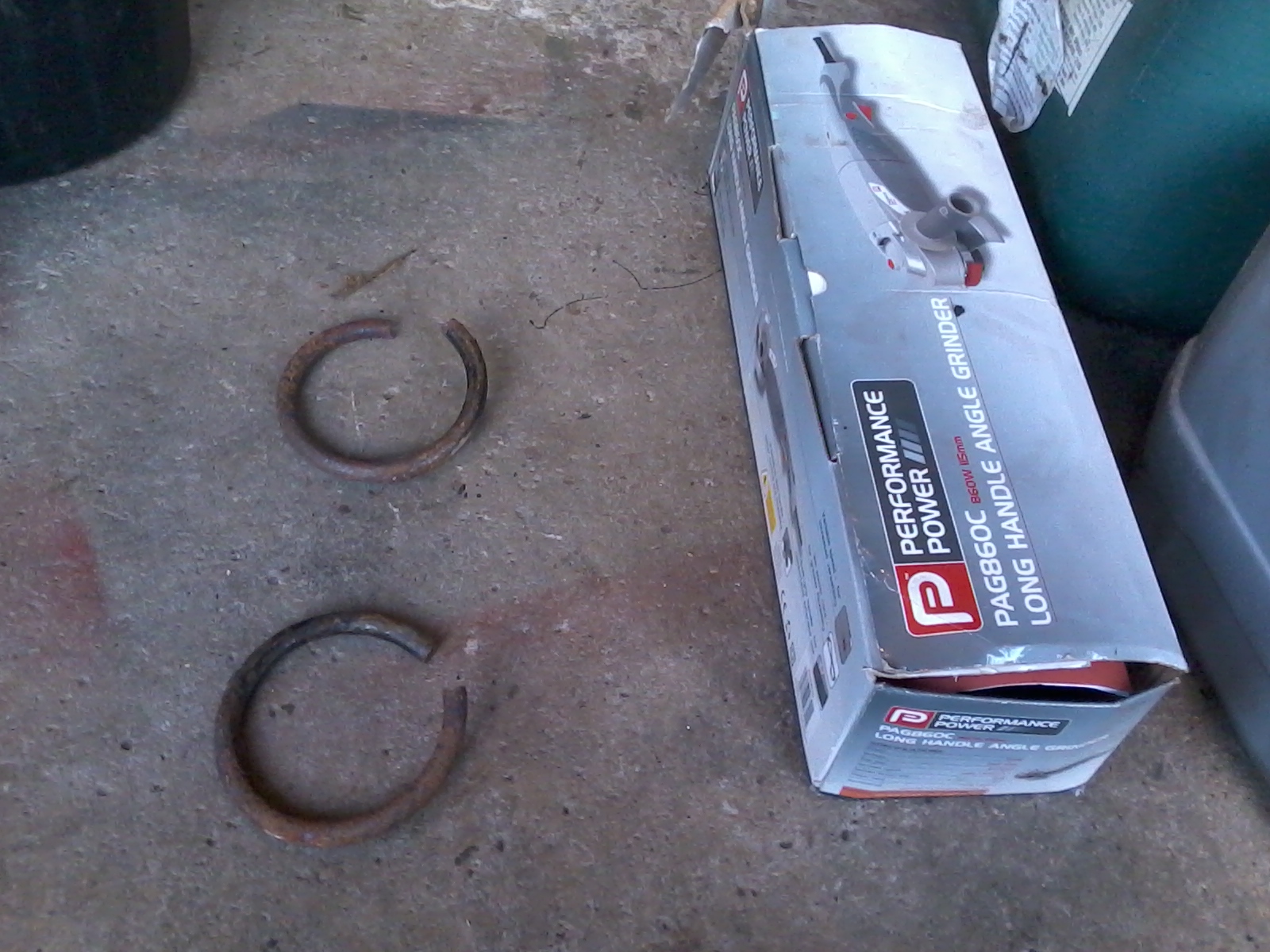

Mine ran cut springs for ooh 10 years without killing anybody at all! Worked fine. Just don't go mad, you can take off, you can't add back on.

Thanks. Lowering the car has to be declared and yes it'll put up the premium, have to be careful who you insure with as some just don't have a box to tick for it. Most insurers will just ask how much the car is lowered by though, under 50mm you're normally OK, but they tend not to ask how you lowered it. The issue with cut springs normally is if they are not seated properly afterwards so they would come adrift at full droop if the suspension is extended on the road. On the Panda you have nice straight springs, no pigtails or anything and pretty forgiving mountings, if they seat OK they should be fine at MOT time. Just don't take so much off the springs that they can flap about when the car is lifted and a lot won't even notice since the car is so high as standard.

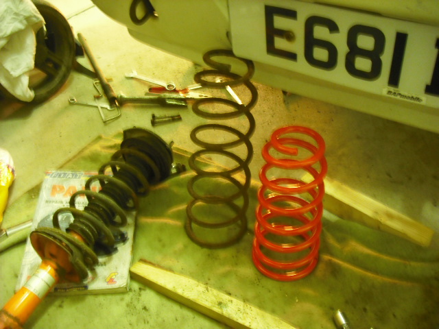

Y10 springs won't work sadly. A Y10s front strut design is different so the front coils are cone shaped. Narrower at the top than the bottom. You can see it in the pic below. Pandas have the same size coils all the way up the spring. So Y10 front spring won't seat properly in a Panda strut top. And you don't want to consider using a Y10 strut as its TRE mounts much lower than on a Panda so you won't be able to steer.
The rear springs would work in theory but spax Y10 springs are a drop of 40mm if I recall wheras Pandas are 30mm so mixing and matching might not be a good idea

Spax Panda lowering springs are 40mm drop.
OP be aware that buying Spax (and possibly other brands) lowering springs results in the back sitting higher than the front (like Panda's do on standard springs)
