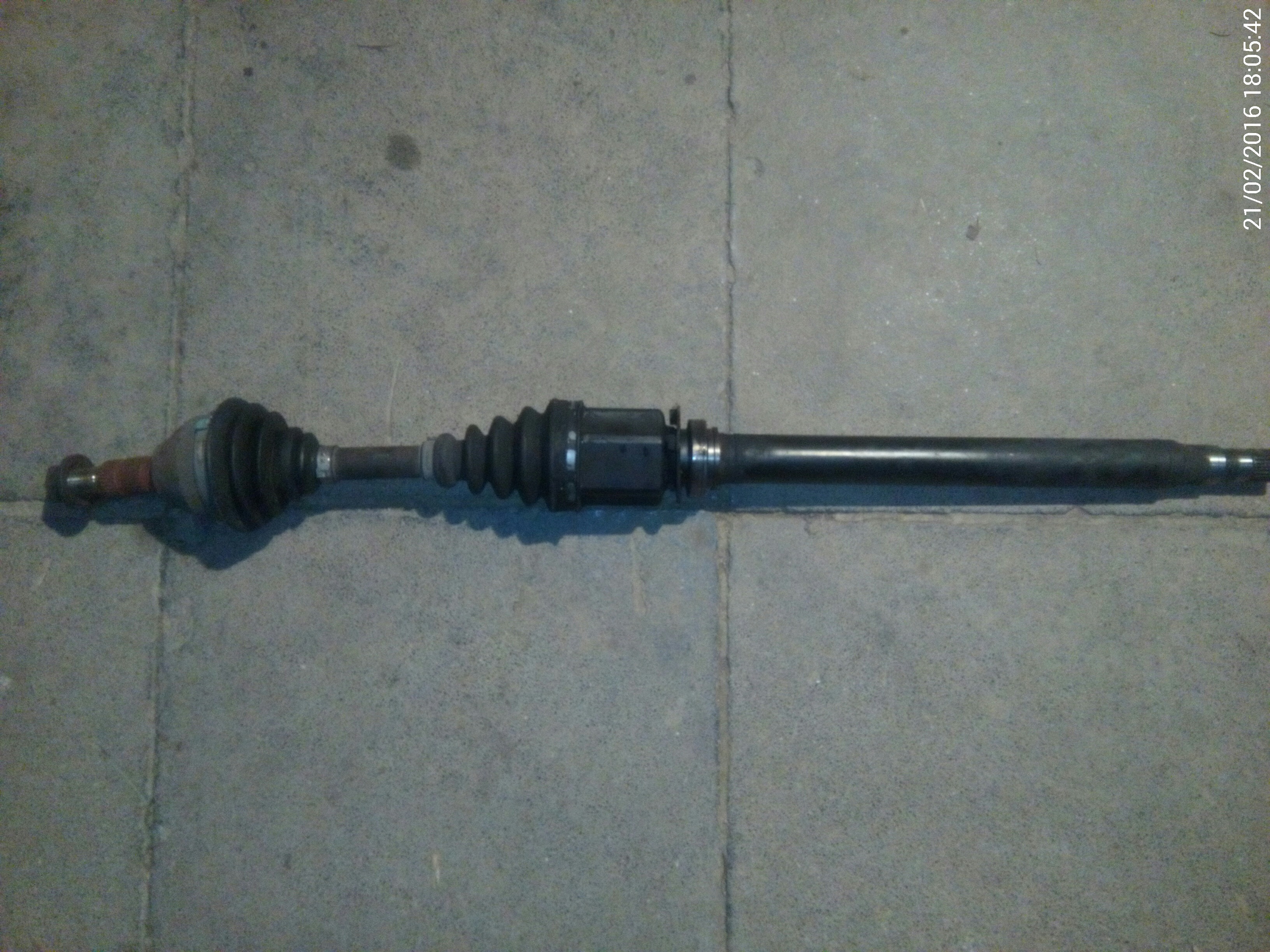

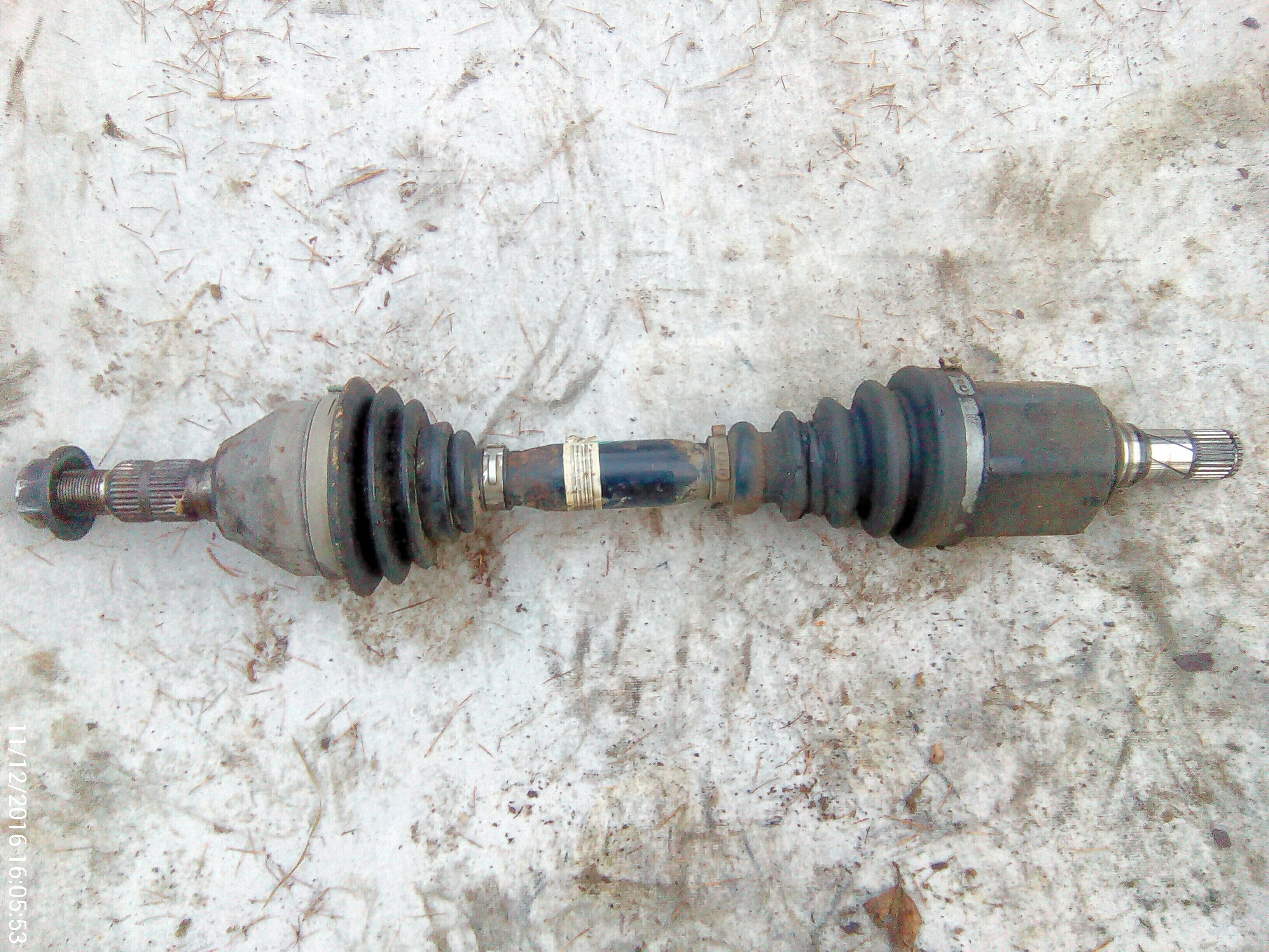

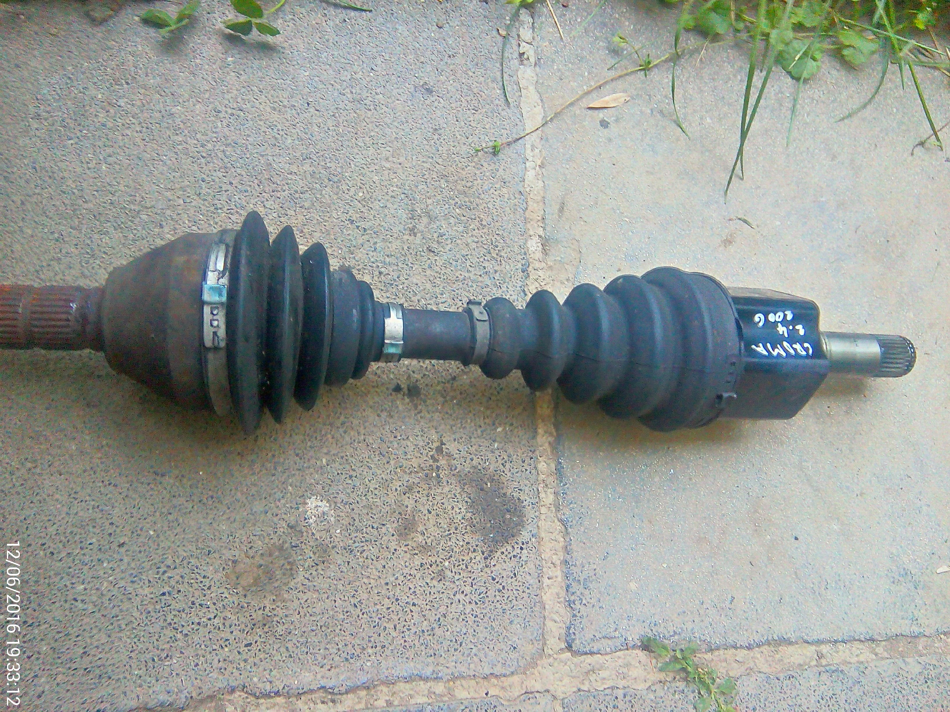

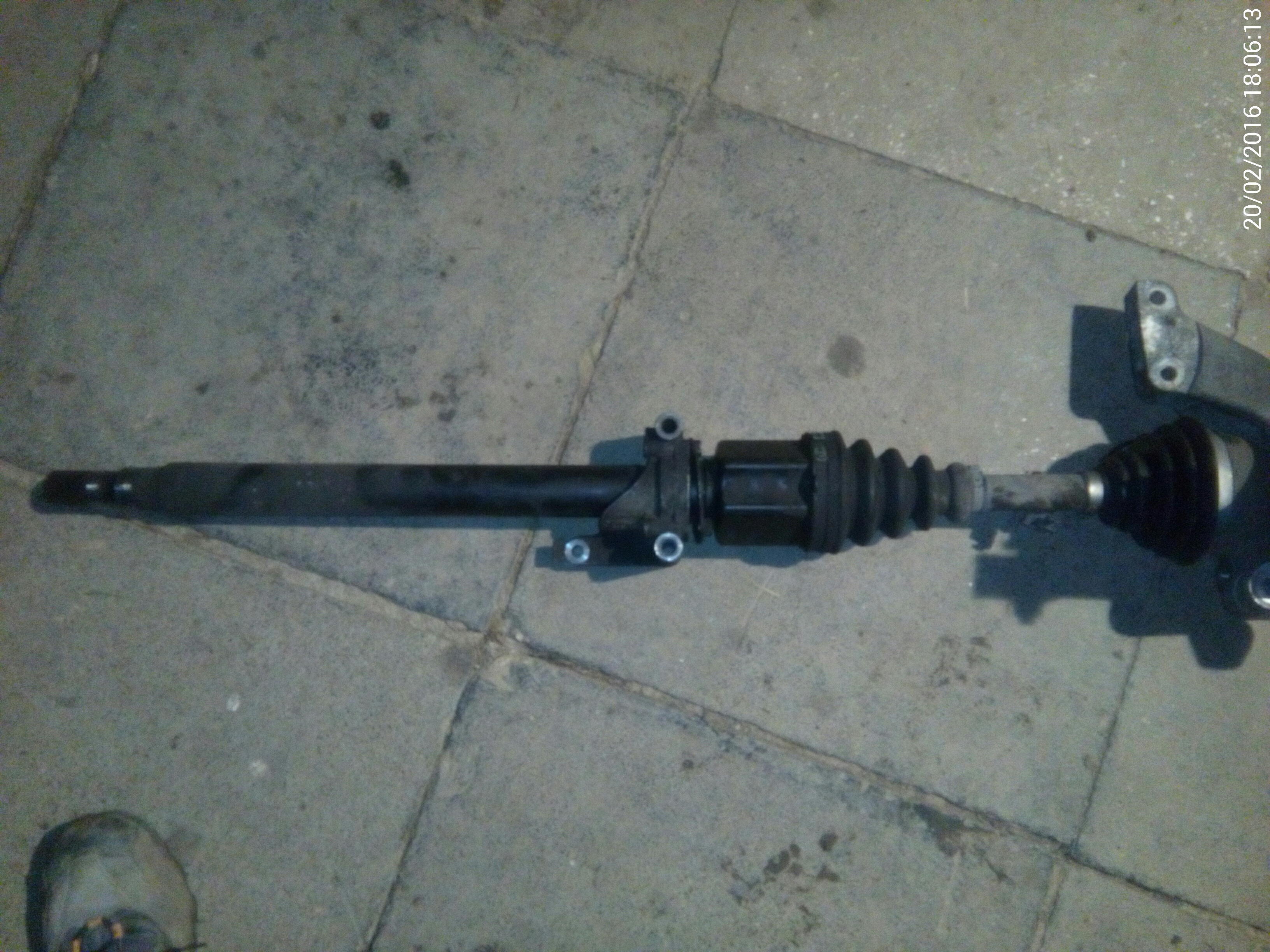

dunno for sure but atleast stub axle is same from 2.4 and 1.9 150hp, so that means outer part is same, dunno about the one that goes inside gearbox
pic below is 2.4 driveshaft, got 1.9 driveshafts too but they are still on the car, cant compare them yet
