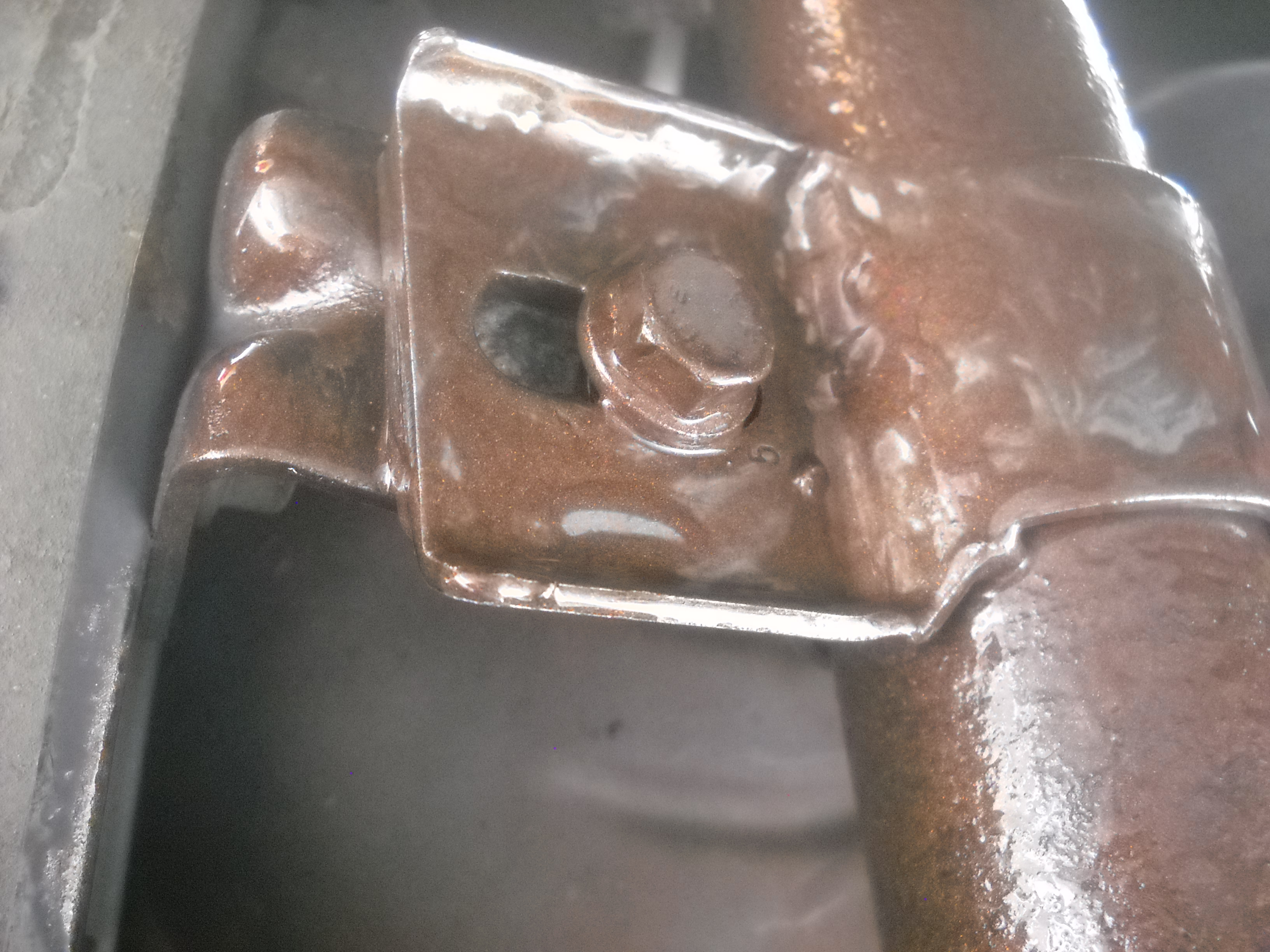

As stated exhaust all brand new but no signs of damage, cracks, splits, peeling finish ,or damaged mountings
exhaust heat shields all in place and mounted properly!- back box, tapped to see if anything loose inside -there is not!.
