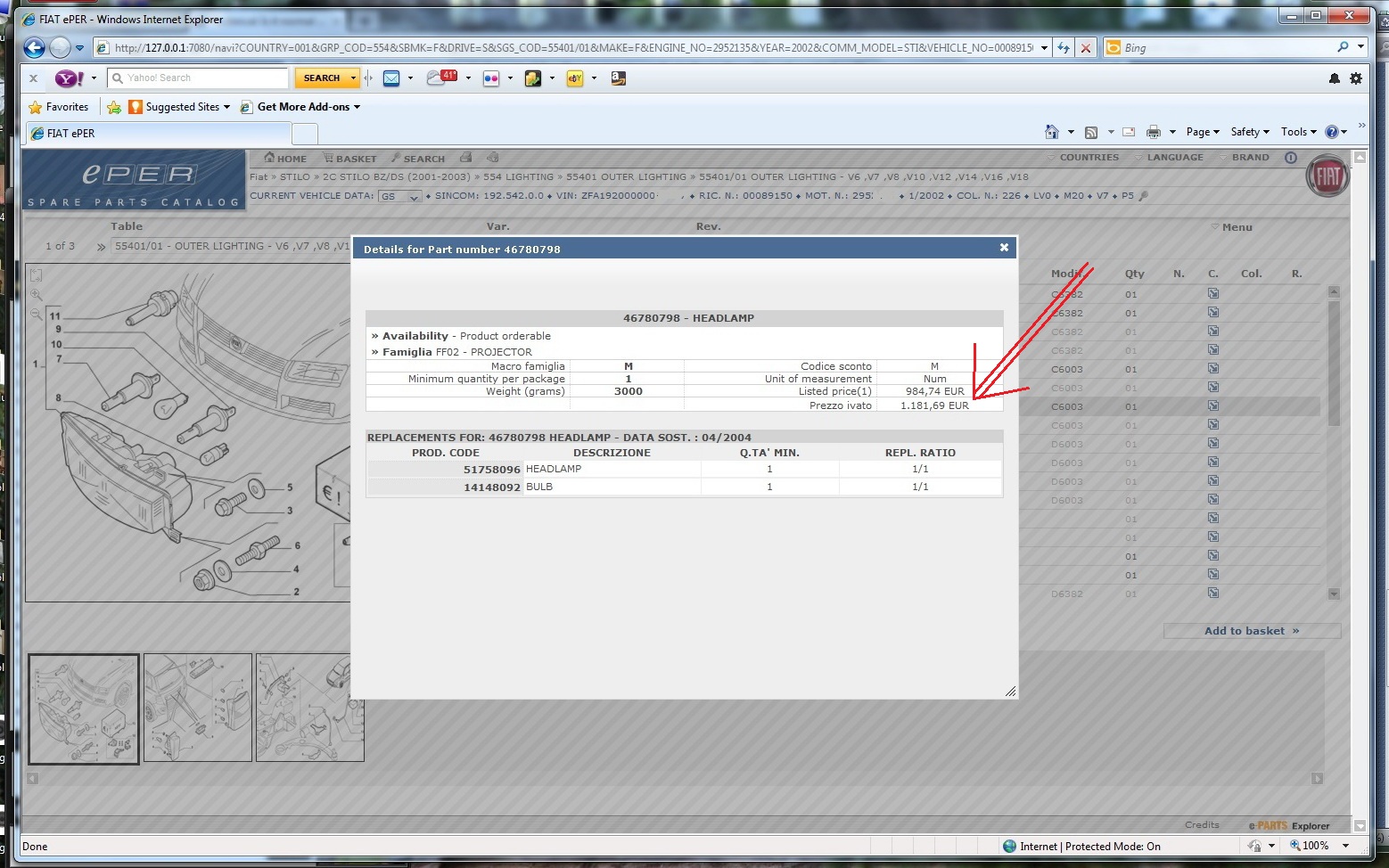

You've been quoted a fortune if you think of how much the car is worth in the UK. Although we have much lower salaries, I still think it's a reasonable price here. The market is much higher in Romania, the country where everything is possible. My car is evaluated at 5500E and wouldn't cost more than 1500 for sure in the UK.
Prices are very high, check the cost of a headlamp :) +VAT!:hug:
