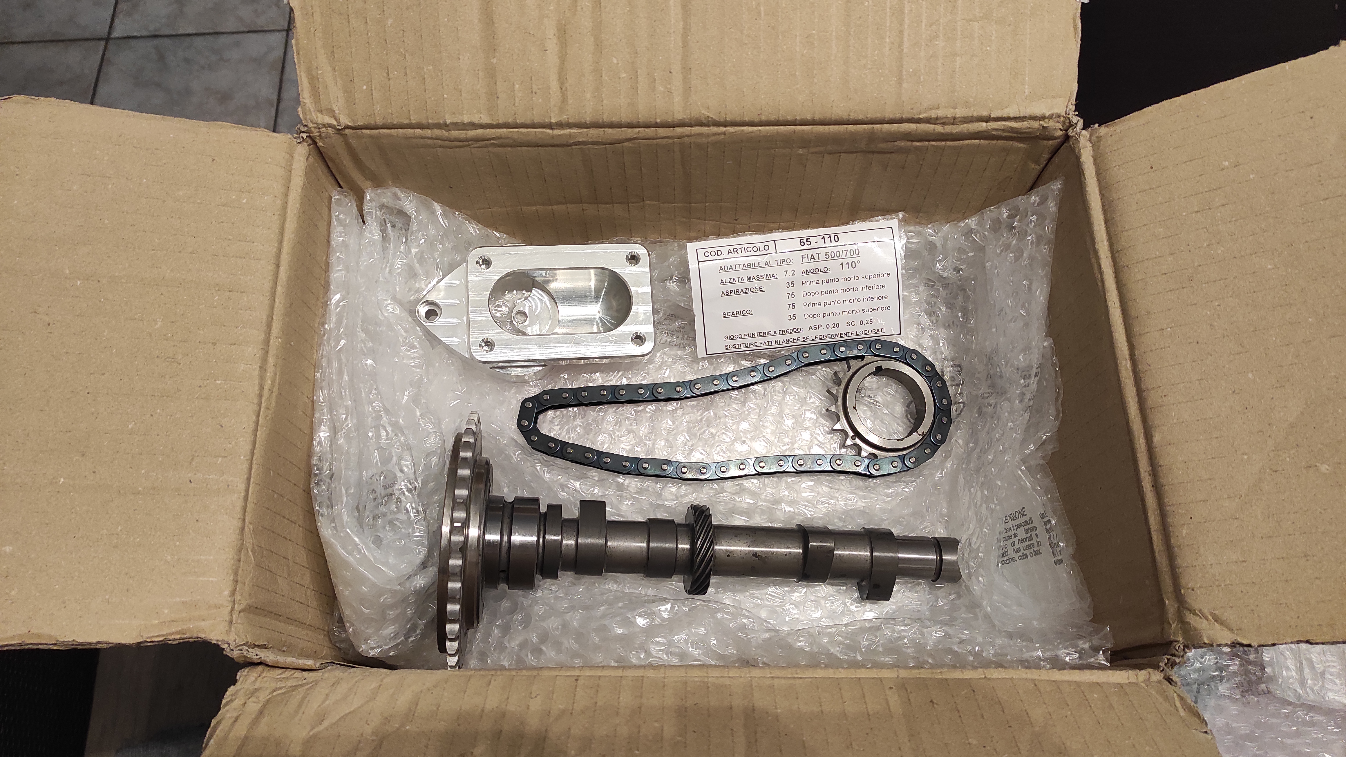

Mail call and 35/75 synced cam is here along with twin Webber mount. Still waiting for other parts and head repair from cracks. Can't wait to put little car back on the road since it is my daily car.
Hi Thomas----the fiddly bit is lining up the timing marks on the 2 sprockets and fitting BOTH the sprockets AND the chain all on at the same time--have fun!
Yes I know, thing is that the holes in the gear are oval and there is no guide to align cam and gear anymore so I wonder if with only the four bolts it is safe without the risk of misalignment during operation. This makes me think how wise would be to mark it, remove it and add a screw at the spare hole that camshaft has.
I am running the 'synched' cam as it came---and so far, no problem. The problem with threading a hole in the 'spare' hole in the camshaft is that (as I have found out) the camshaft material is HARD. The trick with fitting the cam, chain and crank sprocket all at the same time, is to align the 2 sprockets WITHOUT the chain, so you know where they should go. Then, fit all 3 parts together---the crank sprocket will 'fit' first, keep them aligned and side the cam in as you tap the crank sprocket onto the crank. Being serious, it is not as difficult as it sounds. By checking the alignment (without the chain) first of all and getting it all set up, I was (luckily!) able to do it first time--phew!

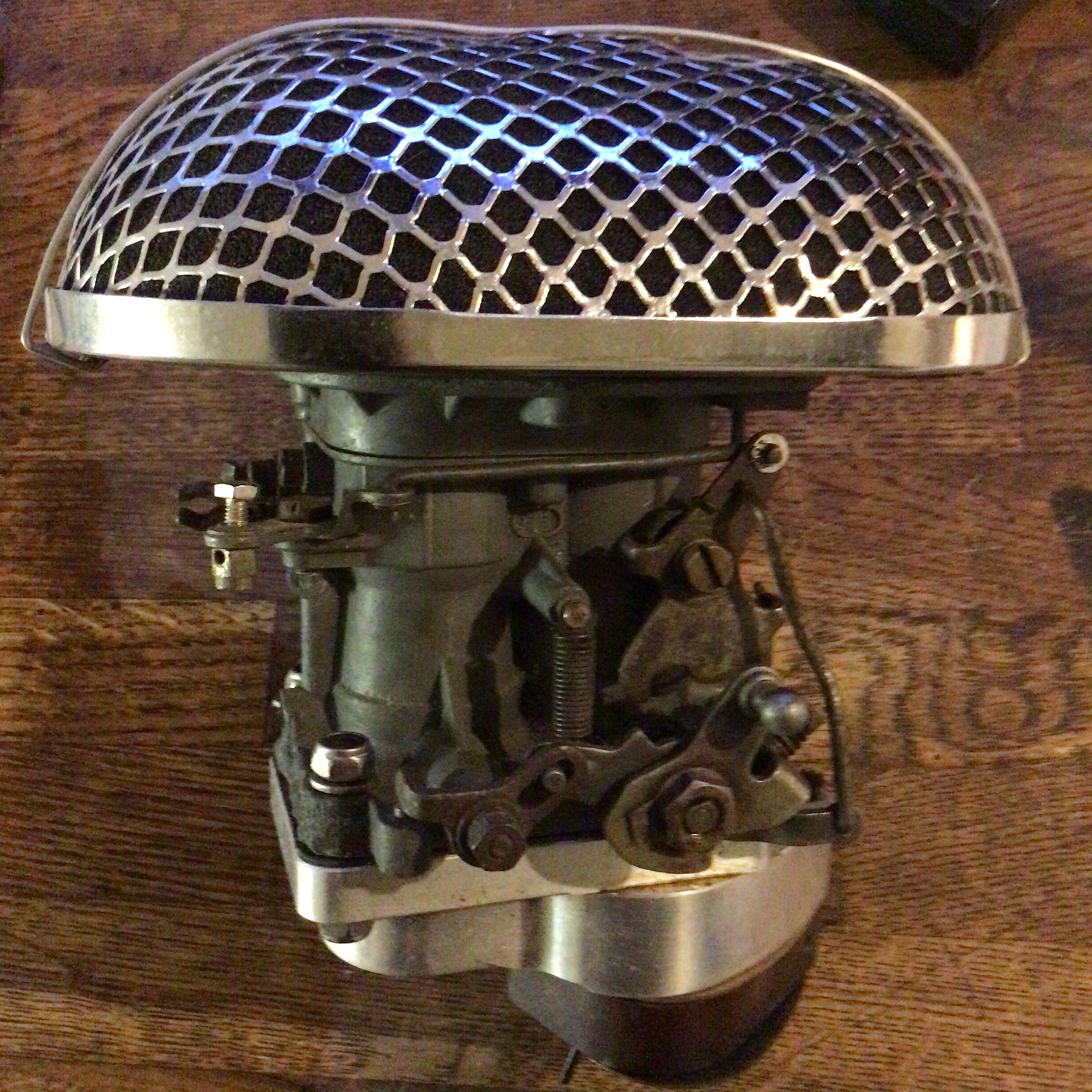

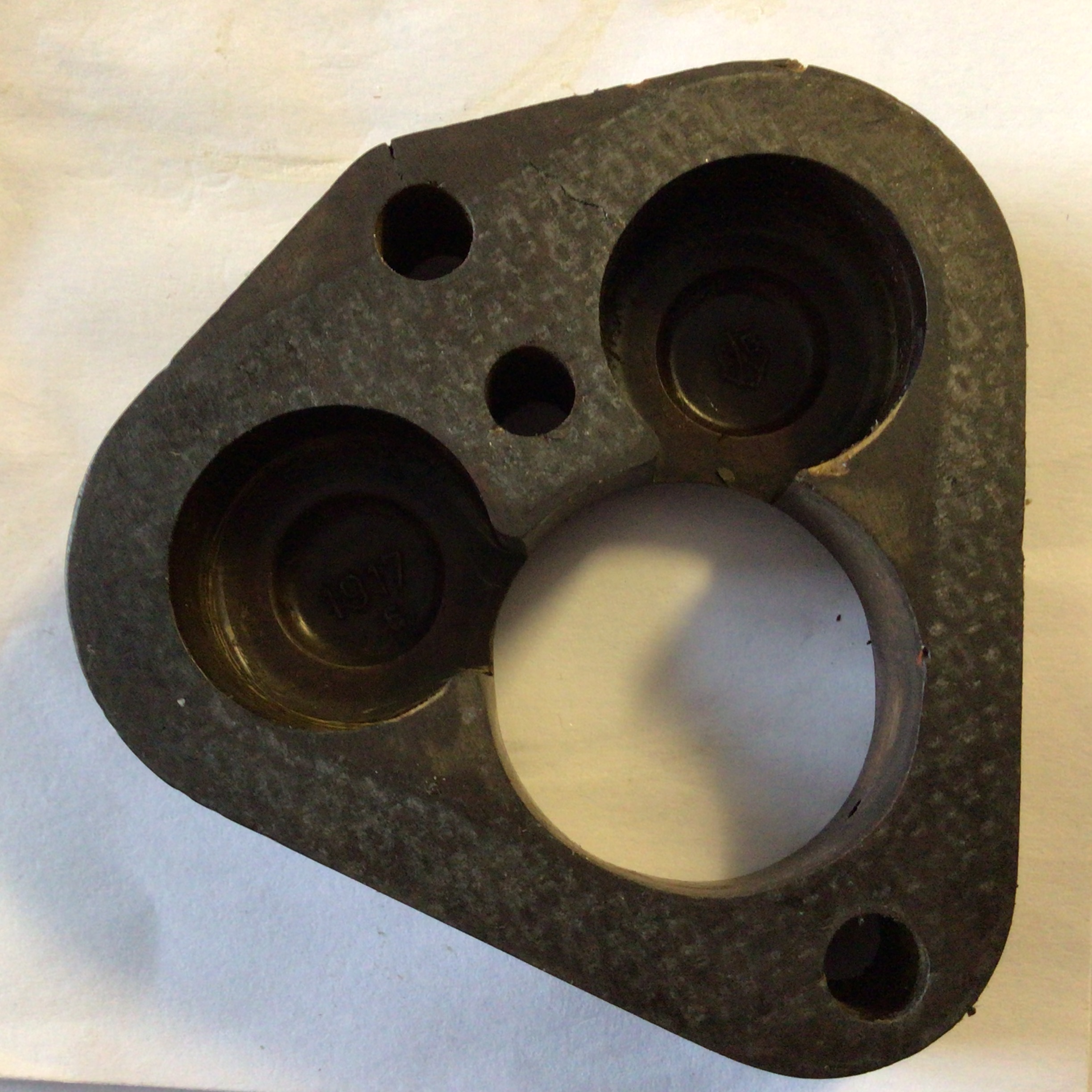

Ideally with that manifold you will need some sort of thermal break spacer to reduce heat conduction especially in the conditions you drive in. The carbs you are looking at were originally fitted with either a plain spacer or a Bakelite drip tray spacer under the carb. Bit of a story but I had a new cylinder head prepped for me by a very talented guy who runs a 100+ hp turbo charged 126 engine that he developed over many years. Apart from porting, skimming and larger inlet valves he told me he could see a further improvement but would not tell me what it was. At the same time I was playing with fitting a Weber 30DIC carb at home. Some how over the years I had picked up a mystery carb spacer I did not recognise. When I offered it up to the base of the manifold like the one you have it was a perfect fit so I used it and it worked well. The spacer was from a Giardiniera. When I collected my new head my pal had machined a similar item from solid alloy.EAEDF3C4-9BC8-4DF4-9229-BBD8A1D16151.jpegB28440FF-C5E6-4192-9179-362625BE1F15.jpeg
Ideally with that manifold you will need some sort of thermal break spacer to reduce heat conduction especially in the conditions you drive in. The carbs you are looking at were originally fitted with either a plain spacer or a Bakelite drip tray spacer under the carb. Bit of a story but I had a new cylinder head prepped for me by a very talented guy who runs a 100+ hp turbo charged 126 engine that he developed over many years. Apart from porting, skimming and larger inlet valves he told me he could see a further improvement but would not tell me what it was. At the same time I was playing with fitting a Weber 30DIC carb at home. Some how over the years I had picked up a mystery carb spacer I did not recognise. When I offered it up to the base of the manifold like the one you have it was a perfect fit so I used it and it worked well. The spacer was from a Giardiniera. When I collected my new head my pal had machined a similar item from solid alloy.View attachment 400836View attachment 400837
Nice tip, thanks i will look for it, but also looking for a Panda 30 weber which i will install only after i break in the engine at 1000 kilometers so i can tell what is the difference with all the other mods before the carb. The reason i am looking for the panda 30 carb is that it is ready to installed with all the jets there. Otherwise i have found a weber 30 dgf 23/23 from citroen gs, have seen at ebay, italians are selling this for 126 tune but then i will have to replace all the jets, something i am trying to avoid.

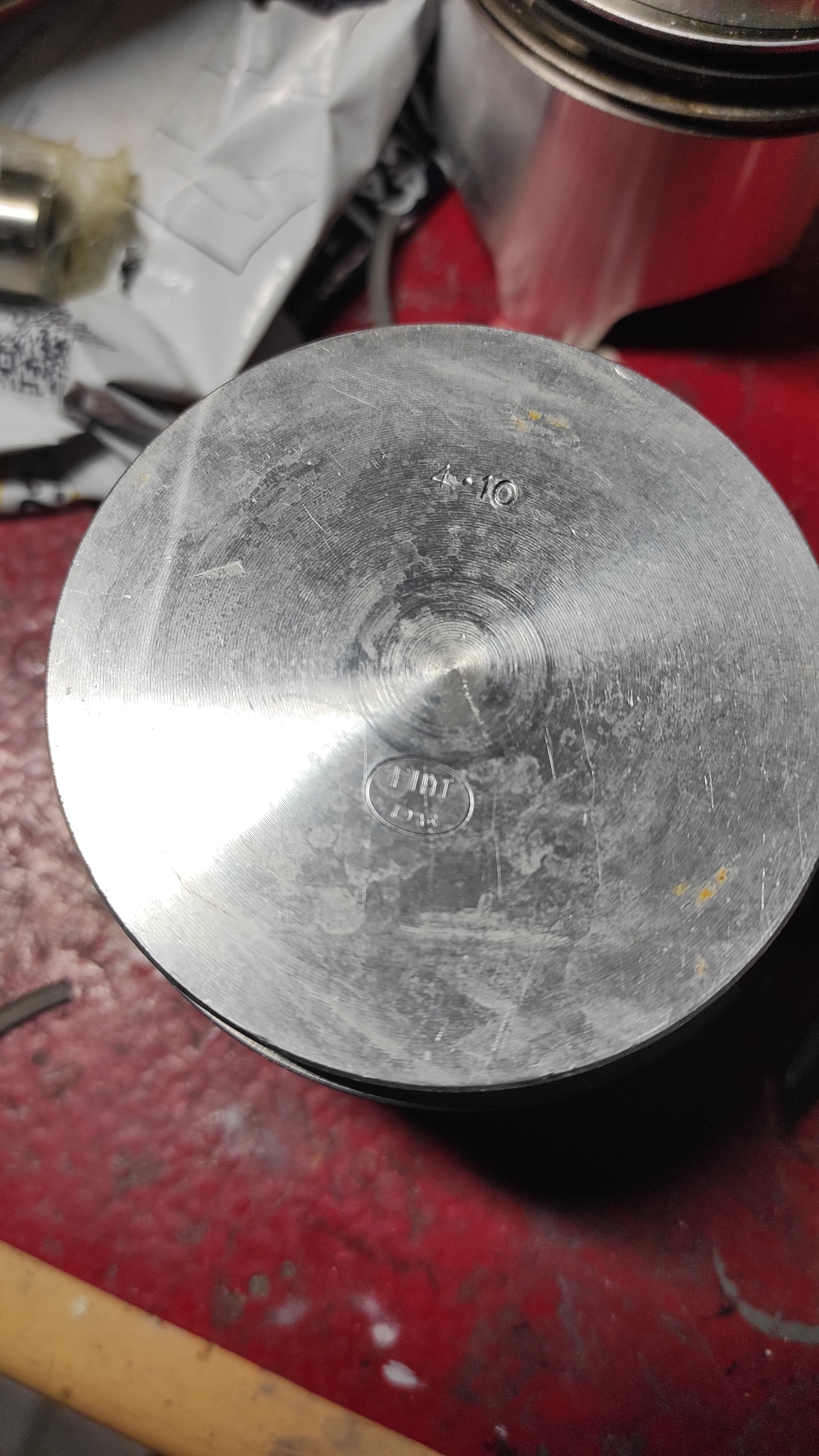

Guys is this piston supposed to be 04 oversize? Because I am measuring it and it is 77.28 more or less but not 77.40 plus that it came with broken ring but that's another story.
Could it be that it's measured in Imperial...that does seem to happen sometimes with engine component dimensions. 0.010" oversize would be 0.254mm.
