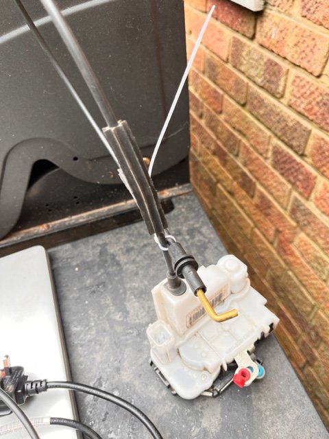

Yes I have got one including the blue and red clips if you want it. They are aroun £20-35 on ebay without the clips. You can have this one for £15.
