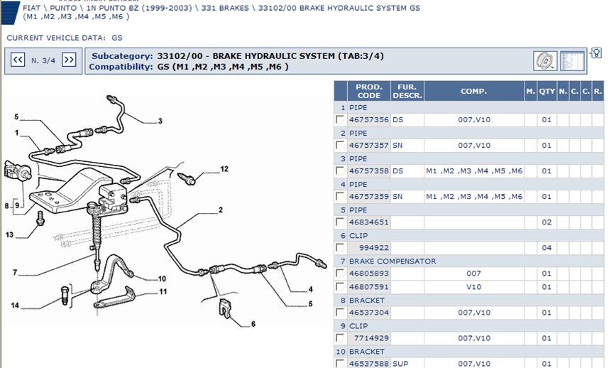

It is a load-proportioning brake valve. Basically, it puts more braking pressure to the rears when you've got a heavy load or adults on the back seat. Item 7 in the diagram...
Wow! That was quick! Especially from my vague description.
Thanks for the response. Is it vital that I get one of these fitted immediately? Is the car safe to drive? Is it a pain to fit myself? Any idea on how much (in a ballpark estimate) to get it supplied and fitted at a garage?
Cheers
