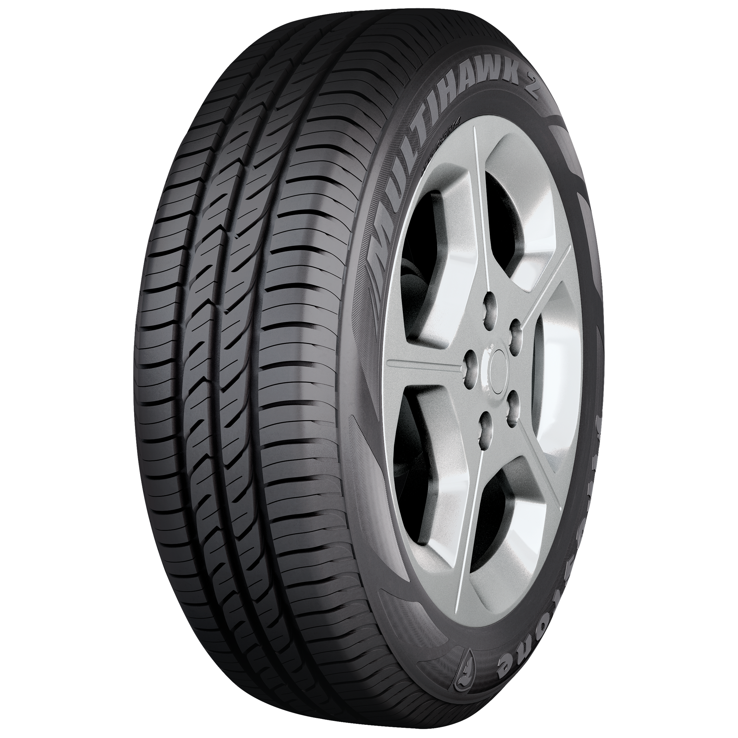

I was looking at ATS Euromaster as they seem to be the cheapest for those specific tyres with the two promotions they have on currently (£26 off 2 Michelin tyres and 10% off weekend fitting).
If all else failed, the next pair I was looking at was:
Firestone Multihawk 2 (165/70 R14 81T) from halfrauds.
https://www.halfordsautocentres.com/tyres/firestone/multihawk-2/165-70-r14-81t-69ec
firestone-multihawk-2
I think the cross climate only comes in a 85t
Which is an all season tyre
(Not a full summer but not a full winter tyre)
Which has advantages over summers espically now its getting colder
The firestone hawks are a summer tyre
So now your looking at a different style
I did have the firestones and i found them alright and much better than crappy toyo 350s i had once....
Ive got uniroyals, one of the best wet tyres you can get these days!
So much so
The mrs has summer set
And i have summer and winters
Very soft for good around grip
Alot of people like uniroyals
Id never hesitate to fit em....
Ziggy
