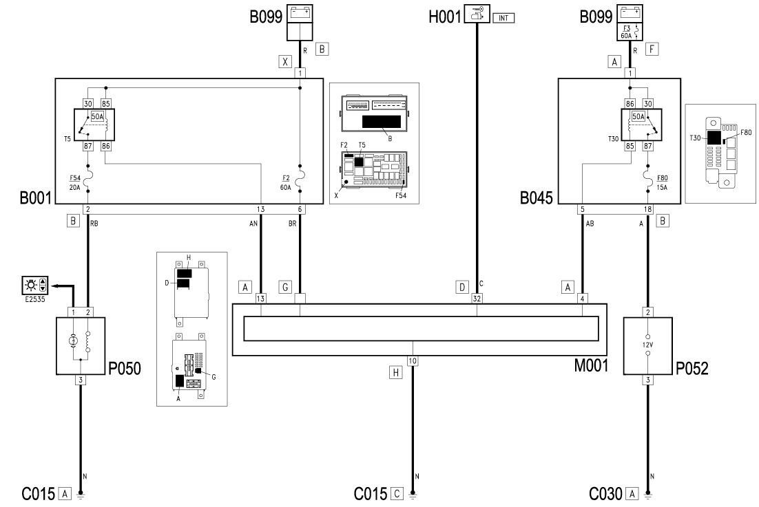

I wanted to use the lighter socket. to charge my phone unfortunately it doesn't work , can someone tell me how to fix it , I couldn't find the fuse , usually it's the same with the radio or lights but both are working
Thanks
Here's the drawing from a Punto, I guess it's pretty much the same on a linea...
BRs, Bernie
