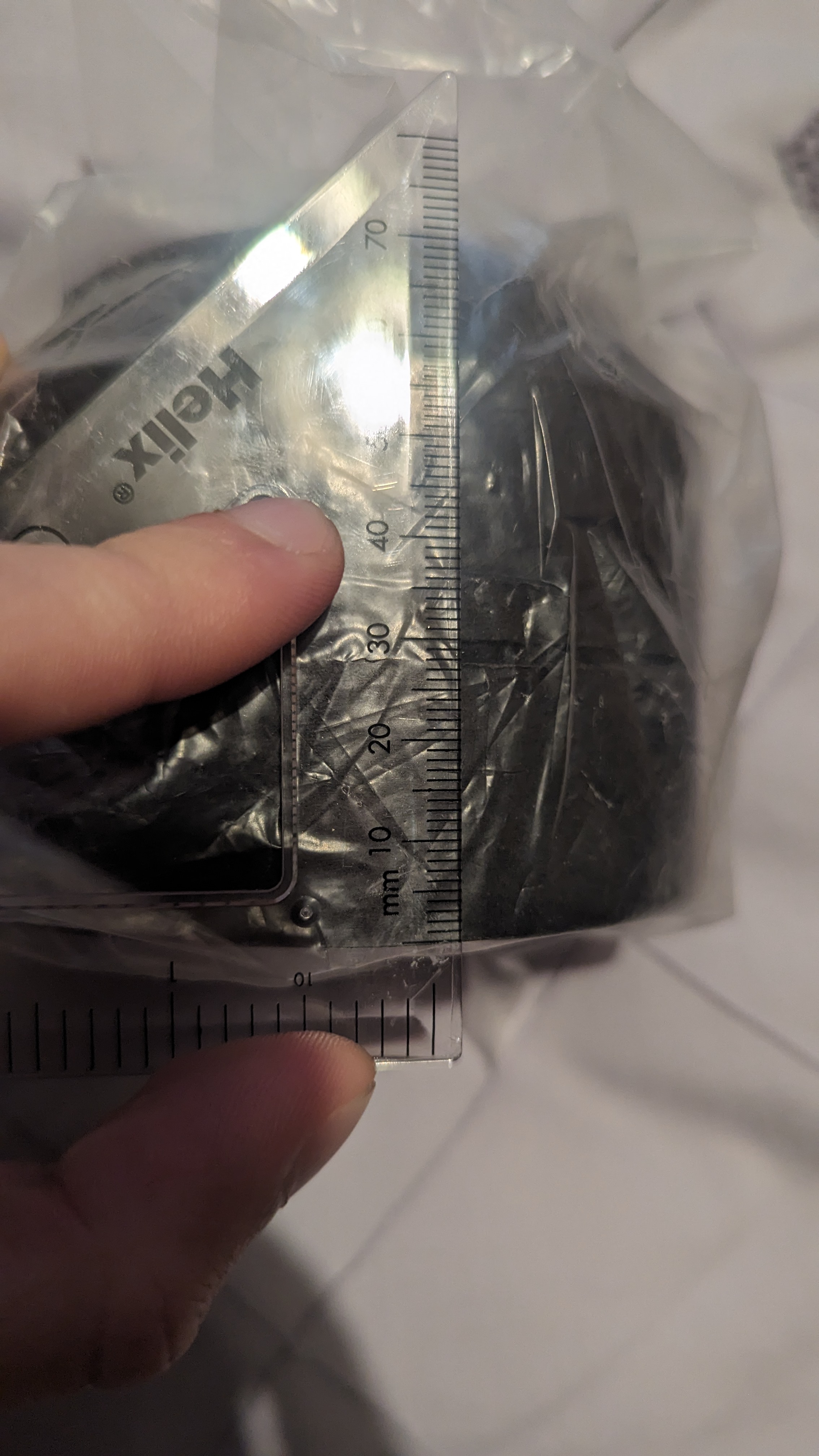

So I've bitten the bullet and brought a 30mm lift kit. I've read this entire thread so far, and I don't mind the slightly more expensive maintenance costs if need be for that extra clearance. HOWEVER, the lift kit has arrived and the front struts appear to be a good few mil shorter than the back ones. Any guesses why? This is a 30mm lift kit to be clear. Please see images attached for details...
I too looked at lifting kits, they were available on eBay (NOT the spring spacer type but shocks, springs and prop mounting spacers) the Italian supplier doesn’t advertise on eBay anymore. I believe, from the blurb, that they are shorter at the front to stop the driveshaft angle issue and, if you look, I think it will even the gaps out, front to rear, between wheel and arch
Ahh excellent. I was worried that the car may have been sat unevenly. Luckily I'm getting it done by a professional garage so hopefully we can iron out any issues which might arise. Cheers
