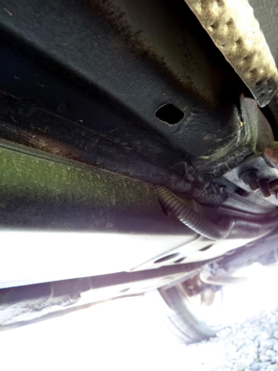

Hi,
I fitted my leisure battery in a box behind/under the passenger seat and connected the vent on the battery to a 6mm nylon tube which exits through a hole I drilled in the floor pan. Liberally coated the hole with Waxoyl so not much chance of rust.
From what I remember the exhaust pipe in the way on the drivers side.
Photo shows pipe coming out the box and heading downwards.
Cheers
Ron
