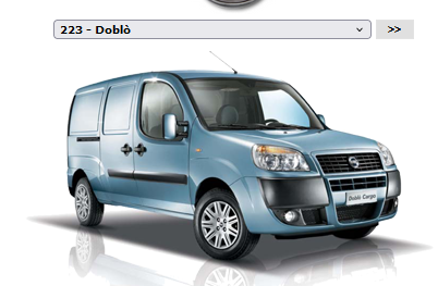

I don't see the 263 on the models list. And only got access to the documentation of this model:
The others give some kind of error. So I'm afraid I won't be able to help :(
