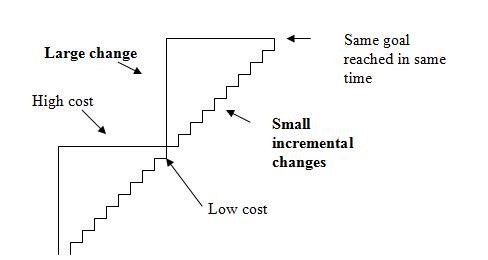

Im doing a college assignment about lean production (kanban keizen and all that)
im stuck on a question about continuous improvement
its asking me to compare and contrast the incremental approach to continuous improvement with that of the large step changes
at the moment i have:
Small incremental changes can be more beneficial to a company as they can take their time spending small amounts of money and reach the same goal as a big change would get them, a big change could involve a period of down-time where the company is losing money whereas small changes don’t take a lot of time. Below is a diagram demonstrating the advantage of small changes:
Both approaches take forever anyway. I know as Ive just completed integrating such a step change at work - admittedly its not in a manufacturing environment as per, but this should have some use
Standard CI systems tend to use DMAIC or DMADV principles (Define, Measure, Analyse, Improve, Control / Define, Measure, Analyse, Design, Verify) - which makes for huge amounts of bureaucracy and death by numbers.
What you find is incremental changes are preferred by businesses as its much easier to make a business case for a series of incremental mini-projects that can be split over numbers of areas, budgets and time periods - big step changes mean massive amounts of manpower and cash and lost production time (typically), which makes todays books (on which the management are rewarded) look appalling.
CI works most effective if the systems are dynamic and the people 'improving' the processes can add / remove bits of the process as they see fit. E.g.: to follow DMAIC effectively you need to complete all of those 5 phases, which usually contain lots of minor cycles eg: get data, analyse, understand shortfall, devise improvement, integrate improvement, try again. But if you know theres a damn big problem, you can cut out the D, M and A phases pretty much completely and start with a blank sheet.
The biggest problem with CI is its just not cost effective to use in some scenarios - I work in the aero. industry and our project lifecycles are 20-30 years with design typically lasting 5 years - you may only see 2 major projects in your working life in some scenarios. You can't feasibly CI in that environment as too much knowledge is lost and other systems change much faster between our projects - so its only really feasible to integrate changes on the fly (and accept that you may have to firefight if they don't work) and do massive refreshes every few projects.
