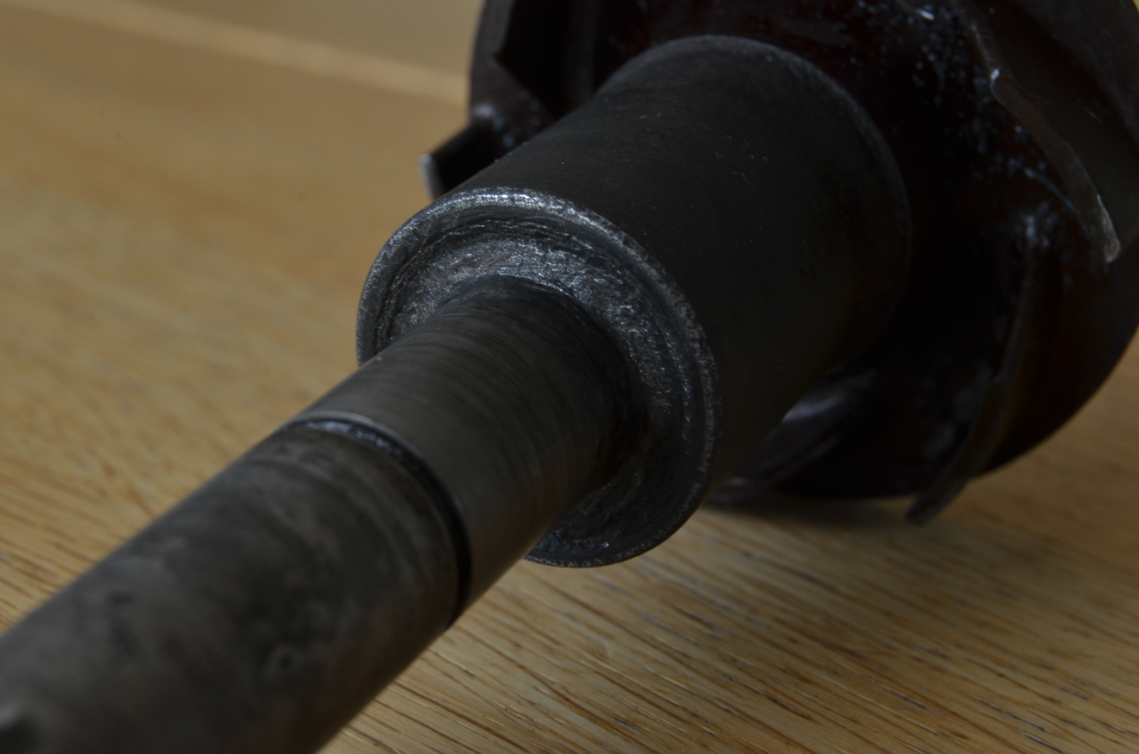

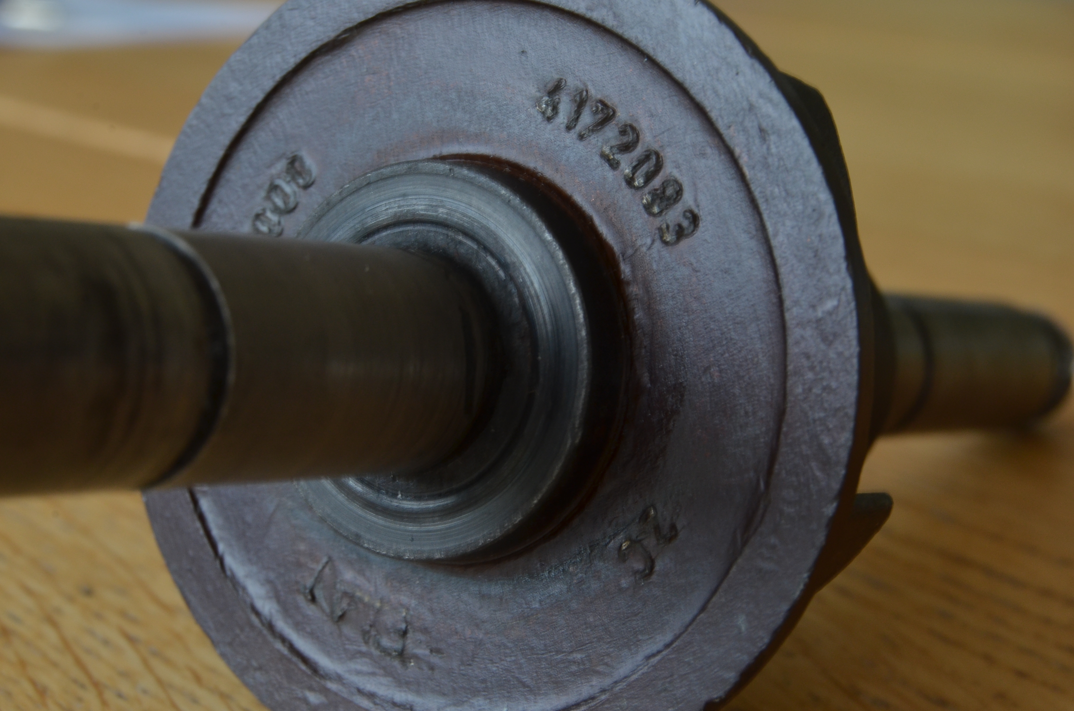

I have previously rebuilt my water pump, using new bearings and carbon seals, but it still leaked. I've stripped it down again and think if I've found the reason.
On the fan side of the impeller there is a disc of carbon which is bonded to the impeller; this looks in good condition. On the pulley side of the impeller, the carbon looked fragmented and hardly there at all.After poking off the loose bits with a pointy instrument it looks like I'm down to the bare metal. I assume that when new, these shafts have an equal amount of carbon coating on both sides?
So I'm going to experiment with fitting a nylon sealing-washer removed from a more modern, three-hole replacement pump in place of the carbon which should be there. I think I'm going to run into clearance issues, but at £400+ for a new pump or £170 for an impeller kit, it's worth a try.

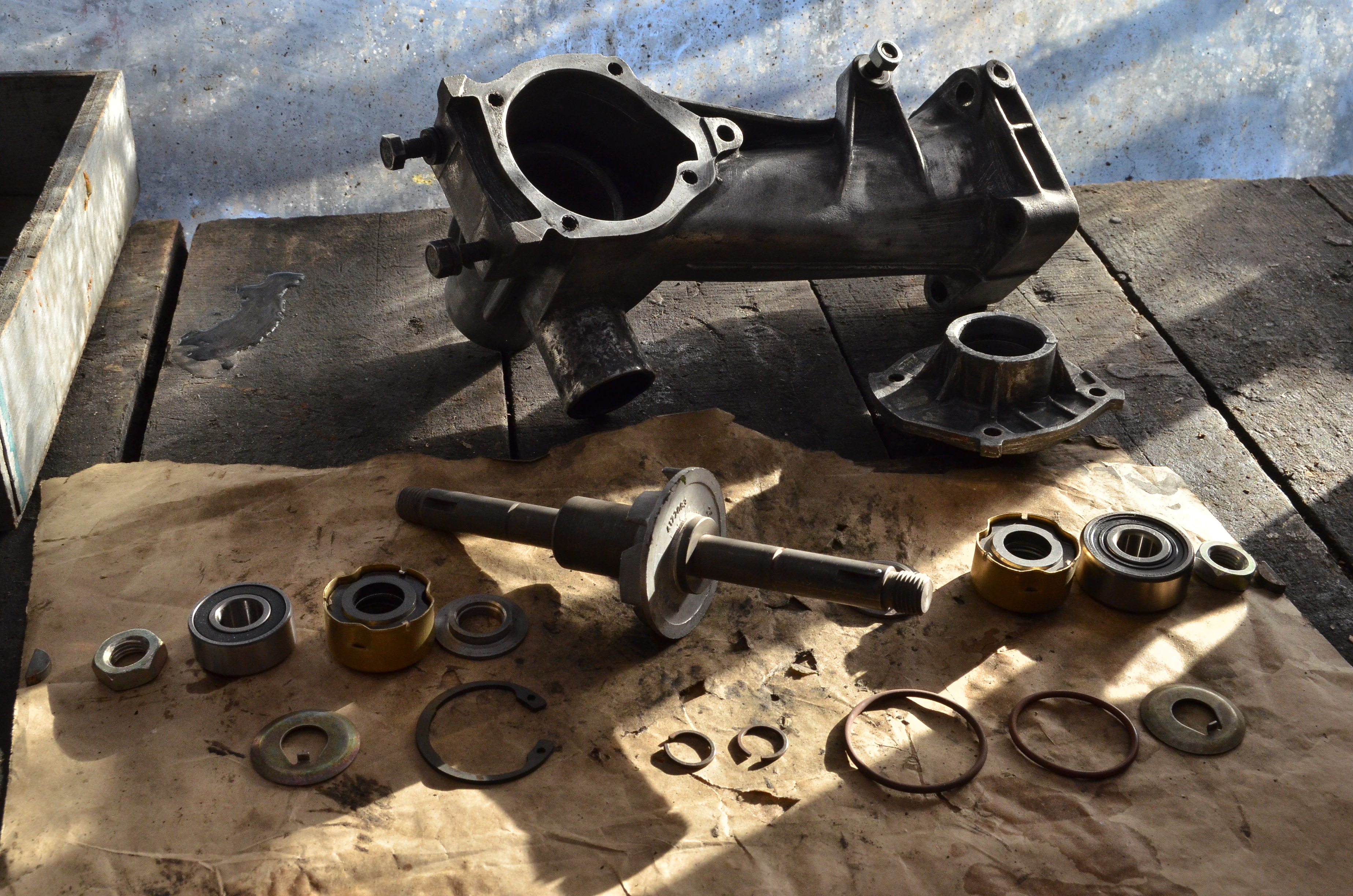

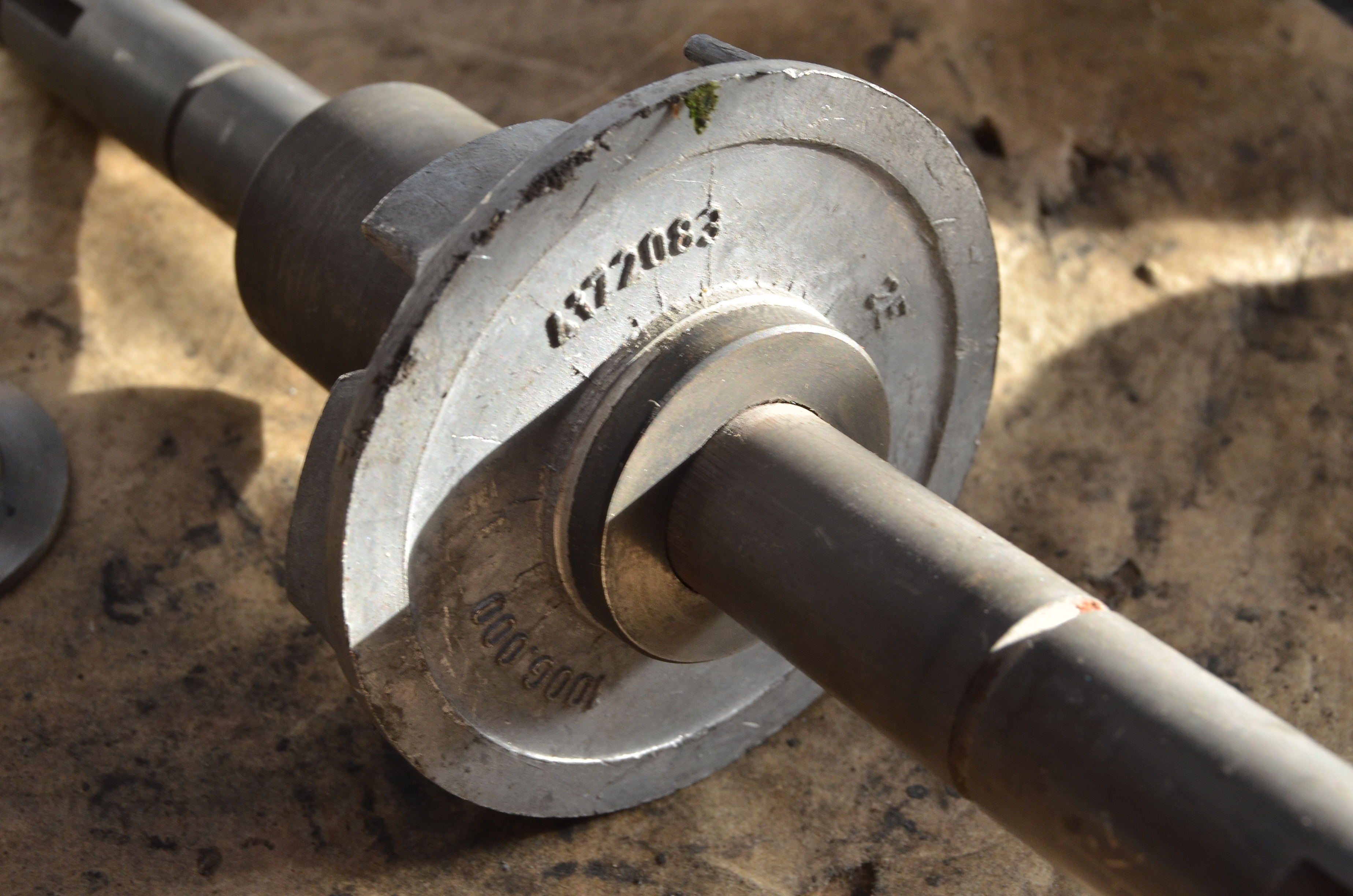

After a lot of thought, I took option 5. The kit was better than I expected. As well as the new impeller, seals and bearings, it also had two custom "O"-rings, the special circlips for the shaft, the cup-washers which bear on these, new pulley-nuts and lockwashers and quality gaskets for the impeller and for where the pump fits on the engine-block.
This time, I had a better understanding of the way the pump seals. I cleaned the casing inside and out, scraping away any corroded or chipped aluminium to create a nice fit for all the components.
It went together well and I can feel the carbon seals moving smoothly on the impeller. It's been a long and relatively expensive learning-curve, but it finally feels properly fixed. :)
