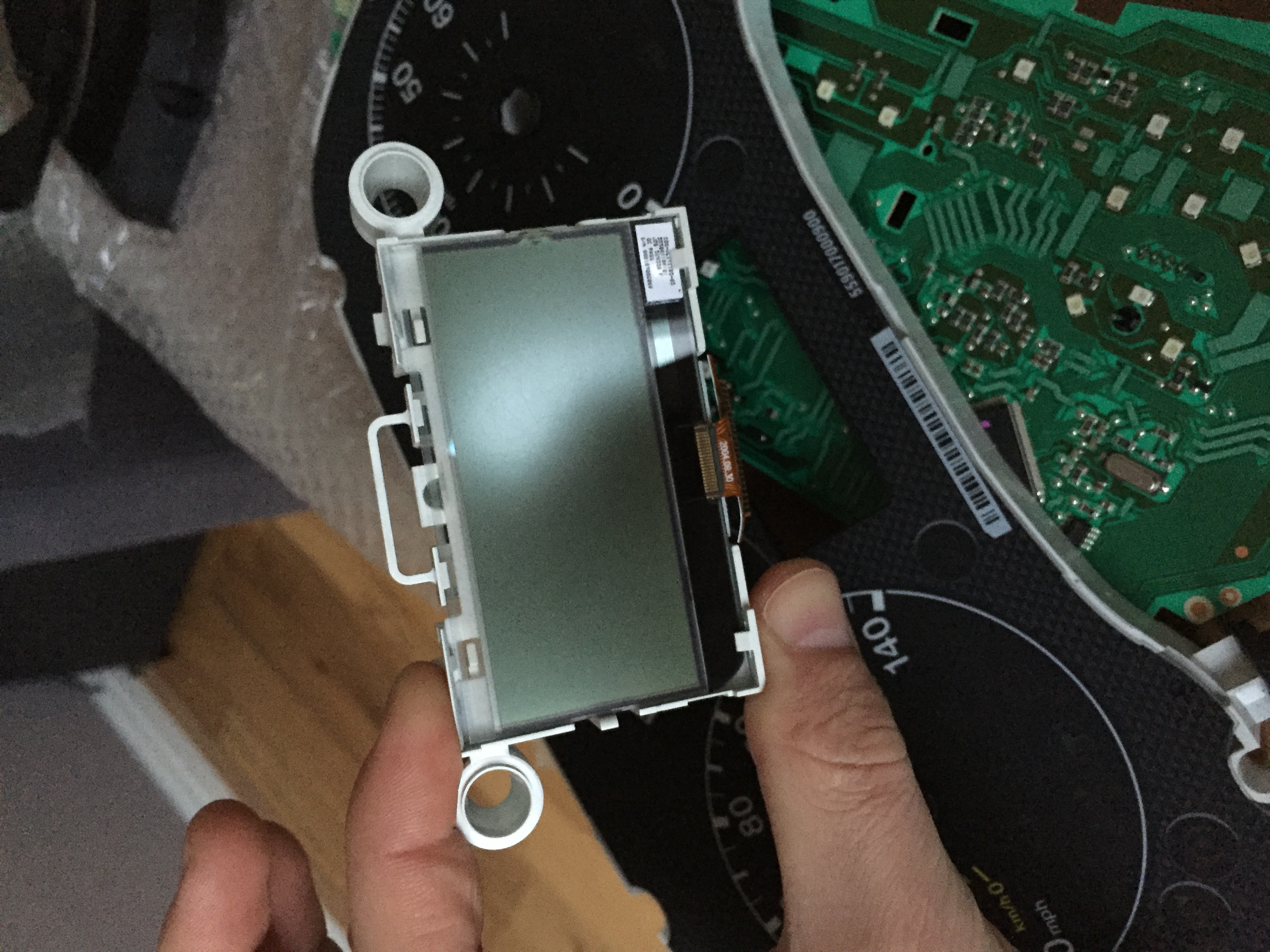

Hi,
No it doesn't need to be the same part number, it just needs to be the same type/size of cluster and screen. I bought the whole instrument off eBay for about £20/30 (forgot exact figure now) which was from a 1.9MJ Diesel which had done 100k+ miles. My car is only a 1.4 and only done 20k. Don't listen to those bullsh**ers. Just buy the same type of cluster and swap the LCD screen itself. See photo.
Any more info/how to's, I am more than happy to advise.
Cheers Dan
