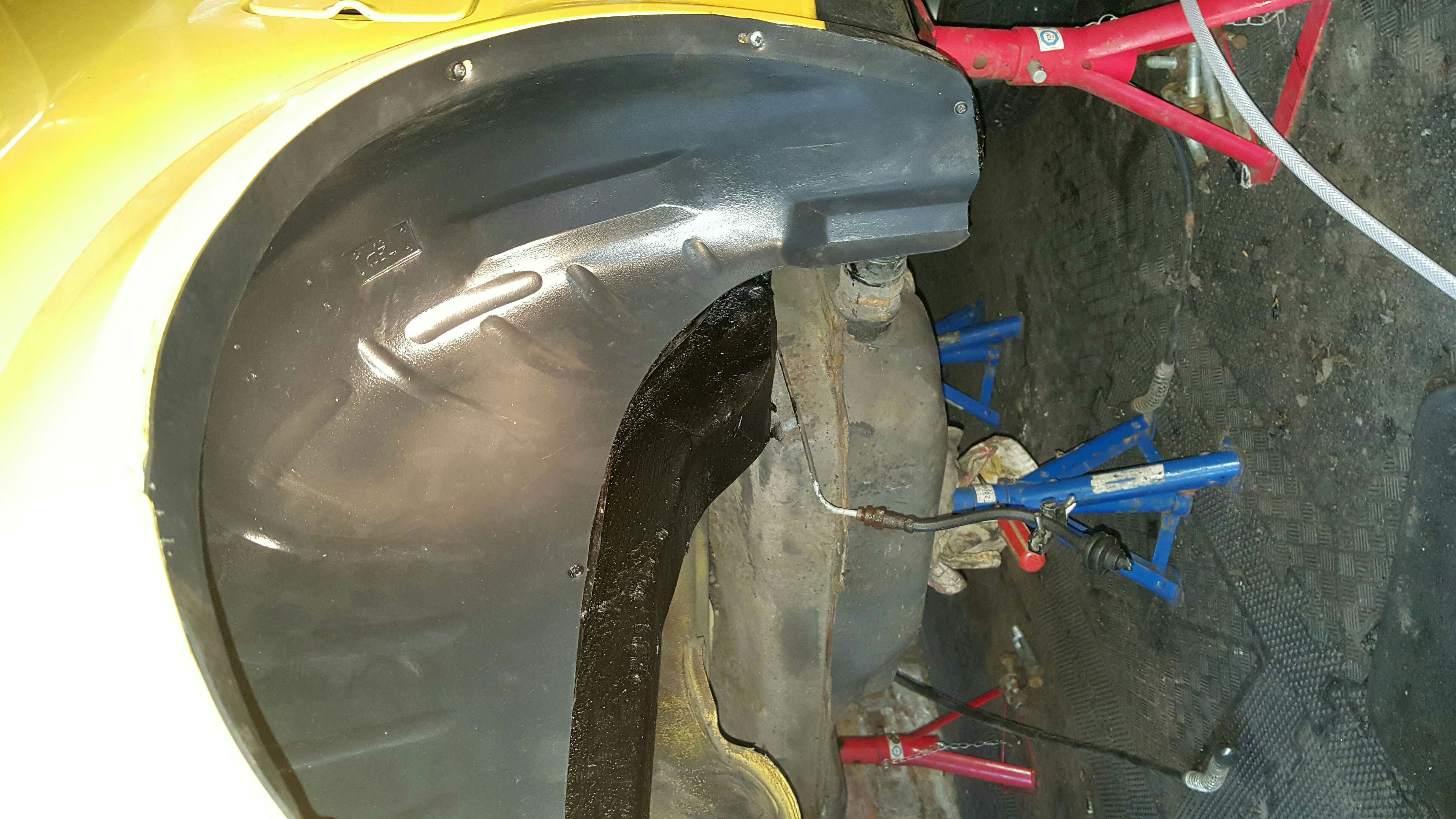

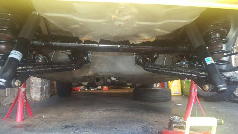

Pics of the old rotten beam axle mounting point. New beam axle cleaned and painted same with the trailing arm. New standard springs and shocks. Inner rear arch protectors. All awaiting re assembly
Goodbye rear inner arch tin worm for a long time hopefully.

This was the state of the axle mounting point on a Cinq I was planning on restoring, there wasn't much left after a go over with a wire brush!
It got to the point where the car was unfortunately way beyond saving due to rust. The axle wasn't rotten all the way through, but was very thing in places.

Thankfully I got to this one in time it was no where near as bad as your pics.
Finished most of the crappy stuff today, axle beam back on with new springs, shocks, brake hoses and trailing arm bushes. It's sitting back on its wheels and I'll get it booking in for a MOT either this week or may leave it till after Christmas.

Looks really smart. Well worth the effort. Looks like the rear springs will settle down a little.

Get yourself and an assistant in the boot and jump up and down or put a few bags of sand in the back? :)
Will probably take a week or two depending on how much you drive it.
Not driving at all. It's sat in a garage, so I guess I'll have to load the boot with some stuff to try and help it settle. Cheers

Well I fitted new Rear springs, which I have been told 3 times now by the Ebay supplier that they are the correct ones for the car.
But to be honest I'm still not happy with how high they make the rear end sit. To be honest I haven't done many miles but I'm sure they're not going to 'settle' anywhere near the level they need to be.
I've had the rear end loaded with weight for a week.
Any ideas? Anyone got any decent standard Sporting rear springs?
