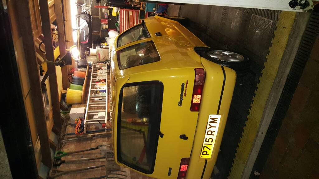

I take it you'll be fitting plastic rear arch liners after you've sorted out the holes.
Yeah I was looking into that last night. I've messaged I guy who was selling a couple that he never fitted.
Any other suggestions where I can get them from and prices?
Cheers
The guy who was selling was probably going to scrap it. Nice guy he had owned it for 18years, but when it failed the mot on a rotten rear axle and mounting areas he felt he could justify the repair cost. It drives lovely and is in great condition. Welded the chassis today, ordered a good second hand axle, new springs, shocks and bushes.
the guy who was selling was probably going to scrap it. Nice guy he had owned it for 18years, but when it failed the mot on a rotten rear axle and mounting areas he felt he could justify the repair cost. It drives lovely and is in great condition. Welded the chassis today, ordered a good second hand axle, new springs, shocks and bushes.
Are they the rare speedline wheels fitted? Looks like you are going to change them?
Well done for rescuing the Cinq
Yes they are the Speedlines. Think they're the ones fitted to Abarth spec cars? Maybe those who know could confirm.
Think I'll be going back to standard Sporting wheels.[emoji4]

Pics of the old rotten beam axle mounting point. New beam axle cleaned and painted same with the trailing arm. New standard springs and shocks. Inner rear arch protectors. All awaiting re assembly
