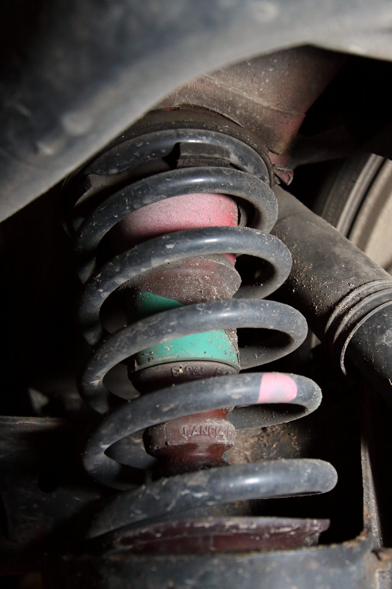

For a while now I've had a strange intermittant knocking noise from the rear of the car. It only occured when going over bumps and was similar in nature to a worn anti roll bar drop links as it only seemed to make a noise when the rear bounced up.
Took a look under the car to find that the left rear suspension bump stop is rattling around inside the spring! ..see first pic, the second pic is the right side as it should be.
Any idea how this should be fixed to the upper spring mounting? (the pink bit) and how I can reattach it.

Pretty sure that's snapped, should be one piece that is a push fit 'into' the chassis. Not bad to replace.
Thanks, delved a bit further and there should be a spigot on it that pushes into the mounting hole, this has clearly broken off.
A couple of new ones now on order from Shop4Parts, under £8 each :) . Will report back on fitting ease.

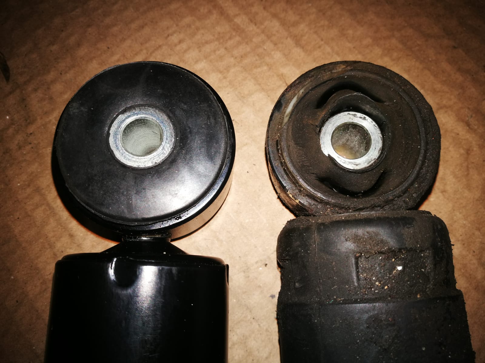

New rear shocks had been ordered and on fitting it was apparent it was the nearside top shock bush that was the culprit, the metal bush is completely loose and movement within the bush is slack. See pic. The offside one wasn't much better to be honest.
It's clear to see the design of the replacement shock bush is different, being a lot stiffer in nature.
