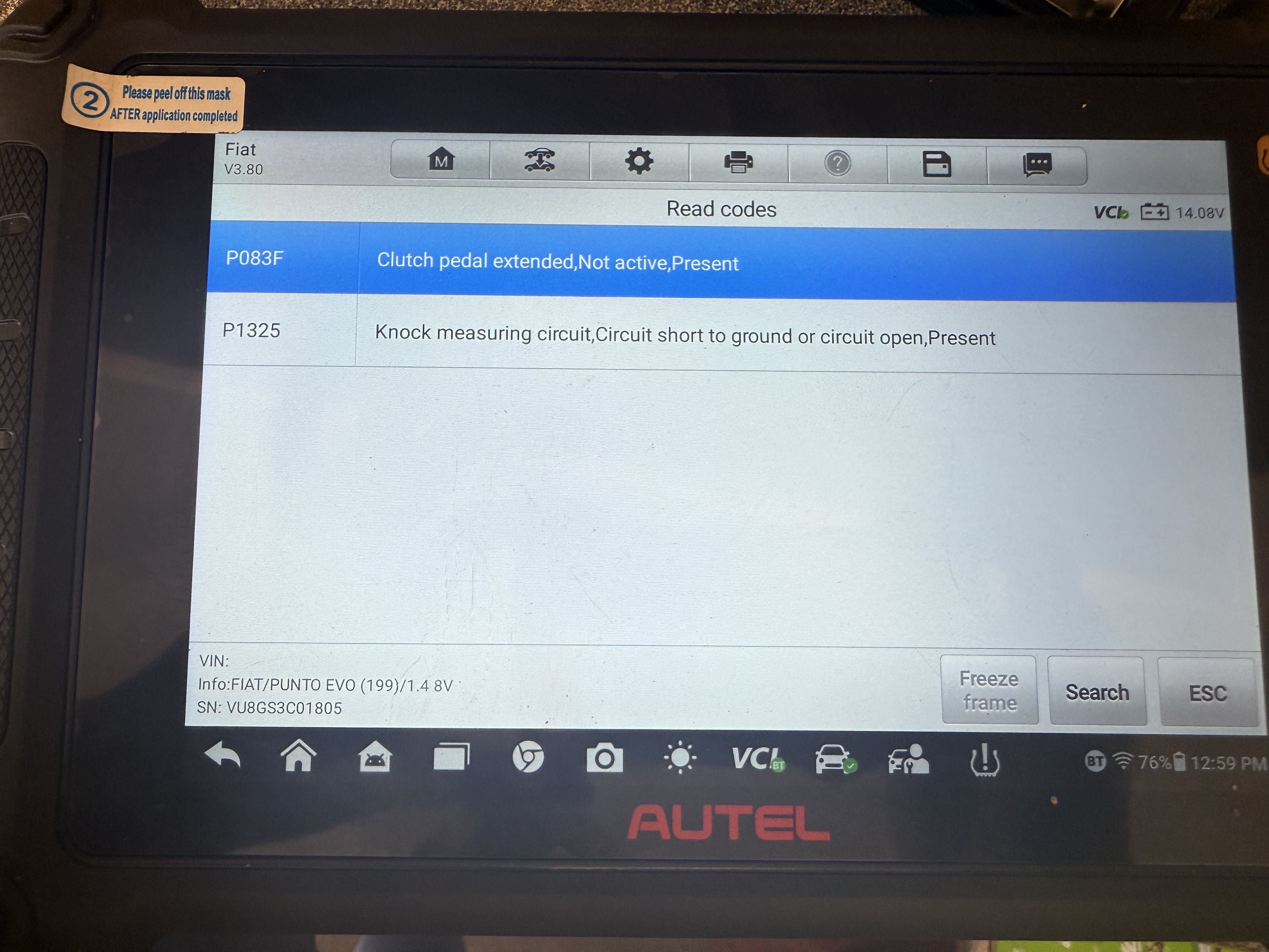

Can you (or ask the mechanic to) take a photo with the error and details of it, to know a little bit more about what's happening.
They say The P1325 code indicates an ignition timing malfunction, often linked to the crankshaft position sensor or ignition module. So there might be a problem on the engine and knocking sensor picks it up (abnormal knocks) and throws the code. Replacing the sensor won't fix it. You need to find what's causing it and fix that.
That looks like a wiring problem, if the new sensor is good. The circuit needs to be tested, including the ground. Contact might be oxidized, a good clean, contact spray might do them good. Check the wires continuity, maybe the (+) one got somehow on a heated engine part and the insulation melted, now it shortcuts.

I don't think that check applies here, you won't find anything to help you there. That would be useful if the knock sensor error were about high or low voltage, out of the range knocking values. But your error, as shown in your picture is about open circuit or short to ground. That's what you gotta sort out.

P1325-11 KNOCK SENSOR 1 CIRCUIT LOW
P1325-12 KNOCK SENSOR 1 CIRCUIT HIGH
P1325-49 KNOCK SENSOR 1 CIRCUIT PERFORMANCE - TOO MANY TRANSITIONS
P1325-64 KNOCK SENSOR 1 CIRCUIT PERFORMANCE - TOO FEW TRANSITIONS
We are missing the last part of the code, typical with a generic code reader
P1325 does not mean a wiring fault in all cases
