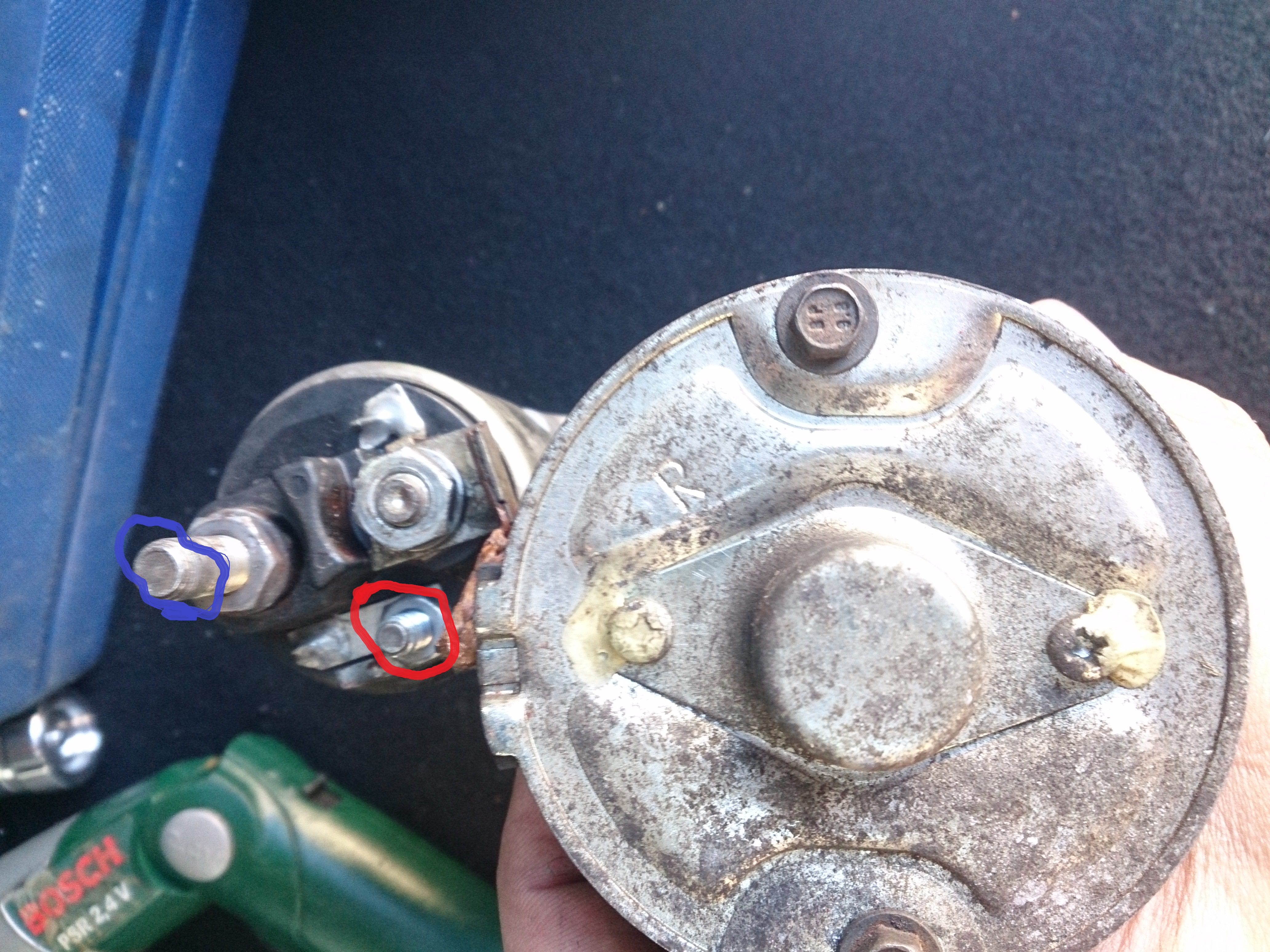

Can anyone confirm for me that for the starter motor three wires(one to battery, one to alternator and the third one cant' remember where it goes) are connected to the top screw and the thin cable to the small screw below as I can remember how that was before removing the starter motor please?

today I took out the starter motor and I have 1 big cable from battery that goes to the big screw on solenoid, 1 red little cable from ignition I think to small screw on starter motor solenoid, one big cable from alternator that is also coming to the same big screw like the one from battery and I have one more which I don't know what is it or where that should go. Is coming from the same bunch of cables where the small red cable from ignition is coming and at this end has like a blade connection with a hole that should go on a screw somewhere and looks like a ground. Anybody knows what that is or where it should be connected please?
I have pictures made to make it easier

The one I am not sure is the yellow one what is that one and where it should go. The blue comes from battery to the big screw, the red from ignition on that small screw, also from the blue screw is one more that goes to alternator(not visible in pictures) but the yellow one?
