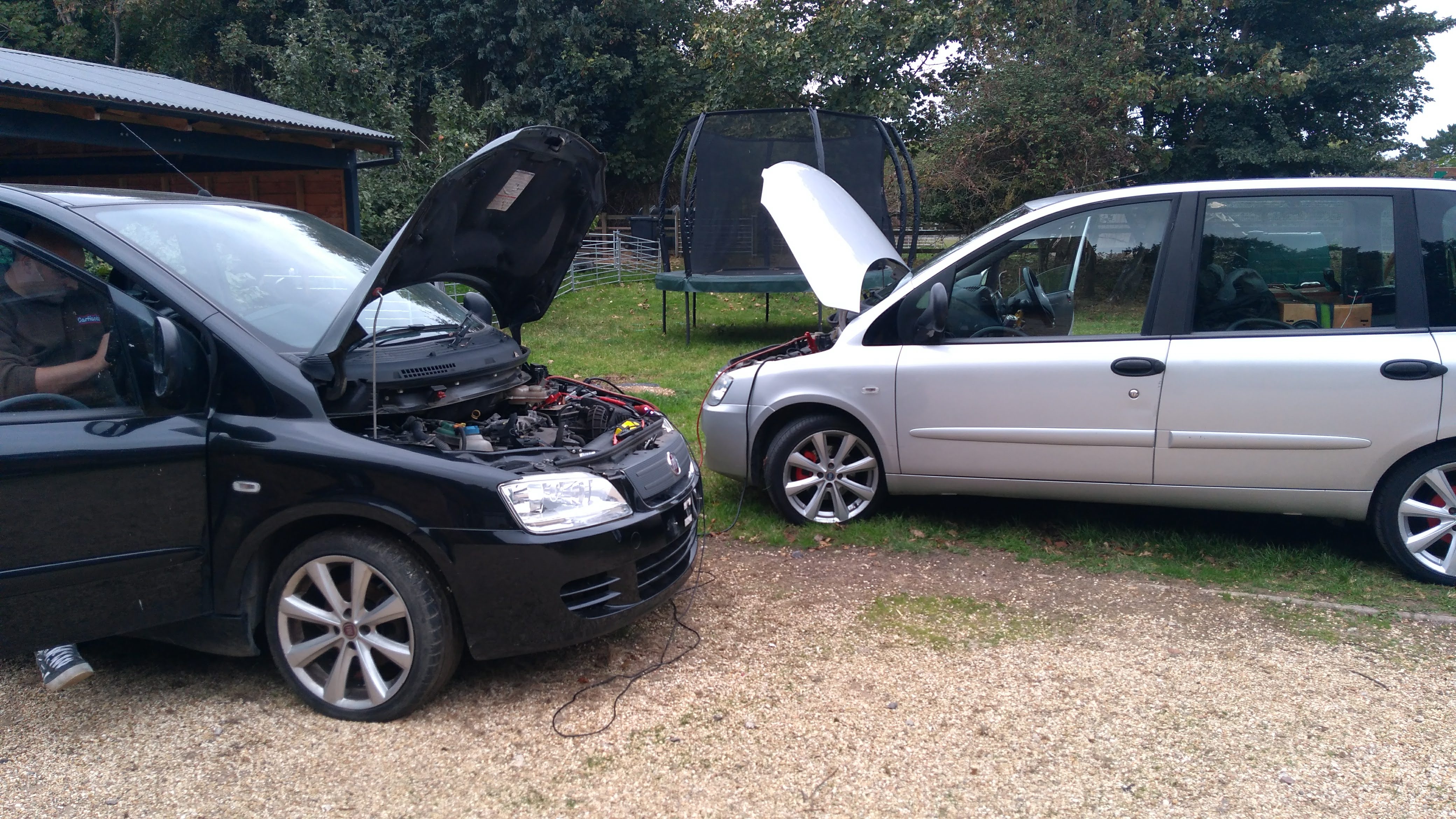

A big shout out for Mark at Car Hacks 07449467554 Crawley. I have no links
Bought 2010 Multipla not running as ECU immobiliser issue and took a punt ... more later.
Car had not run for 8 months and seller gave up having had various people look at it. (Autotronics in Leicester had his ECU for 4 months)
Found Mark as he offers ECU/transponder and key set (and mapping etc) on ebay and then found out about his Multipla tendancies.
He has run Multiplas for over 10 years as service vehicles !
He agreed to meet me at the vehicle.
Any way after a few hours of moving in and out known working components and various voodoo - Mark said issue was power to ECU not any of the components. He could not get comms with the ECU. We did not have any pin outs for the ECU or wiring details. He could not take it to Crawley as it was not taxed and tested, so I winched he on the trailer and she came North.
07:30 next morning changed the red relay in the engine bay with orange wire and she ran. :D:D:D:D:D
