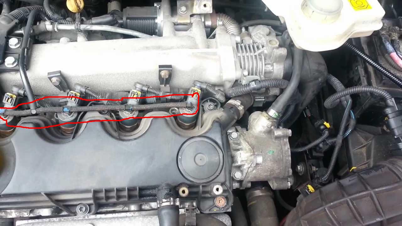

I would agree with the EGR valve, had the problem this morning and will block it off this time.
However I did have other problems with pulling off after a red light etc, the engine just died or lost revs.
The problem was the hose connected to the injectors was leaking and left a puddle of diesel in the recess under the injectors always worth checking by taking the plastic engine cover off.
