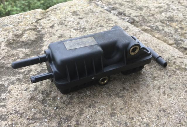

Hey,
i noticed a leak found where its coming from and its diesel. the part number i think thats on the bottom is PA6-GF30. This is a picture of the part engine bay, and ive circled where the part is here.
My car is a fiat stilo 1.9 jtd 115 break, 54 plate.
If any more infos needed just ask and ill try get it asap. I post on here in the hope can find out what it is before i ring fiat tomoz. As car is needed. Many Thanks.

think the part no you need is 46818882, could be wrong but it seems most likely on ePer...
just noticed today a strong smell of diesel through my HVAC system unless on recirc. took a peek and it seems mines gone the same way as yours. :( damn...
rob
Mine went a while back it is a Diesel Fuel Return Manifold..got mine from breakers on ebay sent picture of mine to make sure I got the correct part as I think there are 2 different designs
Hi Im just adding to this thread as I managed to break my diesel return manifold whilst changing the glow plugs :mad:. I had a great response from https://www.breakerlink.com 3 companies got back to me in the same day and advised that for my version the OEN is OEN 55219218 and only other availability is direct from Fiat. My fiats actually in France and the breaker will deliver to France from the UK in 3 days great service and £35 + delivery :)
