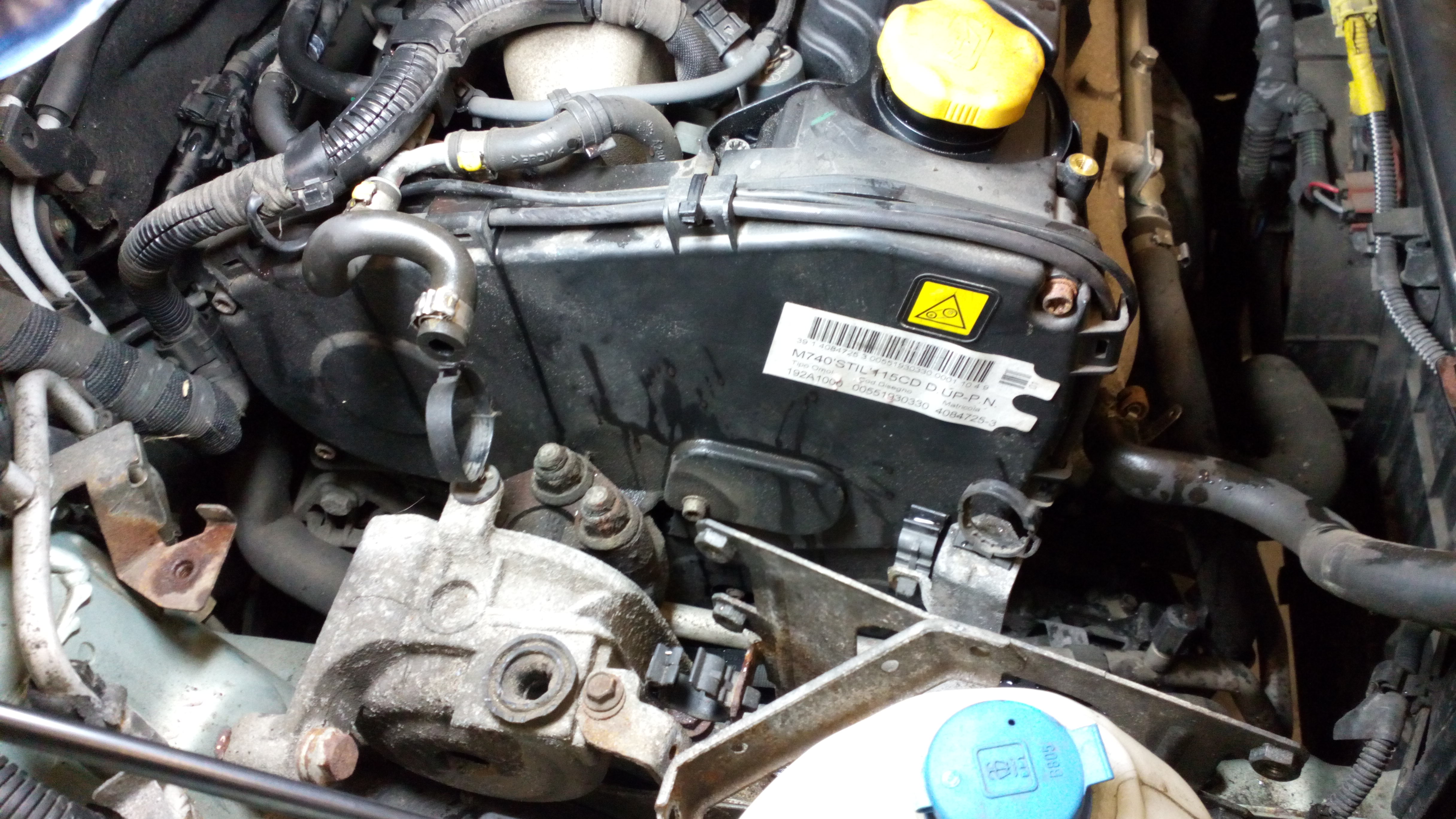

Hi
I have been doing a bit of work on the old fiat and finally came to the cambelt change. I had read the advice on changing the waterpump at the same time so I had a new pump, cam belt kit and an alternator belt all ready along with some of that pink stuff from Fiat. Bit fiddly but managed to get the engine stripped down as far as the water pump. i had read a post saying the hex head bolts holding the pump in would be tight as they are loctited. Well the first one needed the trolley jack handle on the end of the tommy bar to get enough leverage to get it out. The other one refused to play ball and the allen key just lunched the inside of the bolt head... so after 3 hours I managed to get the bolt out using a drift and a 2lb club hammer. I was just glad it never sheared off in the head. So some new bolts are on order and I should have them on Thursday so the next installment will be Friday.

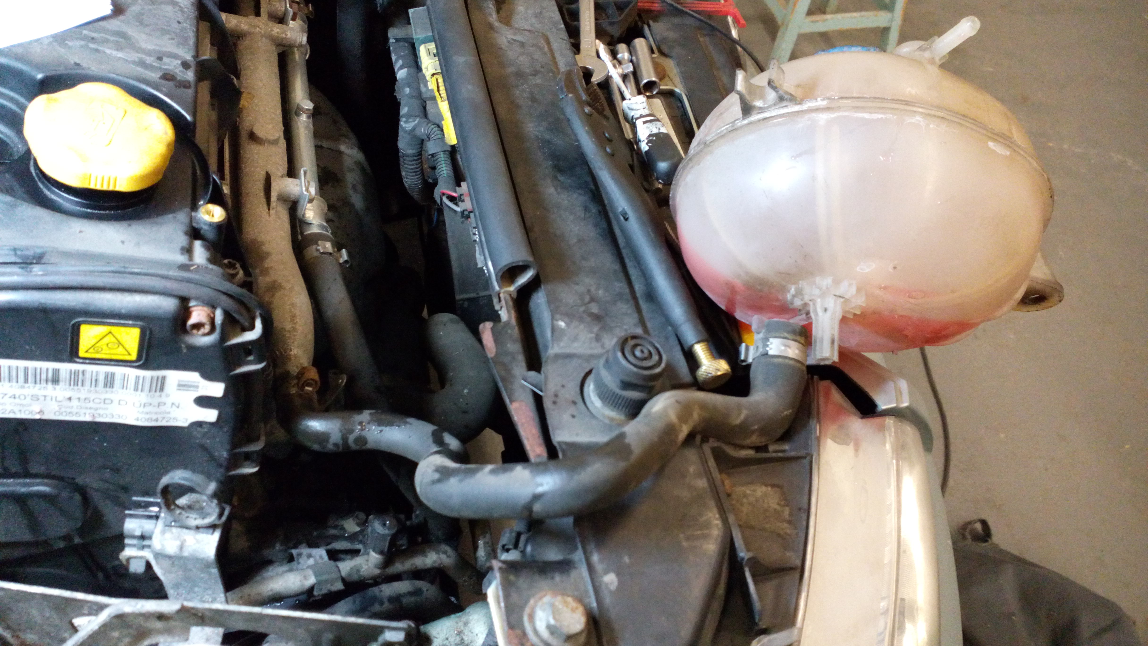

Not sure if you have removed a hose to drain the coolant yet, for myself I found that the bottom hose on the rad very awkward to undo the clip on and being a plastic part going connecting to the rad opted for disconnecting the bottom hose from the rad where it connects to the engine block which was alot easier to access and saved risking snapping anything made of plastic I then dropped the hose down through the under tray into big bowl to enpty the old rad coolant.
you will need a large jubilee clip doing it this way when it comes to re-attaching this hose from the engine and filling the coolant up and also once you have it back together and filled with coolant the cooling system will require bleeding start at top right of rad is small plastic twist blled screw then small bolt on a metal pipe at front of engine loosen off till fluid flows then do not over tighten when refitting this bolt I think it is very small one and may snap. last one is a screwdriver flat blade towards right side of engine attached to black coolant pipe and made of black plastic. think this one is part of cabin heater..if you do search you should find more info if needs be and I did not get the sequence for bleeding correct but start at lowest point first and it be ok.

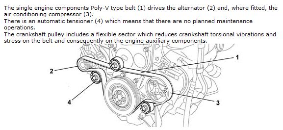

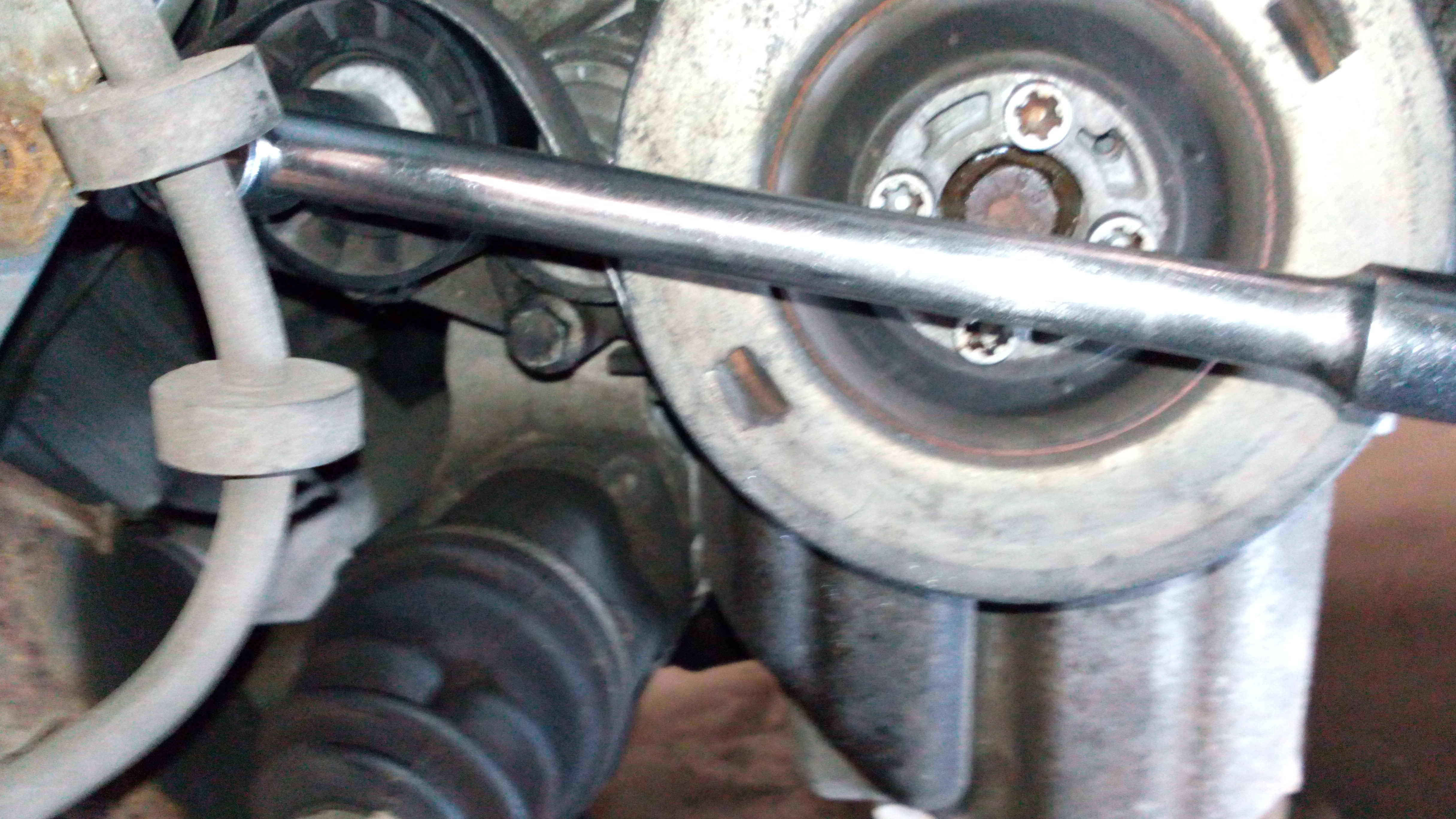

thanks for the pic.. just need advice on how to release the tension in the auto tensioner pulley thing enough to get the new belt on. After 4 unsuccessful hrs yesterday I have come to the conclusion I need a much longer 15mm spanner a ring preferably or I need to drop the engine enough to get a socket and a good extension bar on. I ended up yesterday jacking up a open ended 15mm spanner this took some of the tension off but not enough and was a bit scary.
Clarkey

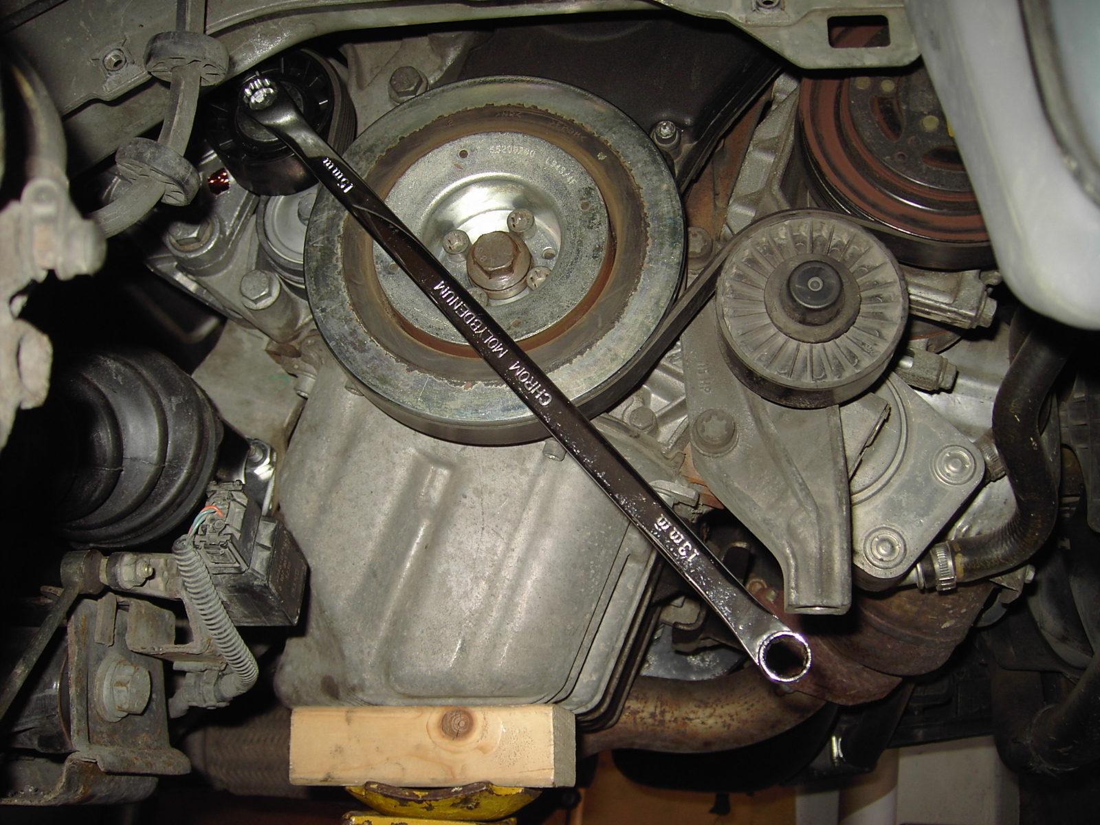

It's not really that much tension on it, it's all about the right tool for the right job... if you get a box end/ ring spanner on it you will see it will be much easier.. and more secure. + you can get an extension bar on the spanner but might not have enough room to maneuver.
Use a ring spanner, put something on the handle to make it more comfortable.... like wrap it in a piece of cloth.
I agree a nice new ring spanner is what I need am off to Halfords now to get a 15mm one. I will see if dropping the engine on that side helps. all the nuts and bolts have been out so are free after the cambelt change. thanks for the advice
Clarkey
Hi all
the auxiliary belt is on!!! the trick was to lower the engine enough to get a proper 15mm socket on the tensioner, a couple of extension bars, a bottle jack and it was on. just need to charge the battery and top the water up and we will see if the beast will start.....
