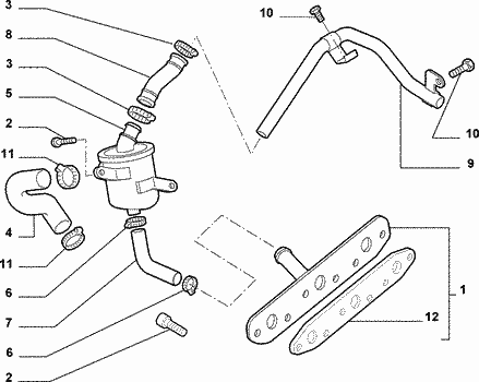

Hello! Who knows with what solution(carb cleaner,gasoline,etc.) i can clean the oil separator(number 5 in the attachment)? If it's possible to do that. Thanks!
1.take it off the car
2. spray oven cleaner( Sano, Triumf,..) in both ends ..let soak or 5-10 minutes
3. rinse with hot water
4. repeat steps 1-3 until you no longer see any crap coming out(at least 5-6 times)
Before putting it back on the car make sure you rinse it enough to make sure none of the oven cleaner will go inside the engine.
