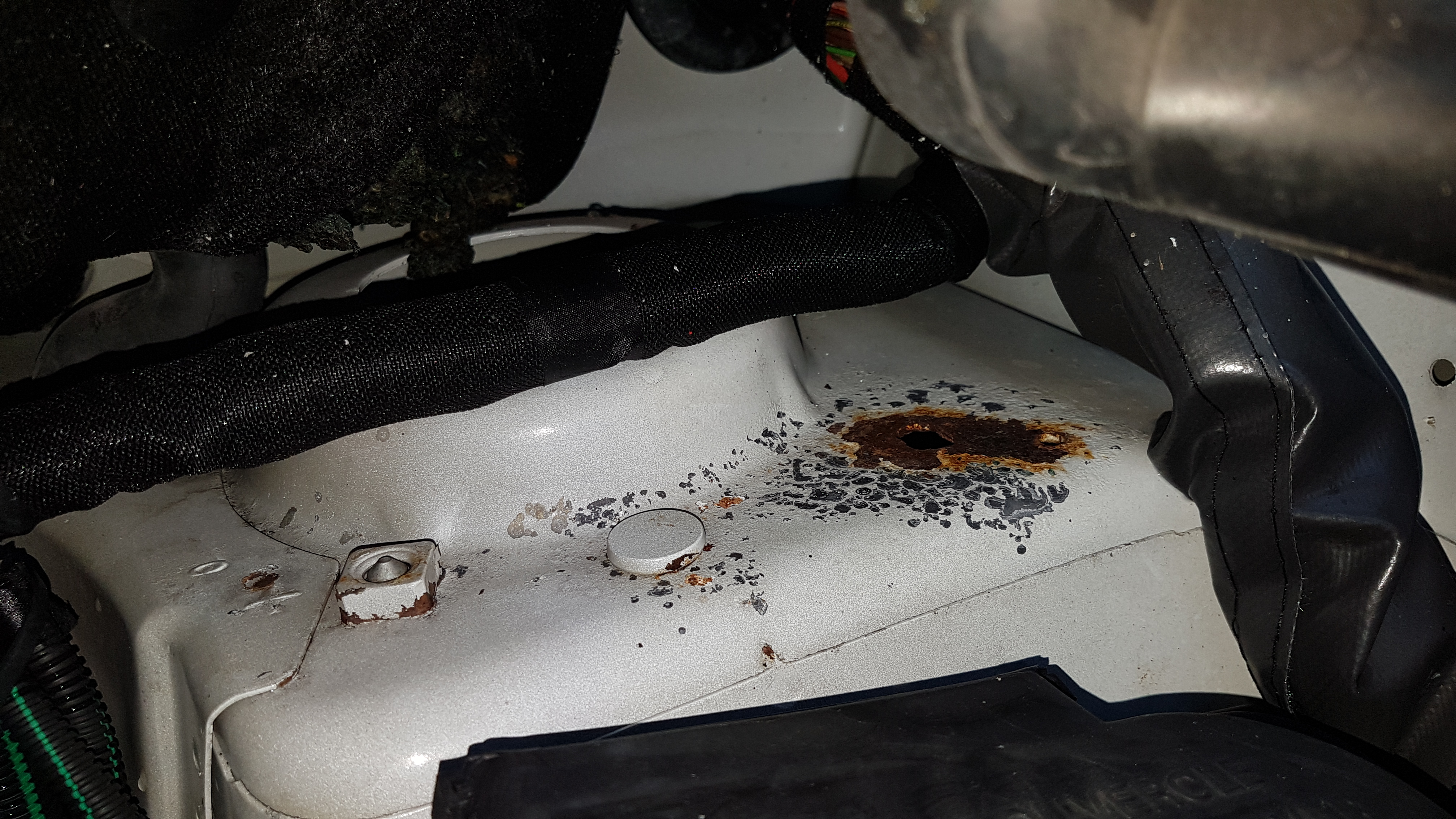

while i was under the van i had a poke around at the rust and made quite a "holy mess"... holy sh!t. well i can weld it all up but having done that much of it i am at the point where i just do not want to do that kind of thing anymore. i ordered new sills and planned to take it to a body shop to repair as they would make a much neat job of it than i would.

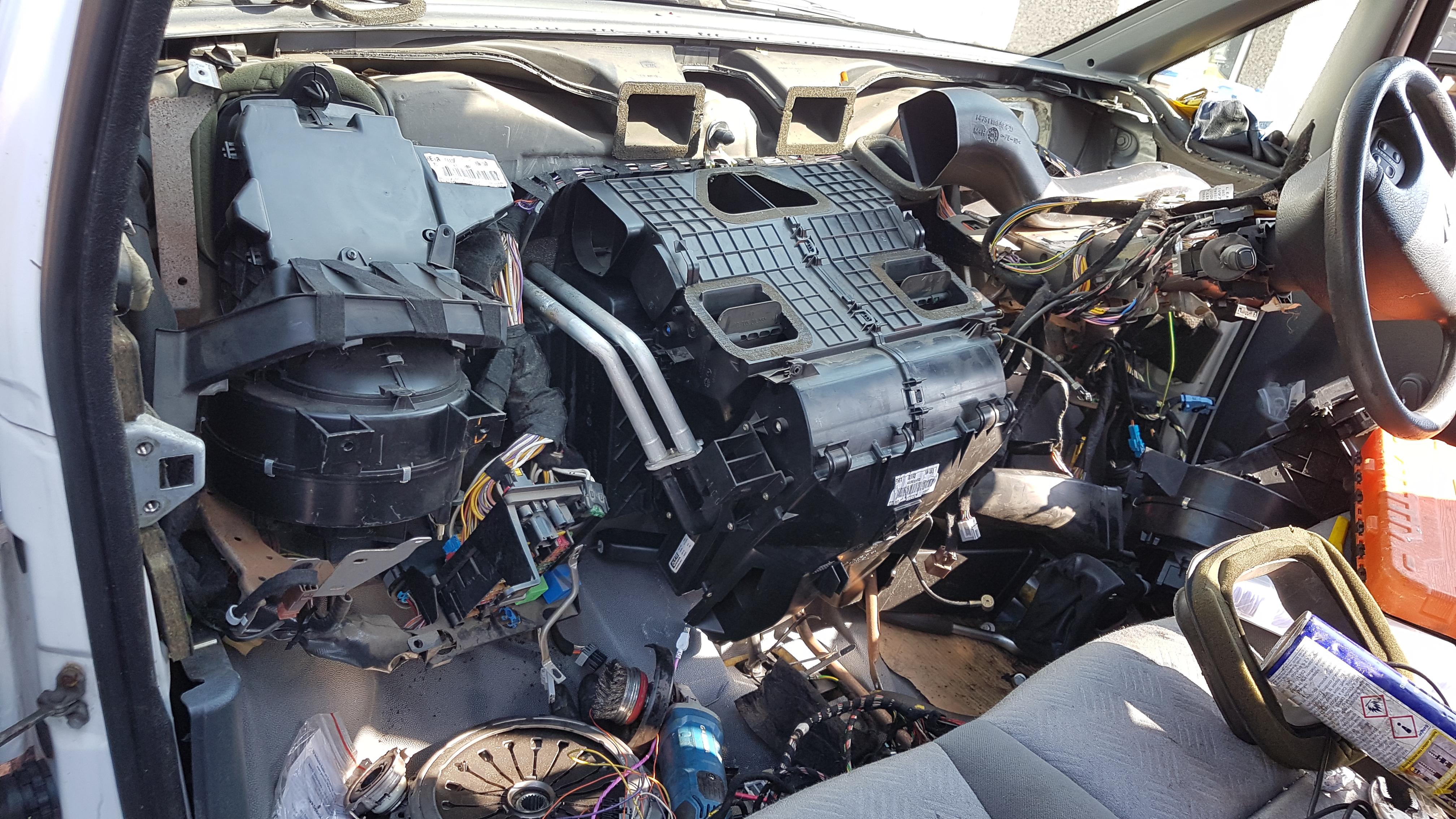

i have recently fitted a 2kw diesel air heater under the passenger seat. having cut out the "storage basket" to make way for it. i had to hammer flat some of the vans floor corrugation so it fit in nice and level. i did this using a trolley jack and a brick so i could hammer flat without concaving it. it fits in the gap really well but is close to fuel and brake lines under the van. i plan to make a heat shield for them. can never be too cautious. the heat output should blow nicely down the central walkway. between the seats and the kitchen units.

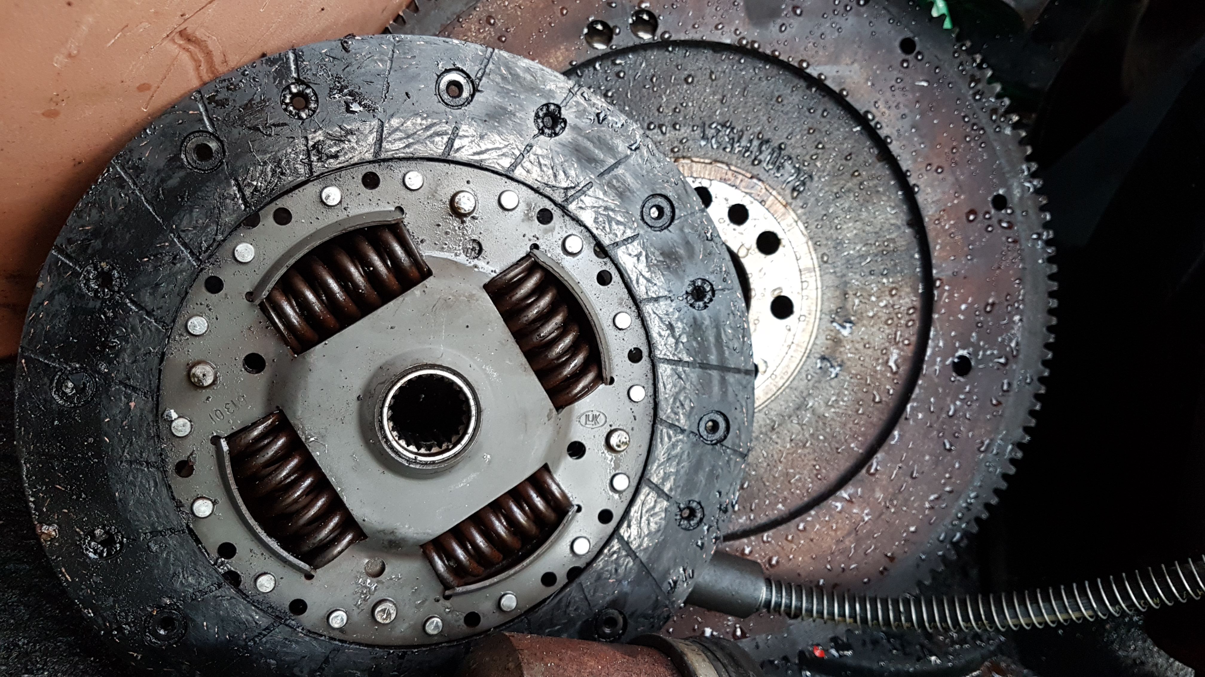

anyhoo the flywheel ended up being a solid flywheel so i had to return my clutch kit and get a different one.
also the crank shaft seal was weeping so i replaced that too.
well used...
still life in it, but the spring plate had gotten very hot and warped the spring tips.

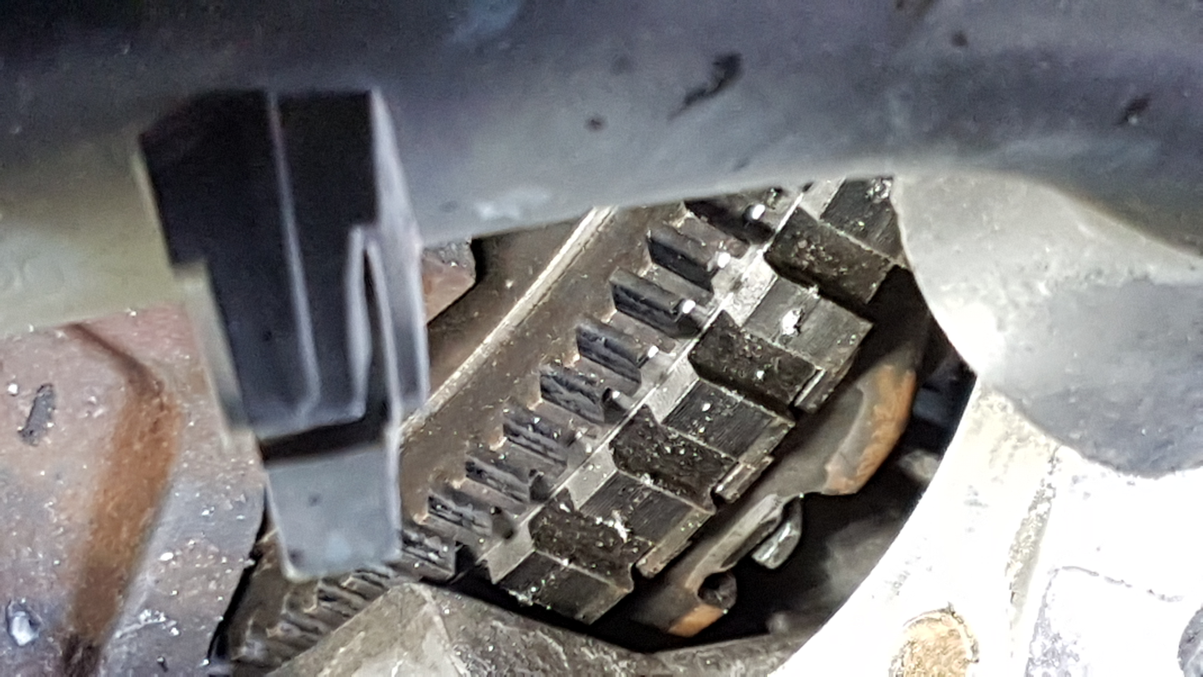

well cut a long story short i have had the box out, replaced the flywheel and clutch i have it all together and tried to start it but nothing, just cranking.
so i get the code reader out (hello darkness my old friend, ive come to talk with you again) and sadly i am getting the dreaded P0230 "Fuel Pump Primary Circuit" fault code in the ECU.
this sux.
this sux for a few reasons as i have just put the front back on.
hmm well i tried the red fuel cut out button and sure enough it was tripped so i pressed it in and was damn sure that was going to be the end of my issues. sadly the same fault code persists. however the fuel system now primes when the key is turned.
i must have somehow damaged the wiring on the high pressure fuel pump on the engine. no idea how though as i have not touched any of the engines wiring.
hmm so i need to figure this out :/
My understanding is the code you have relates to the ecu controlled solenoid part of the fuel pump relay. Wierd because it is now working.
Check crank position sensor.
You will find problem , you just never give up . Good man
Jack
OK so.
the issue has been fixed. the new flywheel has timing lobes that are too tall for the CPS.. causing the CPS to rub on it. fixed it by packing out the CPS with some washers. and there we go, a running engine!

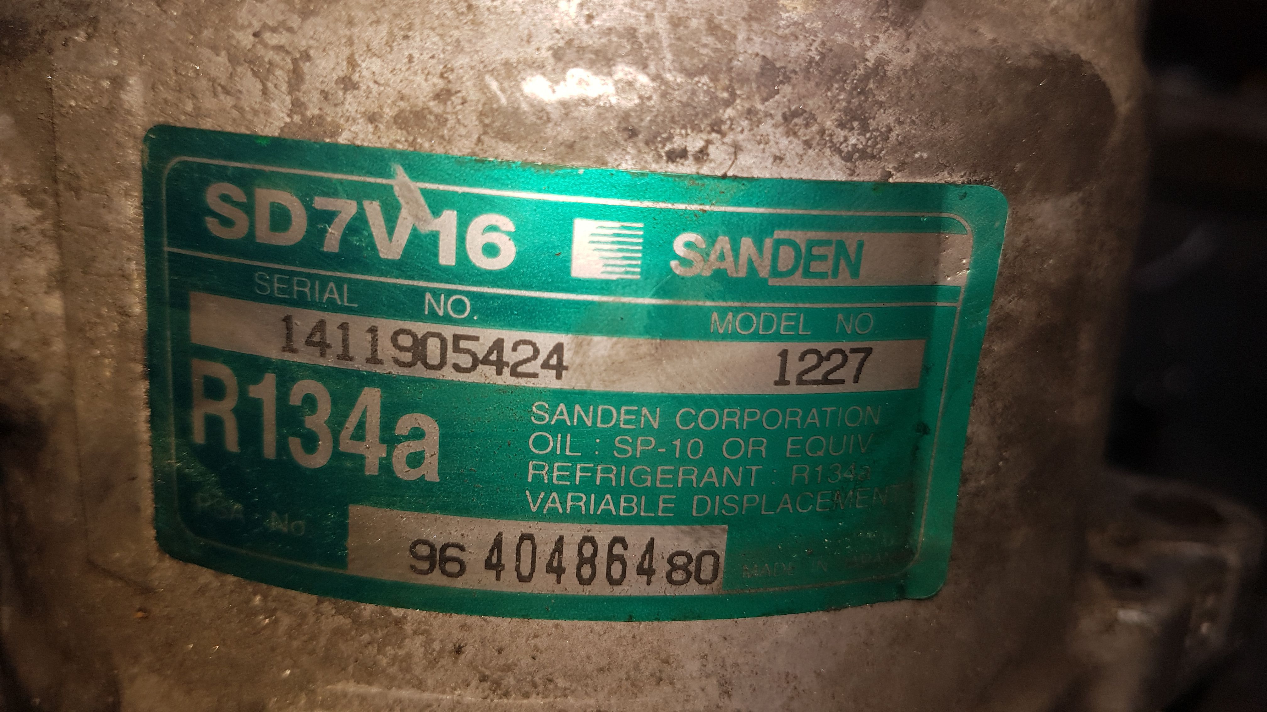

this is the AC compressor i have. its pretty nice as its a variable displacement compressor
this is the rather nasty looking very moisture saturated oil that was in it :/

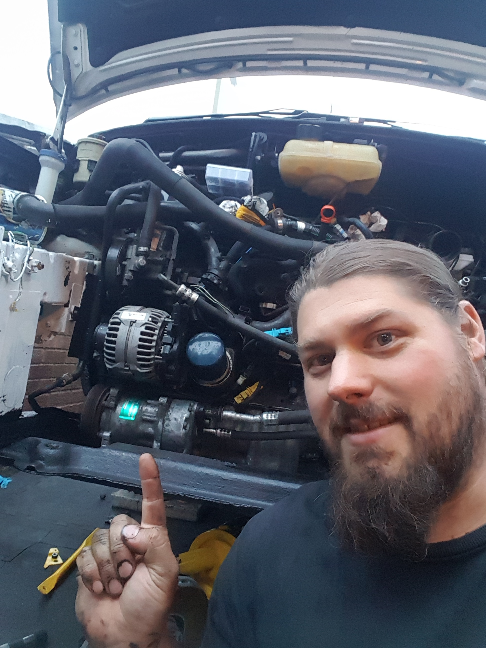

draining the old oil
hey look its me, and the compressor now home.

alright. so heres the pictures of the rust protected finish.
all i can say is its not a very pleasant job chipping, wire brushing and filing away all of the rust.
so i pretty much got everywhere i could back to shiny metal. i then painted everything with a paint that has a built in rust converter and inhibitor (2x coats). i then went over the paint after a few days of drying with a thick brush on underseal. theres a few cavities in that area too that you can get the dynax tube in and give it a good internal coating. stop and prevent any bastard rust in its tracks.
i have the rear axle kinda back in now. i spent most of today cleaning up the coil springs and those 2x bars that slot in above the rear axle. both really rusty. then just cleaning up other bits on the rear axle and painting. this job is 90% waiting for paint to dry and 10% doing the work.

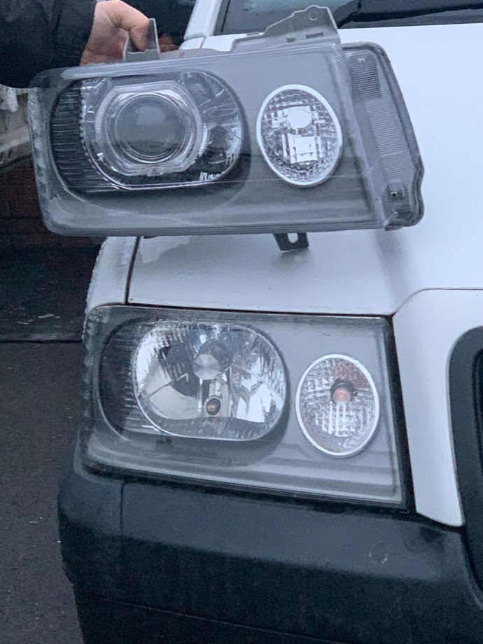

Been having a little bit of fun..
so i am pretty disappointed with how the lights preform.. high beam is pretty good but low beams are just bad.
so i bought some brand new headlights. not to fit to the van, but to modify.
so this happened..
then this
to give a end result something like this
and as i know someone out there in the future will want to also do this, i made a kinda how too video.
when i can, i will take the bumper off and fit the new lights. some wiring relay adaptors or modification is needed to run bi-xenon type lighting however.
just waiting on the wiring adaptors and the engine under tray.. do all the jobs in one go :D
till next time!
MOT pass with the new lights! they look awesome too!
