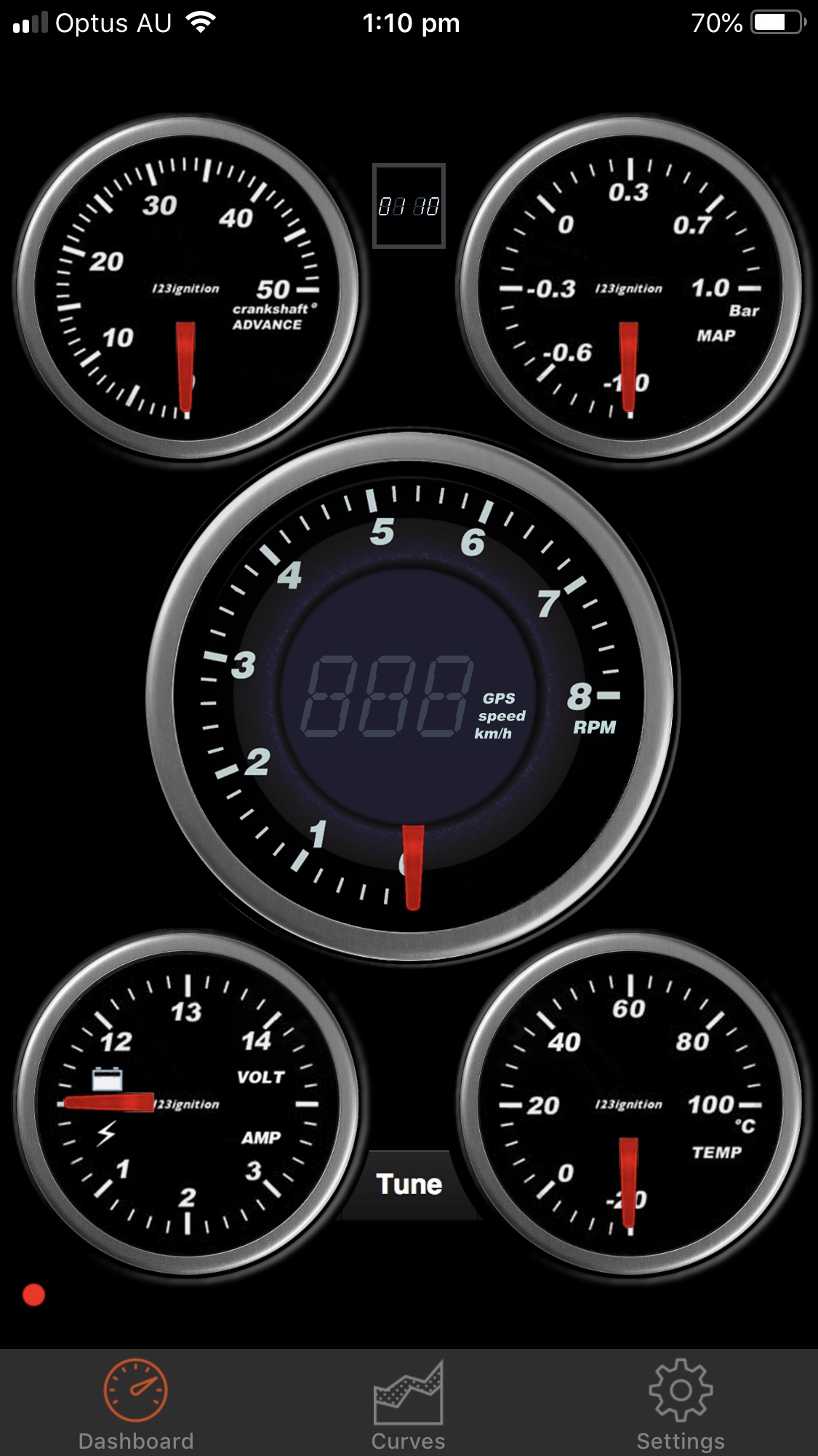

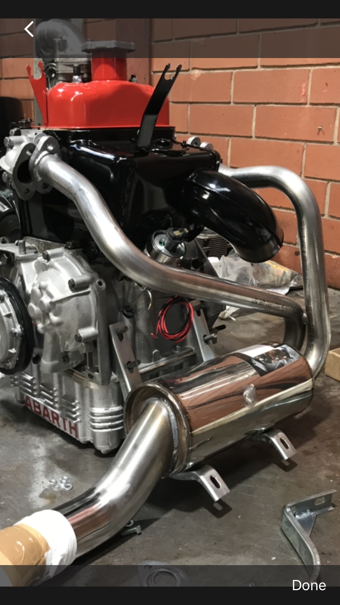

I have it on my 652cc! mind you it’s not In my car yet. I’m hoping to have the car completed in the next couple of months. I think my 123 is a latter model. All the tuning is done via my phone!IMG_7592.JPG
Hi, so this is the Tune +, you can tune via your phone the ignition curve and as you state, it has an immobilizer.
You may get the RPM from the device and app, but for the other settings, oil temp, oil pressure, volts and amp. you'll need some sensors and wiring installed.
Also, best part of 400 euros so not cheap.And you can't use your phone for anything else if you run the app in the car.
Pro's and cons. Do let us know what you get in the box and how the install goes (y)

I’ll let you know more when I have it up and going. I bought it about 18months ago from a local Aussie distributor with a high output coil for something like $500 AUD. The system is called the 123 plus. I also believe I can run the 123 app dash dials while listening to my favorite “fiat 500” mix on my Bose wireless sound system. I can post a link if anyone would like more info.
