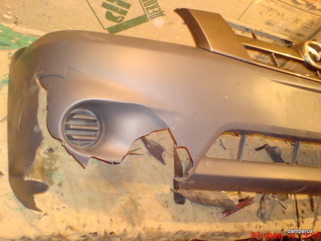

Hi! i don't know how you done this work, but actually it is a absolutely easy work. You can do it by yourself within 15 min if you have a electric dryer. I can tell how, let me know if it is still actual.

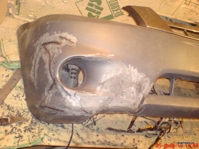

Many independent bodyshops do 'plastic welding' of bumpers etc. Makes it almost as good as new. There are also DIY plastic welding guns/kits available but probably not cost effective for (hopefully) a one-off job.
Some people have used hot air guns or soldering irons along with wire staples(for reinforcement) to repair splits, followed by a spot repair of any damaged paintwork.
This might be cheaper than trying to find a good s/h bumper in your car's colour.(Front bumpers more often damaged than rears?).

Different glue and staple is an easy and cheap way for masters, but it is hold not a long time. Because all the glue do not like moisture and solar ultraviolet radiation and especially frost. At first, iron (wire, staples, wire mesh) could decay, but also it have a difference in thermal expansion with a plastic - therefore alloying iron with time breaks crack again. In general, plastic repair with iron is the lowest quality. Qualitative, really long term repair should be made with a plastics welding, but not all kind of plastics same good.

I found a good example of repair with planar connectors:
