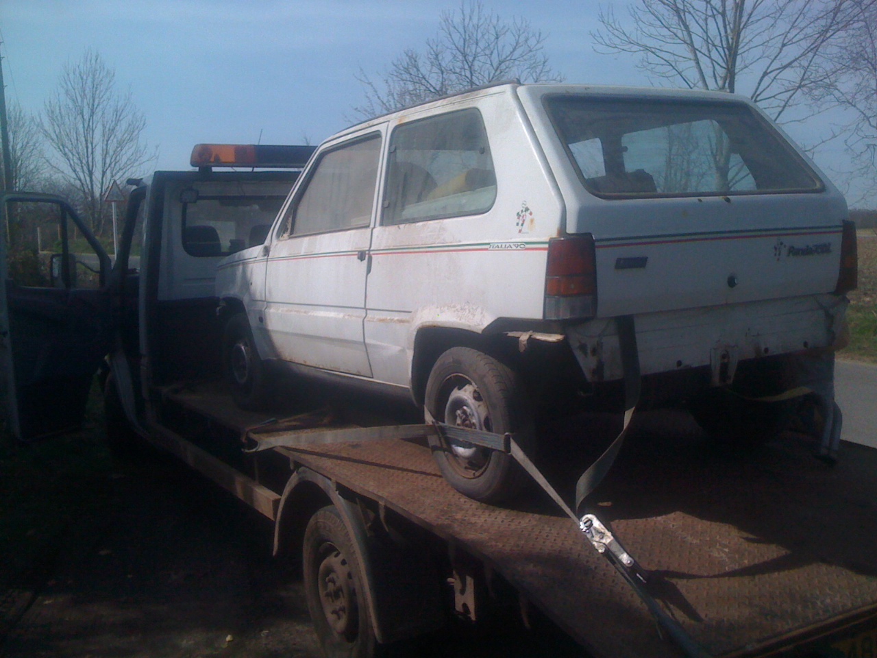

Here's a pic of it on the truck going to its new home. Its going to have a wash today. Unfortunately someone smashed the driver door window in and bent the door the night before we picked it up, anyone know where to get a driver window from?
Thanks

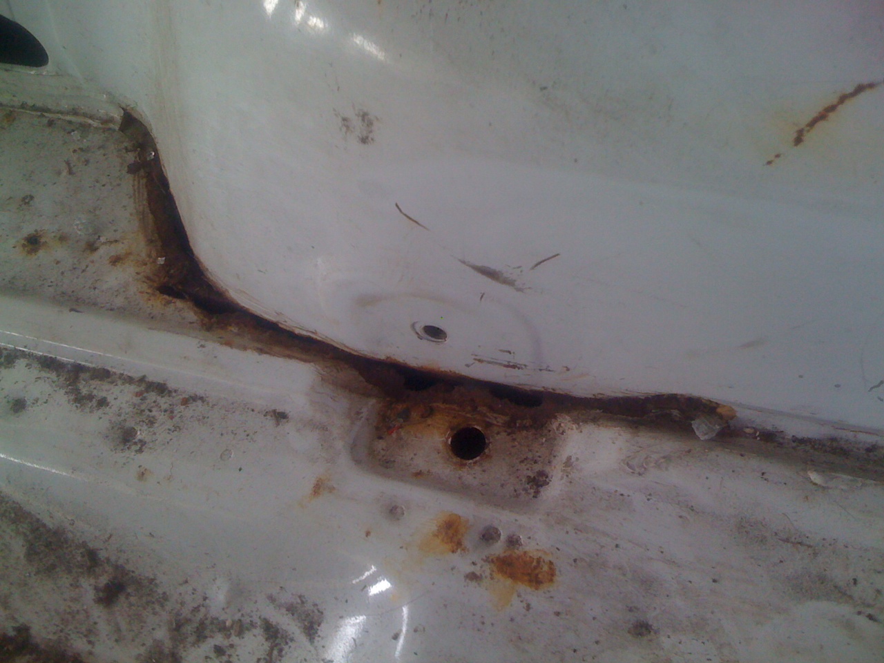

Found some rust on the inside near OS wheel arch and the seams on both arches have some small holes, also on the A-piller there are penny sized holes. Need to have a good look underneath tomorrow.

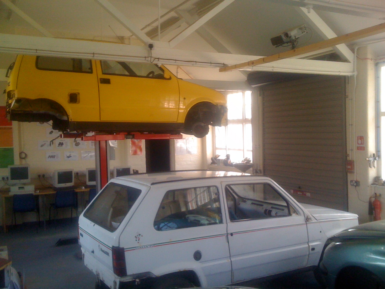

Heres a couple of pics, one of the car in the workshop next to my cinq (more work in progress) and one of the rust near arch.
