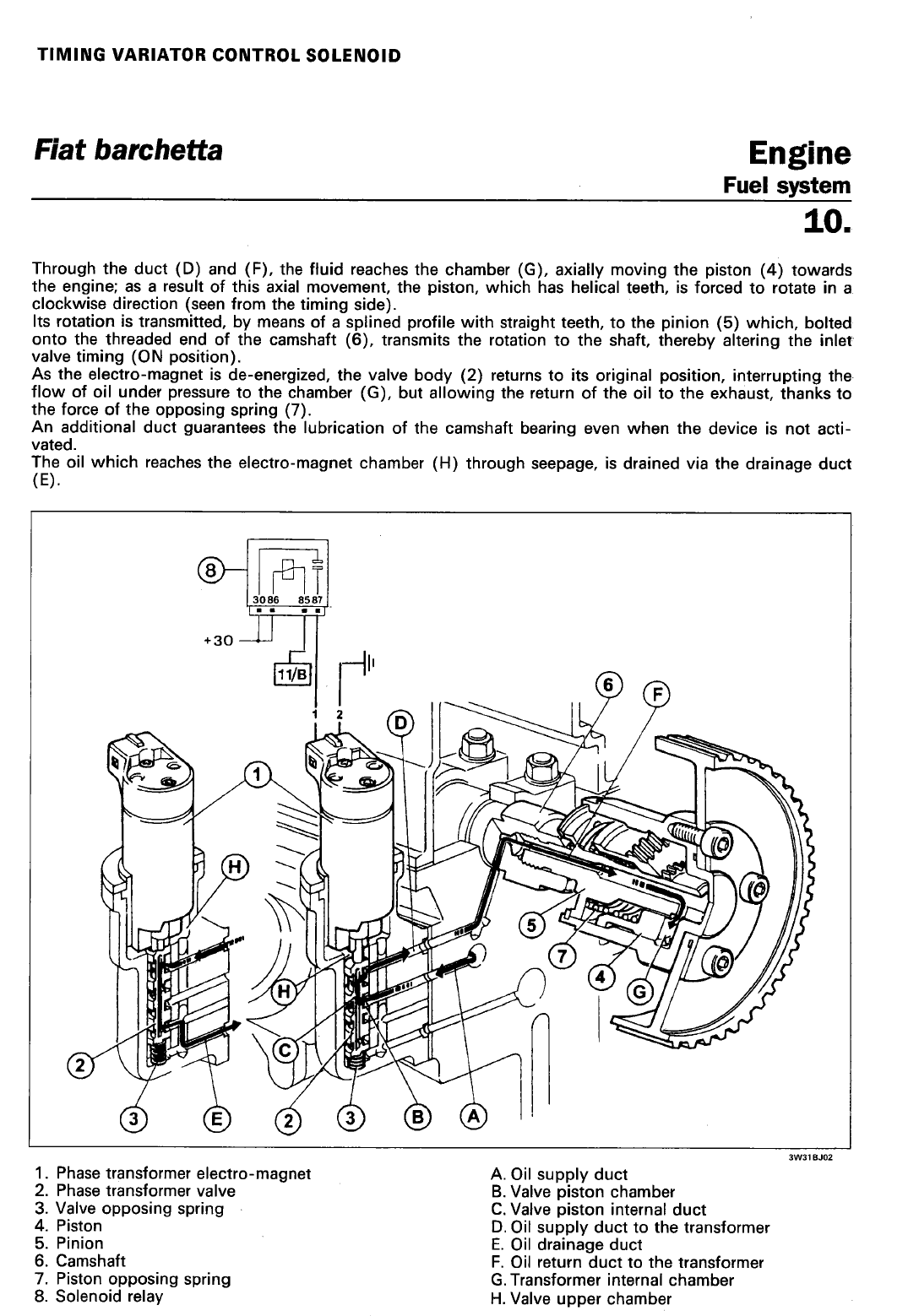

The barchetta engine can make the variator sound if it has not been used for a long time. The oil may slowly drain to the oil sump, meaning you might not get full ois pressure instantly, especially if the car starts right away, without the need to turn the starter for long.
If it is the variator sound, just see if you hear it regularly or just every once in a while. Try topping up the oil to the max level or even just slightly above. Tappety sound can also come from the lifters, if they do not get enough oil.
If this doesn't help, try changing the oil.
Also, if you start to have constant problems with the variator, the problem may also be with the control solenoid that opens and closes the variator. See the pictures of how the system works.
I wouldn't worry about it too much. It's not likely that a variator with 5k on the clock would fail. And since it it recently replaced, it's most likely the new, revised type with brass gear instead of the old, nylon gear type that is prone to fail.
