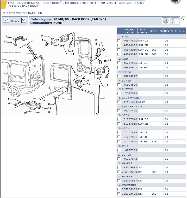

Is there a website with diagrams & part numbers for fiat doblo???
I need part of the rear door opening mechanism, where can i find the part name or number, or better still a diagram???
You might go to a dealer and ask to see the parts book, of Halfords. Find the door pages and note down the numbers. There are two systems by the way; it was modified with the makeover a couple of years ago.
Here's 1 version, but you don't say which version or year yours is.
Dave.

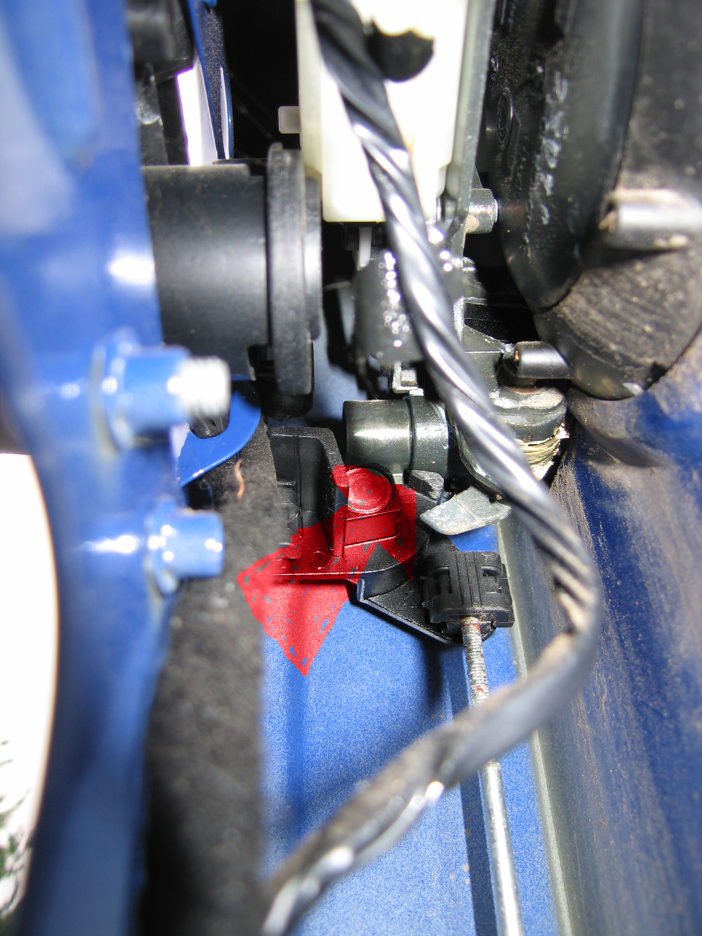

Hi
I have a fiat doblo sx jtd with two back doors.Problem is the door on the left unlocks but does not open,i have removed door panel and see there is a broken catch see picture .question how much of this lock will i have to buy
many thanks from burt

Sorry damaged part not high lighted see new picture

On my vans I've just had to tighten up the hex drive screw in the middle of that part.
I would take the whole thing in, then it's their fault if they order the wrong part.
