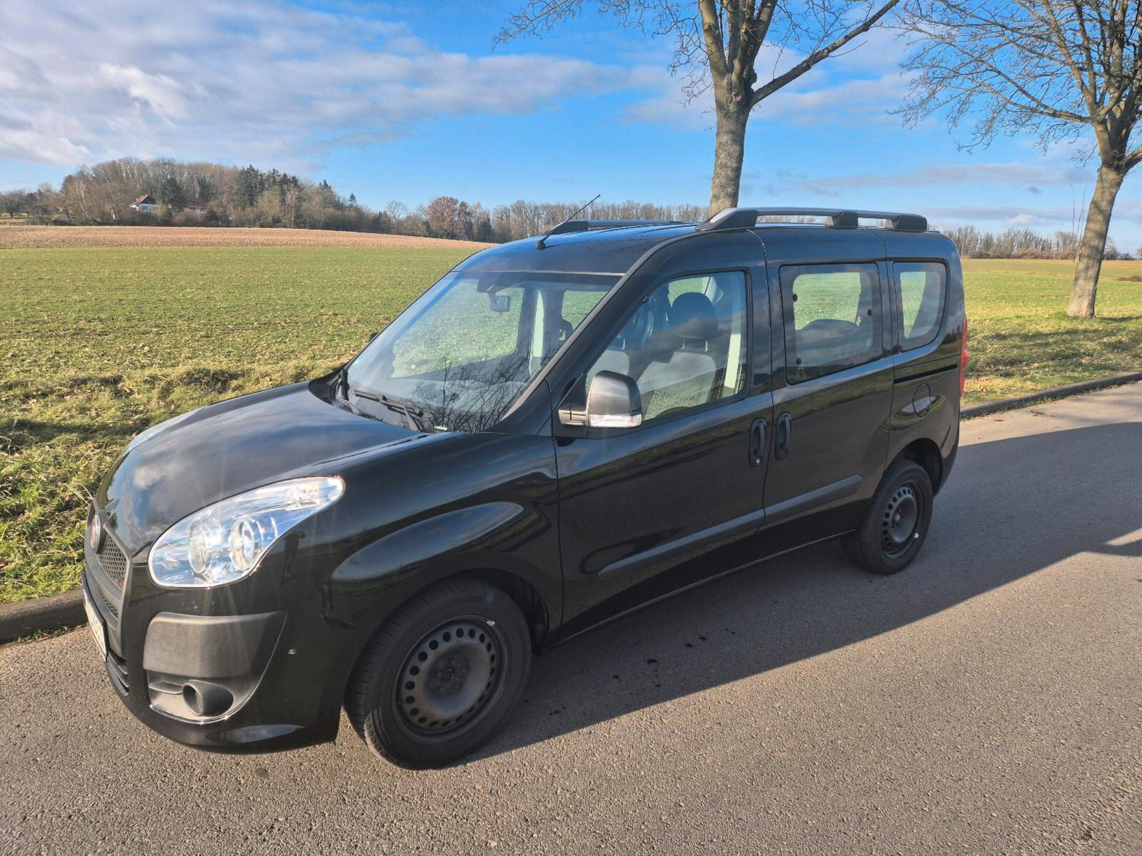

Hi,
I‘m new in the group - I want to buy a Doblo from end of 2011 with 1.6 Diesel engine with 90 hp - the owner has had the car at the workshop - it has a new Turbo and some related sensors, but it runs only 90 km/h - the error code says the Diesel particle filter is blocked - the engine runs smooth but will not arrive the max. speed - what do you think? It has run 177000 km - if I could fix it it would be a bargain. Thanks for your support.
Best regards, Stefan

Hi, and thanks for your reply and the advice - the owner has changed the Turbo allready and all related sensors - the Doblo hasn‘t been abused, it wouldn‘t be in this well-kept condition - I just asked the owner about black exhaust fumes and about the oil level - and I ask for service history, because he announced that the Doblo is fully serviced - the offer is 2700€ - Doblo is from October 2011, 1,6 with 95 hp, 177000 km
Thanks again
