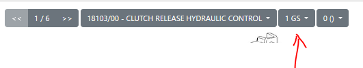

Having problems with ePER guide showing two different part numbers for the same clutch hose.I have a 2006 doblo cargo 1.3 multijet 16 v. How can i decide which part number is correct ? The ePER guide asks to find part by code ,what code does this relate to ? Any help will be appreciated as this is the first time using this search

GD stands for guida destra, GS for guida sinistra in Italian. Sometimes it's also marked as GDX / GSX.
It means the side of the car on which the steering wheel is. So, GD is for cars with the steering wheel on the right hand side (left hand side traffic), and GS for steering wheel on the left hand side of the car (right hand side traffic).
That makes things so much clearer . Thanks very much for your help . This shows what a great site this is . Again Cheers
